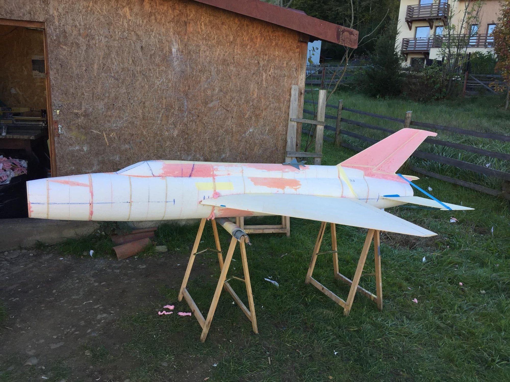

Are wings scalesize because to my eye they look a bit too large? or is it my eyes..
I will reverify, it seems to me too😊
Old 10-04-2018, 06:02 AM
  #28
Mugu
Join Date: Sep 2013
Posts: 631
normaly have to be ok becouse i did to scale ,the fuselage is not complete,i have to add in back and the cone in nouse.

Work on MIG s😃

I have just advanced a little bit today with MIG 21 😎🍻🍻

Work in progress MIG 21

Litle work today!

Very nice MUGU! Which filler is that pink filler?
Reuben
Old 10-21-2018, 01:33 AM
  #46
Mugu
Join Date: Sep 2013
Posts: 631
Reuben
thank you! the pink filler is normal poliuretan foam,is very easy to work with this!

I start with the fiberglass on the fuselage and small work on tires master!
