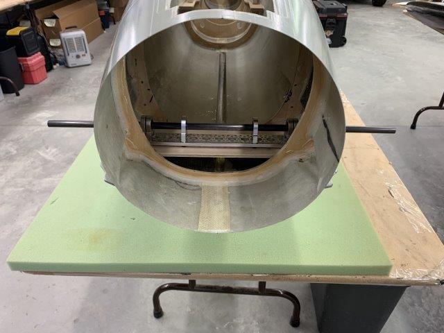

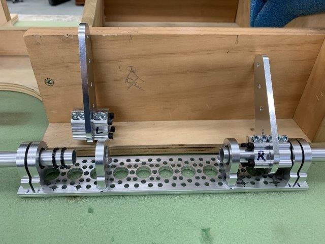

Started working on stab system today.
Step one was to get these parts working. At first anytime I would tighten the bearing block bolts it would bind the shaft. It would rotate freely in the ball bearings but would be impossible to remove. Apparently there were some tight tolerances and anytime the bolts were tightened it would induce a binding angle in the parts. After about two hours of fussing with it I slightly enlarged the bolt holes in the plate and shimmed up the inside blocks and got it working good. Now you can slide the tubes in and out easily. There are two nylon spacers between the clamp hubs and the 2nd bearing block to ensure they do not rub.
Step two was to see if the pipe had clearance from the bearing blocks. I taped the stab system parts to the plywood tray and mounted the pipe. It had clearance but just barely. I had to remove one of the clamp hubs in my first design to get the inside bearing block to move away from the pipe enough to provide clearance. The only function of that hub was to stop the tube from moving farther toward the center. Now that function will have to be the root of the stab against the nylon spacer on the outside of the fuse. Not enough room to fit the clamp hub inside plus it saved a little weight.

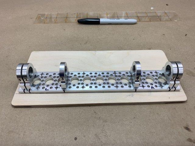

Locating the stab plate.
Locating the stab plate on the tray was difficult because the socket bolt heads stuck out of the bottom of the plate and it was impossible to insert the 1/2" aluminum tubes through the fuse holes and bearing blocks to get an accurate location. The solution turned out easy after I figured out the way. I inserted a smaller diameter 10 mm carbon tube through the fuses holes and into the bearings. This centered the bearings on the tube and allowed the edges of the plate to be marked.
The edges of the plate were traced while the carbon tube held everything on center.
Location lines on tray
Bolt head relief hole centers marked with plate taped in position
Bolt head relief holes drilled
The bolt head relief holes allowed the bearing plate to sit flat on the tray. The oversize holes allow the plate to shift slightly so that the plate mounting holes can be accurately marked once in position.

Mounting stab plate
With stab plate sitting loosely in the bolt head relief holes it was installed with the 1/2" aluminum tubes. The tubes held the plate in position and allowed an accurate marking of the plate mounting holes.
Plate mounting holes and some lightening holes to match the plate drilled. 6-32 blind nuts installed in mounting holes
Stab plate bolted to the plywood tray
Stab tray installed and tubes and control horns installed
It actually worked pretty well.
I will have to cut the control horns shorter after I do calculations to determine the needed length.

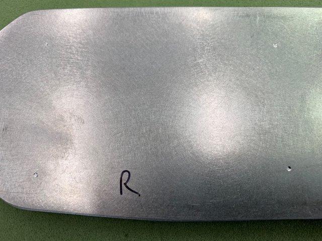

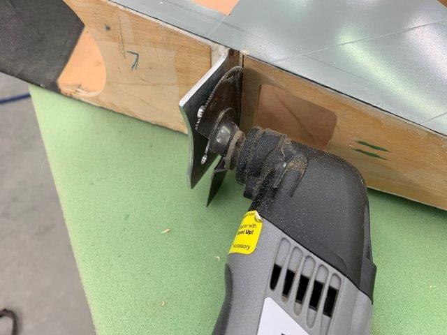

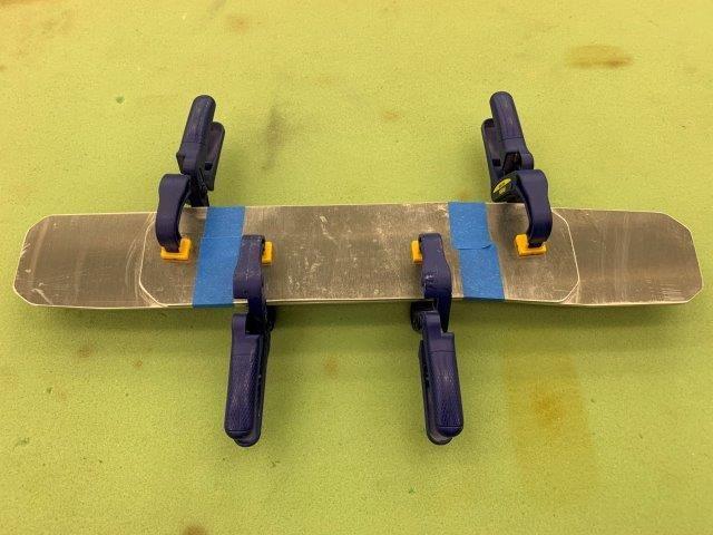

I cut spar plates and opened up wing former for more air to turbine.
AL 7075 1/8" spar plates arrived, pattern shown below
Cutting plates to shape turned out to be fairly easy. I used a 17 TPI metal blade on slow speed with some bees wax. Slow feed rate but pretty easy overall.
Plates cut to shape
Plates glued together with hysol
Dremel saw used to make cuts in 1/2" ply wing former. The total area of hole was scientifically calculated by using straight lines to connect the bottom hole and a paint can to trace the upper hole!
Straight plunge cuts used on upper hole
Dremel permagrit grinder and drum sander used to finish the shape of the upper hole.

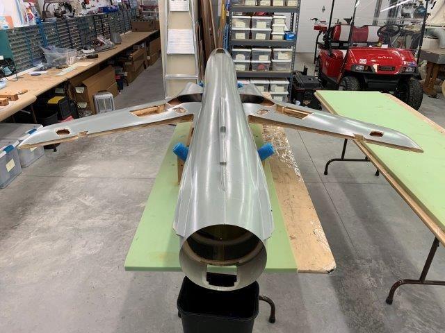

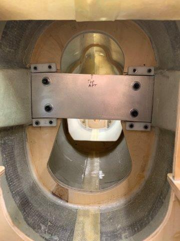

Mounting the spar on fuse former
Spar center holes drilled, smoothed edges, ready to mount
Spar across wing former with new air holes opened up. Should be plenty of air to turbine. I may try to make a smooth aero shape in front of spar to smooth airflow over and under the spar
Spar extends out into each wing now
Double thickness extends only to first bolts in the wing gear well to save weight
Same on right side
Root rib spar slots widened to accept spar doubler
Wings test mounted onto fuse with new spar. This mod solved my biggest fear, of breaking off a a wing in normal flight with nothing but plywood holding the wings on. Many thanks to everyone who helped with ideas and recommendations
Gary

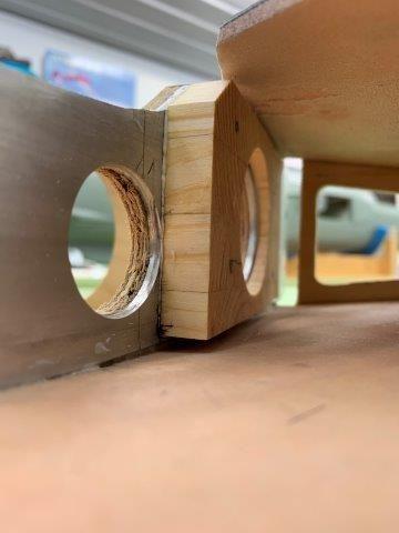

Happy snap of jet upside down with wings on.
There is a 1/2" gap between the new spar and the existing spar in the wing
Side view of gap. I fabricated a hard wood wedge to fill the gap and allow the spars to be securely bolted together.
4 pieces of 1 x 6 pine laminated together with 30 min epoxy to make wedges with end grain to hold spar bolt pressure. The big block was for me to hold on to while cutting on table saw with 3" depth of cut.
The laminated block was squared up on table saw and the wedges cut from one end for an end grain wedge
Rough cut wedge ready for dry fitting
Right side shaped and cut
Left wedge shaped and cut ready for insrall

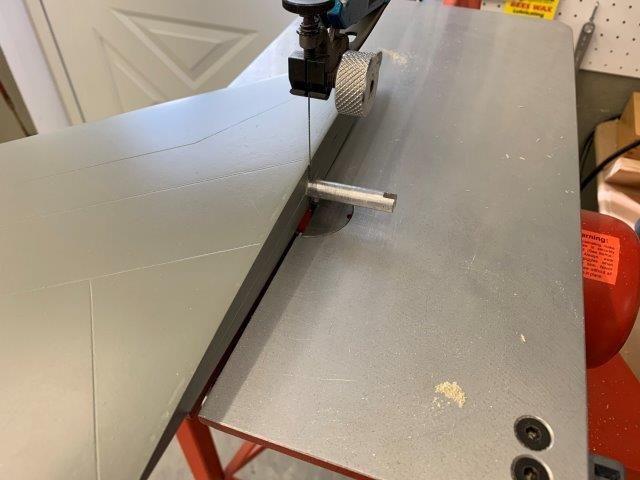

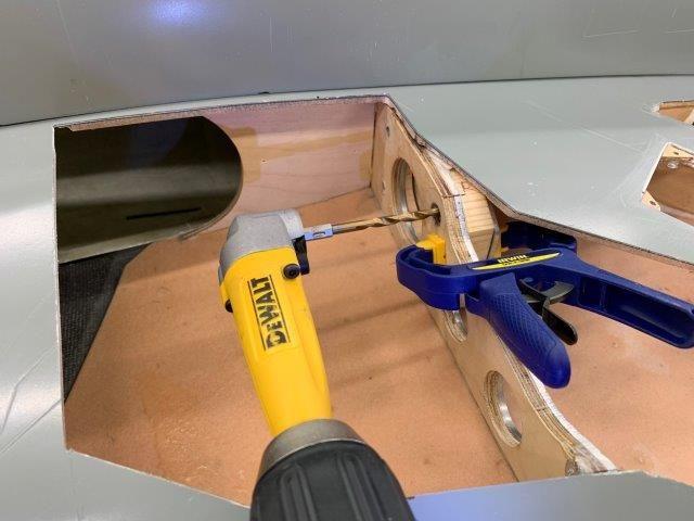

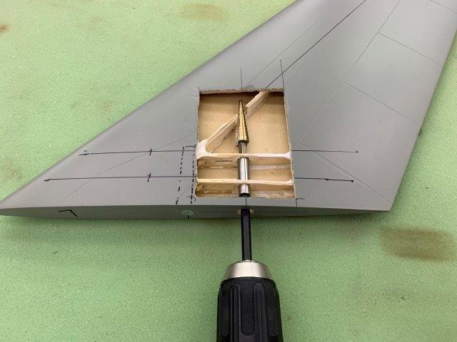

The stab pivot tubes from McMaster Carr arrived to day so I started working on stabs while waiting for wing wedges to cure.
Step one was to cut off the existing stab pivot rod.
Well we're committed now to a new stab pivot tube!

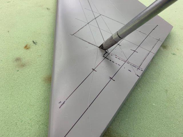

Next was to mark and drill the new hole for the stab pivot tube. I marked the circle and then used a step drill making sure the hole was centered in the process.
Next I marked a cut out on the bottom of the stab. The ribs and spar lines were marked earlier my my friend who put them through an Xray machine last year.
A large Xacto blade was used to make the cuts through the fiberglass and airex layers
I had hoped to save the cutout but it was impossible to remove without destroying it. Here is the opening after being cleaned up a bit with a dremel and permagrit tool. I was very pleased to find nothing complicated inside which should make installing the new tube pretty simple. The opening will probably get covered with thick balsa and sanded to shape and glassed.
The step drill has a hex drive and was attached to an extension which made drilling all the way in very easy.
The new stab tube dry fit in place. Overall I'm relieved after opening the stab that there are no surprises and it should be fairly easy to make the modification.
