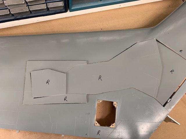

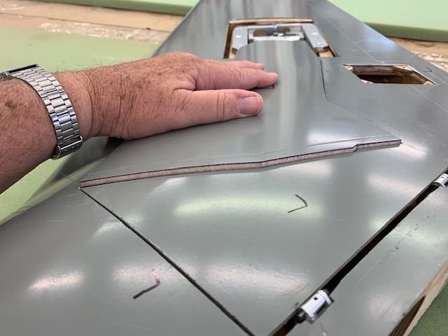

Main landing gear middle and outer doors
The gear doors before cutting middle door from outside door
Doors cut apart on scroll saw. Used a couple of blades cutting through the glass and carbon fiber layers
Right side done
Left side done
Looking and pondering how to do the doors. Looks like they may actually fit flush with some of the foam backing removed in the right places
If material removed on back of door it should fit flush here also
Ditto
Trying to figure a way to attach door so it is removeable and not drilling into the strut. Thinking about making two sheet metal brackets that would clamp the door to the strut with bolts and nuts. The brackets have to leave room for the chute RPM sensor and magnets also.
The door has to rotate with the lower strut when it is retracted and extended. It also has to be mounted on the strut so it is flush with the surface when retracted. So I will have to figure out hot to set the proper gap which is not the same on either edge or end. Not sure how now, but thinking waxing the strut and then making a bed of epoxy putty and pressing the door on to the strut till it is flush and let it cure. Then remove the door from the strut and clean up the squeeze out to make a custom door mount for each side. Any ideas or suggestions appreciated.
What is clear is that each door will have to be custom fit. No fast way to do it.
This will wrap up work this week. Spent most of the day packing the camper to go to Super Jets South in Georgia. Leaving tomorrow and back next week hopefully.
Gary

The problem with the gear is that it is not designed to correctly rotate when retracting or extending. If you set the proper ground alignment, the alignment is incorrect inside the wheel well. The strut and tire stick through the gear door if the gear door is flush with the wing skin. Since I have no ability to redesign and and fabricate new gear parts, I elected to fix the problem by cutting the gear doors to fit. This will require a small bump on the outside of the gear doors when finished but it is not as bad as I thought it would be at first. So in the spirit of "Git er done"...let the grinding begin...
First step was to remove the wheels to fit the gear doors to each strut and flush with the wing skin
Doors taped in place for marking strut locations
A sort pencil used to mark the position of the struts on the inside of the doors
Doors marked
First guess of where to start removing material. As it turned out I had to cut it all out.
Perma grit wheel used to remove material on inside of gear doors
An led light inside the gear well help see where the strut was touching the door keeping it up from the wing skin
Final cut on the right side strut
Next issue was tire clearance from the doors. Initial cuts here, but eventually had to cut a whole in each side.
Tire relief cut in inner doors
Almost done but I eventually had to cut through the door skin to get tire clearance.

Setting gear doors on struts
I gave each strut a full coat of Vaseline as a release agent. Then I used a bed of hysol epoxy to set the gear doors onto the struts at the correct angle to be flush with the wing skin.
I filled in the gaps from the outside with hysol.
Once the epoxy cures I can pop the doors off the struts and start to fill and finish the inside of the doors. Once the inside of the doors are done I will glass and fill the outside of the doors leaving clearance for the tire to rotate. Then I can figure out how to attach the doors to the strut that will allow removal for maintenance.
Doors are now flush with wing skins
It won't be as bad as I first thought after the outside of the doors are filled and feathered to the edges. The worst will be the angle of the door when gear is extended as the doors will be slightly towed in in relation to the strut. Its the best I can do at this point. At least the gross tow in angle of the original gear design is now fixed.
