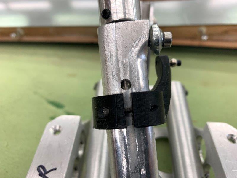

Its been 3 months since the last post. After the trip to Lake City mentioned above my friend Keith produced a 3D printed bracket and arm for the main gear strut that operates the outer door very well. Also I used 2-56 ball joints instead of 4-40. Now I have both outer doors working well and the main gear door just clears the outer door as the gear swings up and down. This was one of the most frustrating tasks so far and just getting some help from Keith solved it perfectly. Thanks Keith!
New bracket arm allows the ball joint to be nearly at the bottom of the gear well and allows the required range of motion. I could never get this to work with the wood arms I tried to make.
Bracket bolts to the strut
I need to learn how to make this stuff with a 3D printer
Main and outer doors maintain clearance as gear retracts
All closed up. Doors flush on trailing edge
Nice close fit here.
Only problem is the gap on the leading edge of the main door. I'm going to ignore this for now and deal with it later after I find out how much lower i will hang when the weight of the strut and wheel are pulling it down.

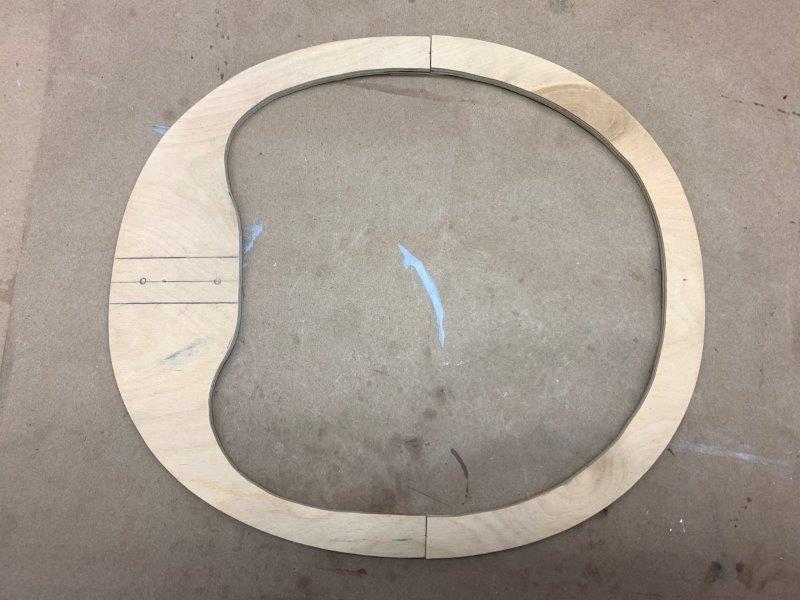

A year ago I discovered that the fin former would not fit in the fuse with the pipe mount and stab mount formers in place so I had to cut it in half to get it in.
Scab patch tabs fabricated to align the bottom and top half of the former
Tabs glued to top half on each side
Dry fit of bottom half of former
Top part of former aligned in position by clamping to the vertical fin aluminum spar
Top half tack glued in place with medium CA
Bottom half clamped to alignment tabs and tack glued in with medium CA
Edges sanded smooth at joints. Ready for epoxy to fuse.
Vertical fin in place aligned with the former. The vertical alignment will be set with a laser level for final assembly. Finally something simple that worked!

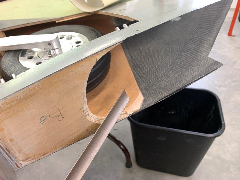

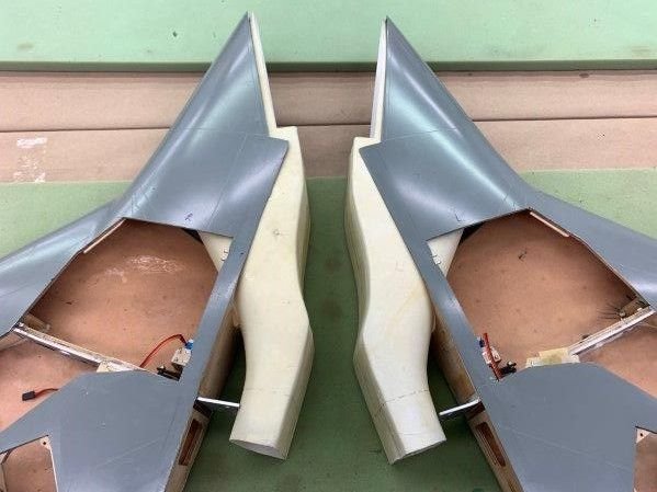

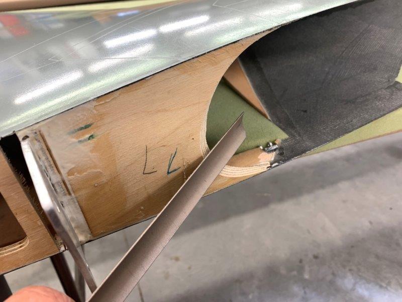

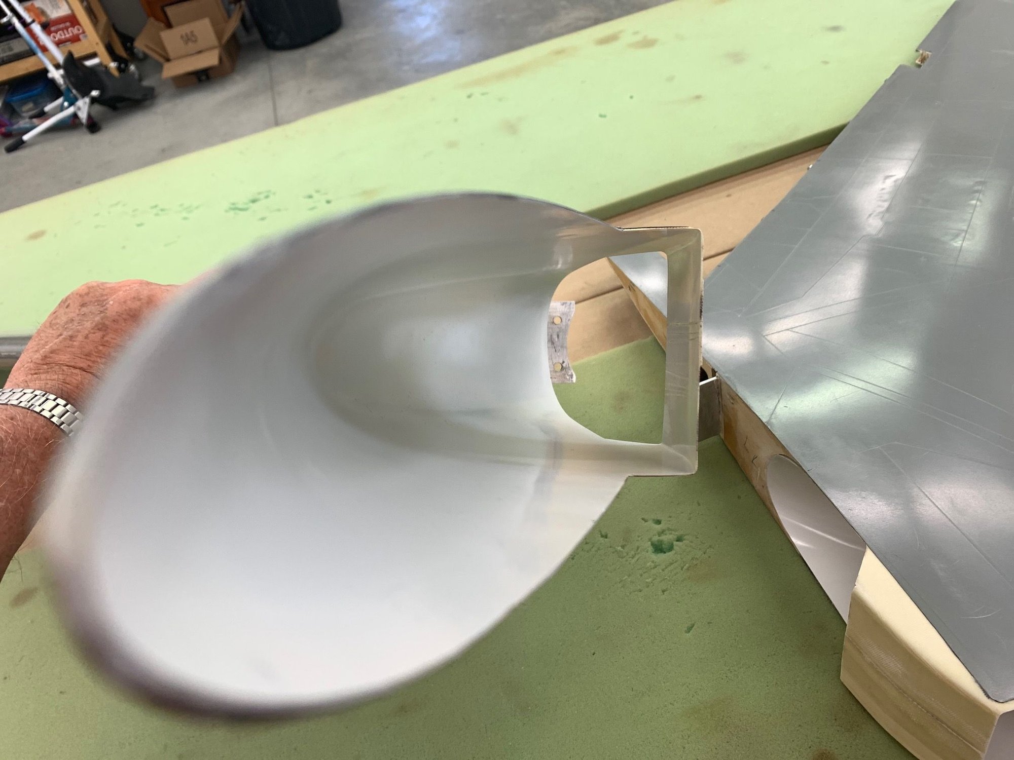

Fitting wing air intakes.
Intakes were designed to extend deep inside fuse to a single duct that fed the air directly to the turbine. Since my wing spar now blocks this duct I will cut the wing intakes short just to funnel air into the fuse. The turbine will suck it up from there.
First task is to cut the intakes shorter to clear the wing spar and seat into the root rib
Cutting on down draft table
Rough cuts done
1/4" ply root rib opening shaped ot accept the intake a the proper angle.
Perma grit dremel drum grinder and perma grit convex curve sanding tool really helped make cutting the angle on the 1/4" ply easier

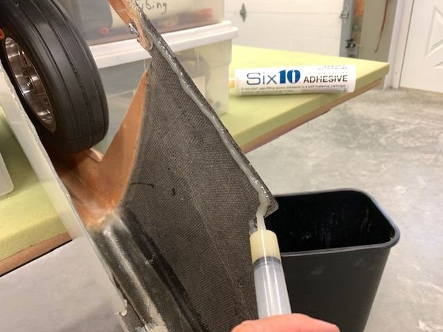

Thanks guys. I'm getting motivated again to get this thing done.
Glued in the intakes to the wings today. Used Six10 epoxy.
After dry fitting I applied epoxy with syringe to the edge of the wing root intakes.
I set the wings on the leading edge so as not to distort the shape of the intake during the gluing process. When laying on the top or bottom the intake slightly flattens from the weight. Then applied the epoxy to the edges.
Intakes were taped and clamped on. Magnets worked as perfect clamps on the edges.
Other side done.
Waiting for epoxy cure.

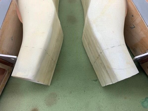

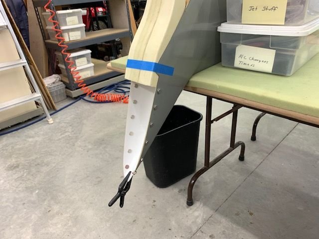

Wing intakes trimmed and cut to clear fuel tank
Cut lines marked. Intakes were made to funnel air to a center tube but my new wing spar prevents that so I will cut them short. The trick is to make them narrow enough to not take up fuel tank space.
Dremel disc used to make rough cuts
Cut at leading edge of intake made slightly over size to fit into fuse gap.
Cut off removed
Aft cut made to shorten and reduce width into the fuel tank area
Flush cut saw used to make final cut
Done
Edges cleaned up and sanded
Front view
Right side
If I were a air molecule I could get thru here!

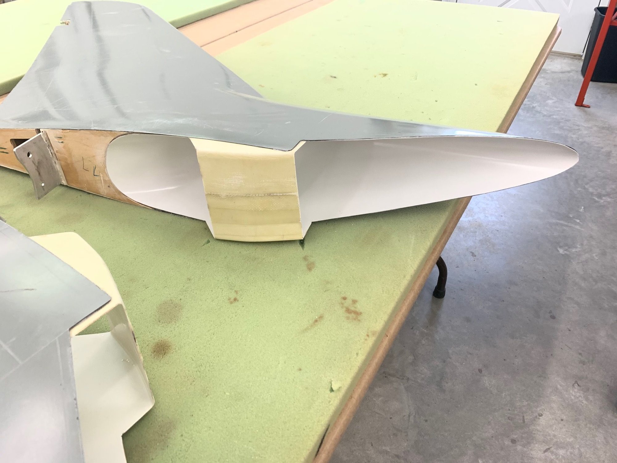

Fitting wing intakes to fuse and fuel tank planning
Took some sanding intakes to get them to fit the fuse wing openings
Top right side has about 5mm gap that has to be filled
Left side about 3mm gap
Fuse opening marked and trimmed to fit wing opening
Same on the other side.
Dremel perma grit grinder used to trim intake holes

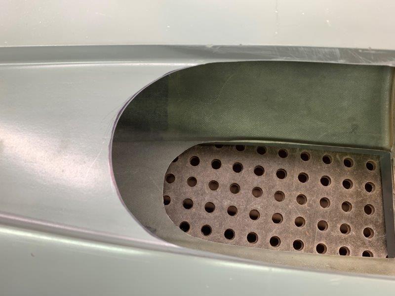

Both sides done
I was frustrated to see for some reason the left intake got set on an angle that I did not see before now. So now it is a little off and there is nothing I can do about it. The fix is to get over it. I think the air molecules will find their way to the turbine and it wont be seen from the outside.

I freehanded a curved cut with a dremel router bit.
Smoothed cut with drum sander
Now I can get a curved bottom tank through the former.
First draft of a template for the tank profile
First draft template needs some adjustments but its just to visualize the front shape of the planned tank. The top bump could be higher inside the fuse but it would not go through the cockpit opening. Maybe I could use a bottom and top tank and feed in series to get more volume. Still thinking...
