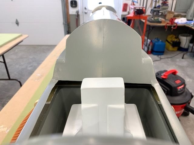

Refit cockpit hatch to fuse
So I got the tub installed to the canopy hatch and was feeling cocky about how it worked out and then I tried some thing really dumb and stupid. I said "lets see how this looks!" Well, as usual, it didn't fit! AARRGGHHH!!!
Big gap here...
Turned out the tub is hitting the front lip of the fuse opening
Some measuring, marking, grinding, and sanding and the opening was trimmed out to fit
Fresh cut opening with dust blown out
Canopy hatch fits good now!
Tub inside hatch
ABS cockpit looks a little small but I'm not building an F-105 cockpit now.
Wait a minute! It'd tilted to the right. What gives... I took everything out and measured the tub and it is square, 3" deep. I don't know. If you build a cockpit that leans to the left it will look ok from the outside. It just goes along with the left wing being thinner than the right....
If you build a cockpit that leans to the left it will look ok from the outside. It just goes along with the left wing being thinner than the right.... It will be the next guys problem.

Vertical fin epoxied to fuse
This is the very last major build step. I held it off to the very end to avoid having to fight the big fin as I moved, rolled, and lifted the fuse during the build process. 8-32 washers and nylon safety nuts were fitted to the studs sticking out of the bottom of the fin. The holes in the aluminum spar were drilled out for 8-32 bolts.
1/8" plywood plates epoxied to inside top of the fuse to accept the 8-32 stud bolts
Stud bolt plates drilled. The fin outline was scuff sanded after the photo was taken.
The fuse was set in the cradle and wings and stabs were attached to the fuse again. The flaps and ailerons were taped into neutral position.
The Laser level was turned on, aligned, and the wings were set to level. The fin was test fit and last adjustments made.
Rudder servo removed and clamp ready
Six10 epoxy laid on fuse where carbon skins of fin make contact
I ran out of SIx10 and switched to Total Boat THIXO epoxy on the bottom of the fin. The fin root rib is slightly recessed inside the fin so the epoxy was only applied on the edges where contact with fuse is made. Epoxy was applied to front of aluminum spar and to rudder former inside the fuse. THIXO has a slightly darker color and is slightly thicker than Six10.
Vertical fin placed in position and alignment verified.
The clamp was applied to keep the fin in position during cure.
Lights turned on and a visual check made from a distance to make sure the TLAR alignment matches the Laser alignment.
A "finger" fillet of epoxy laid in on both sides of the fin
Fillet smoothed in on left side
Alignment verified again and left overnight for epoxy cure
Here are the two epoxies I used. I was told THIXO was a rebranded Six10 by the vender but it is not. It is a different formula, slightly thicker and a different color. I could not tell much difference in the end results but I think Six10 is easier to work with since it is a little thinner. Both are thixotropic. THIXO is a little cheaper than Six10 and both are way cheaper than Hysol. For our use either will work but I think I prefer Six10 because of the thinner paste.
grbaker (12-08-2021)
Old 12-08-2021, 06:20 PM

Vertical fin and stabs final assembly
Wings were removed and fuse set on table for final assembly. This is why I waited till the end to attach the fin. It's huge and in the way!
Bolt holes in spar drilled through the fin former and 8-32 bolts installed.
8-32 nylon safety nuts on front side of former.
8-32 safety nuts and washers tightened down on the fin stud bolts.
Rudder servo connected and connector safety tied with waxed thread.
Drag chute jettison servo and pushrod screwed in place
Rudder servo installed and top and bottom caps installed on rudder
Both stabs installed and all the stab control arm screws tightened. The horizontal clamp screws require a modified hex wrench to fit in the tight space.
