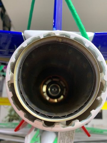

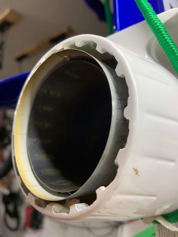

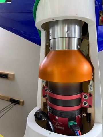

This is the way we solved the problem. Done by Freddy a partner in jets.
