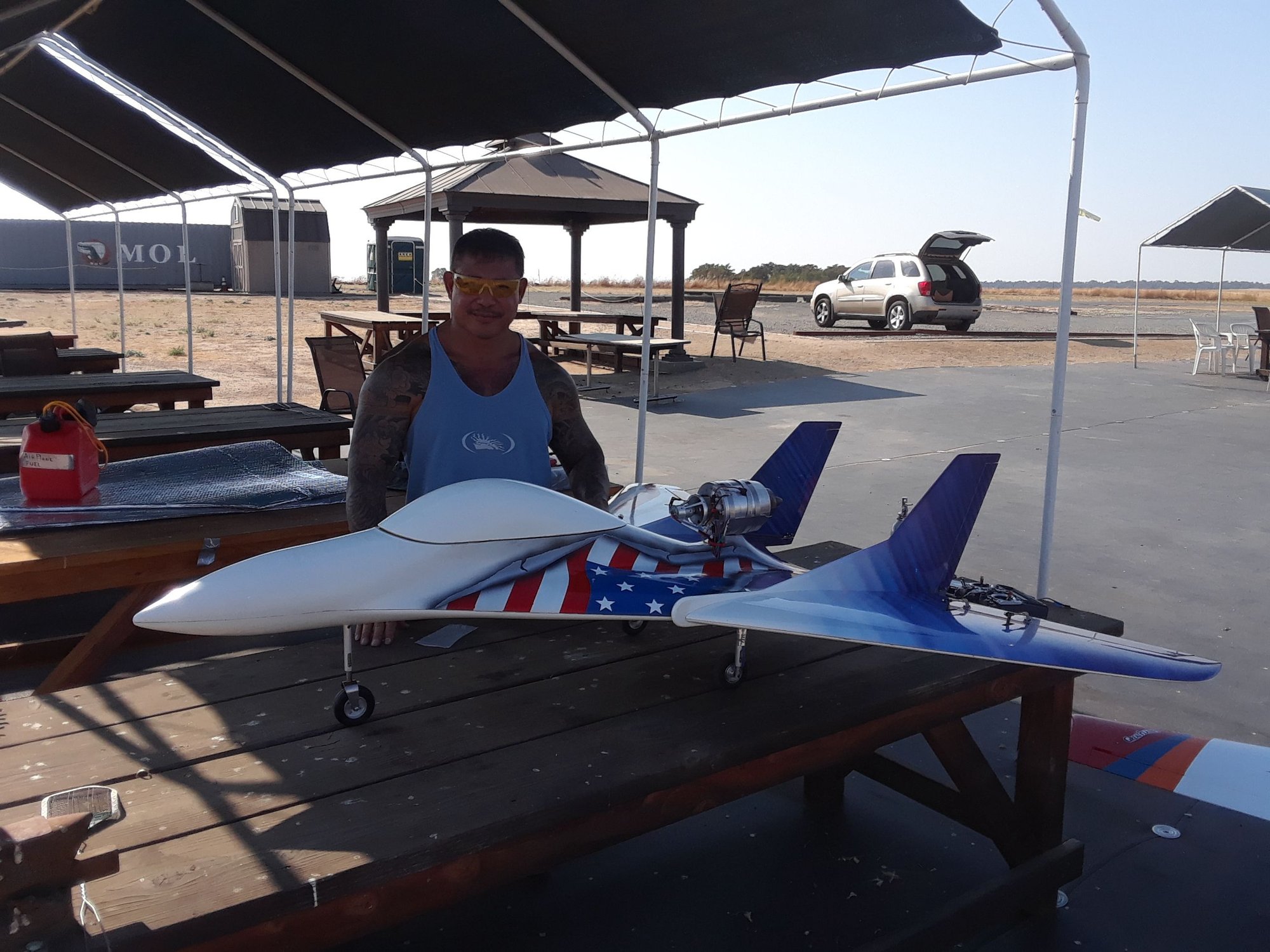

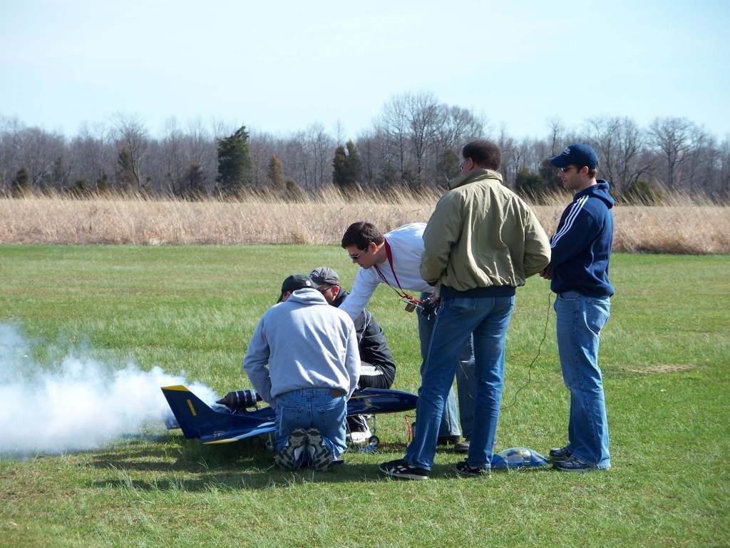

Today I was helping a club member to get his old Roo airborne again, he flew it with a 4 strk nitro engine many years ago, when he learned that I had a jet and was flying it, he then asked if we could get the Roo back in the air but this time with this Bahotech turbine that he bought at the local swap meet, that was some 4 months ago, today we met at the flying field to work out the bugs and it had a few, at the end a wire from the on/off switch broke and that was the end of the re-maiden, it didnt happened but we are very close now, may try again this Friday.

We try to get the Roo up today but, it was a no go, the previous bugs were cleared, the controls were adjusted and triple checked, the Elevons were given the reflex needed for the delta wing ( 3/16 up )
We got ready for the re maiden flight, I was ready to do it BUT, the darn engine didn't started, we try like 10 times to start it but nothing, no pop when we gave it the propane so, he went back home with it with the thought that the next time she will fly for sure, that maybe Mon or Tue.

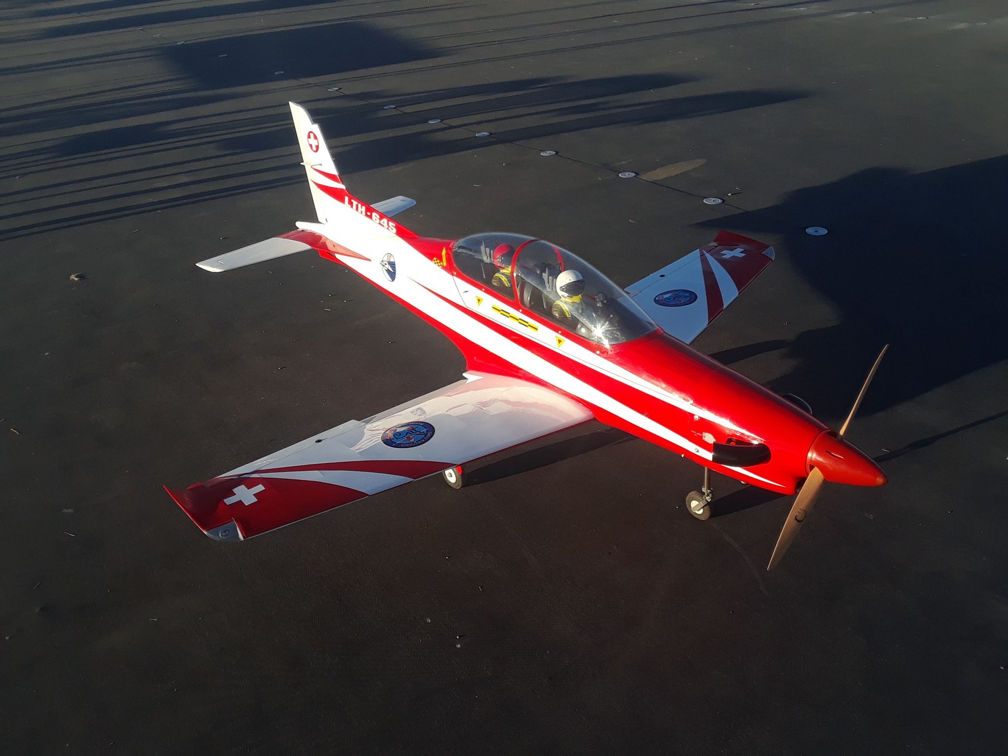

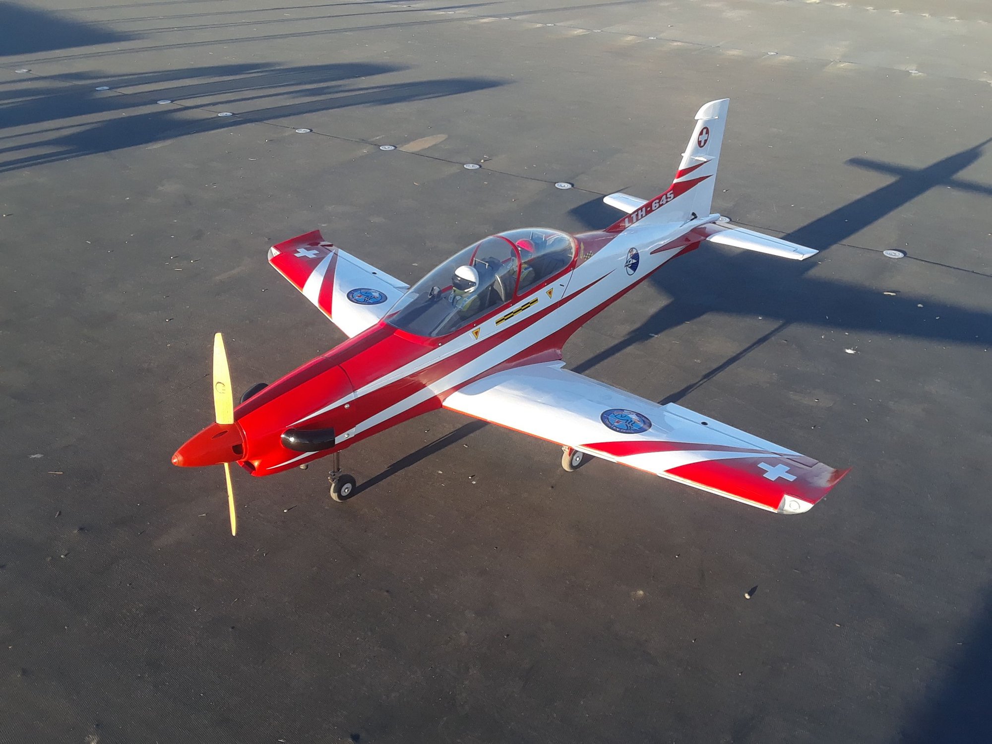

On another note, I got to maiden my Phoenix PC 21 30cc, also was having issues but was able to do one flight today, the maiden flight.
I wanted a high wing loading, tricycle, low cost ( compared to jets ) prop airplane to keep my fingers warm in between my turbine flights to stay sharp and not loose the edge like I did a few years ago, still some work to get her flying crispy but I'm confident that she will do just fine

My 20th century turbine jet troubleshooting list was this one:
1) Run out of air in the scuba tank.
2) Fried ECU caused by sparker from the mighty blue starting box.
3) Fried Receiver caused by that same [email protected]#$% sparker.
4) Ni-Cads run out of juice. (takes about 8 hours to charge them back)
5) The lubrification tank pressure line disconnected ruining the 2.000 dollars bearings.
6) Run out of propane.(somebody left the valve open, in the excitment of the NASA like complexity of the turbine start procedure)
7) Some rc friend you dont trust is in your same frequency, so is better to keep grounded that day your pride and joy jet plane.

I got a text today, the problem was found, the propane solenoid is not opening, the turbine started right away when the solenoid valve was bypassed, I advised him to add a few small drops of oil to help it get unstuck.

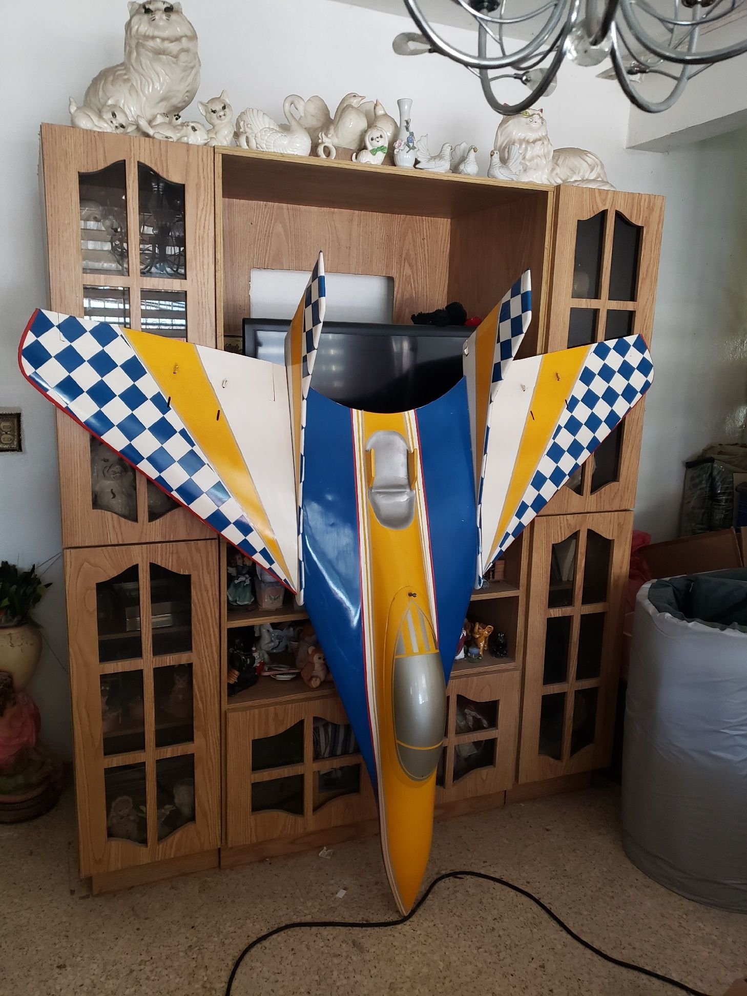

Anybody has a picture of the coke bottle fuel tank installed in the Roo or able to tell how the coke bottle is supportedin the back of the bottle in the jet?.
Old 01-09-2020, 01:38 PM
erbroens
erbroens's Avatar
Join Date: Nov 2003
Location: Curitiba, Parana, BRAZIL
Posts: 4,254
Received 5 Likes on 5 Posts
Miine has a "flower" shaped hole in the fuselage forner wich matches the pet bottle lobes and locks it. At the front there is a support wich clamps the thinner part of the bottle.
