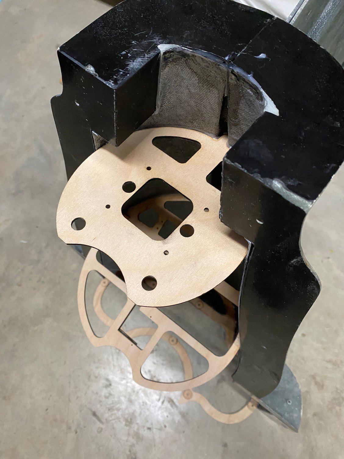

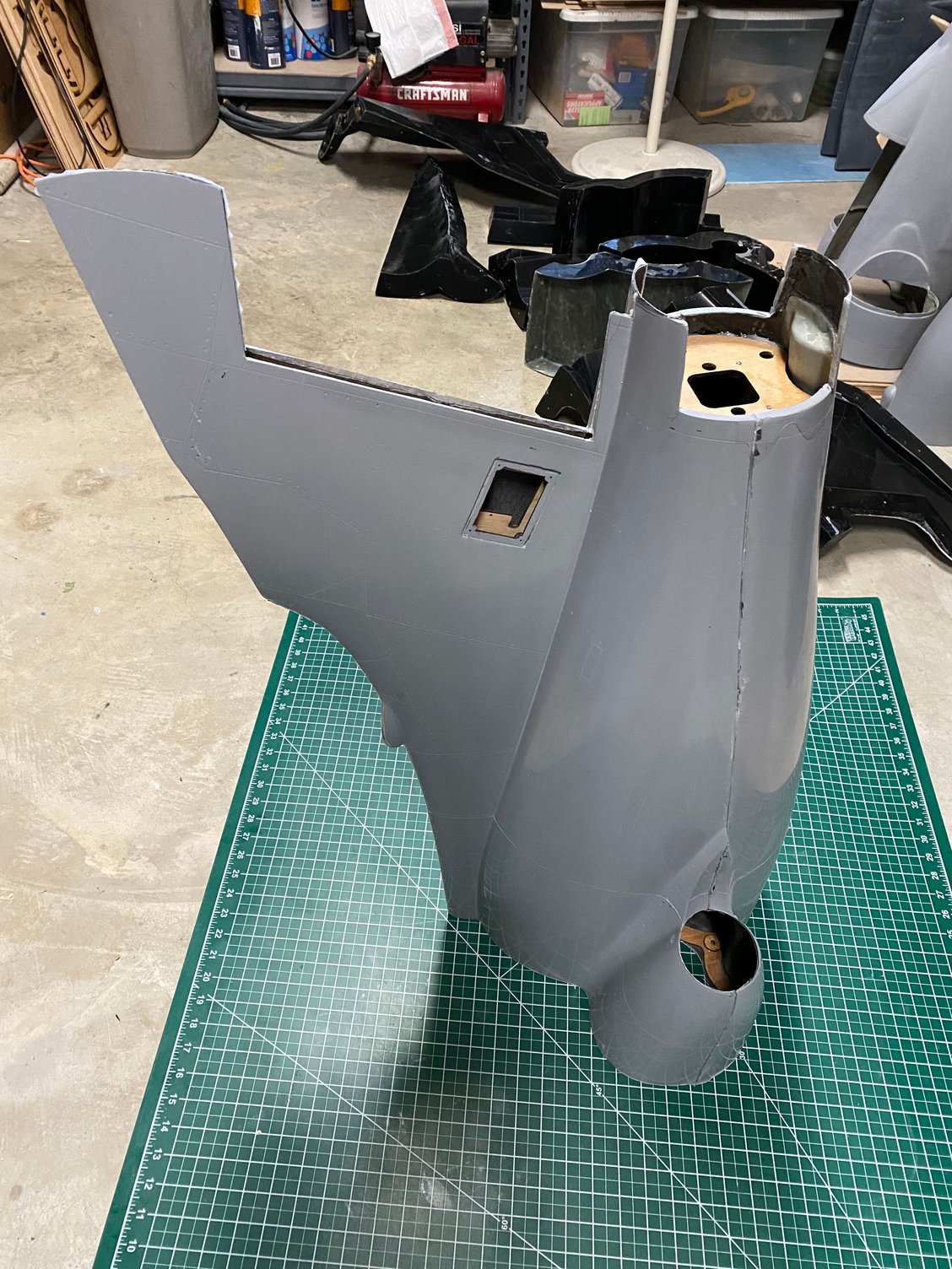

I finally finished the rear fuselage. While i was waiting for some servo arms so that I could get some measurements to allow me to finish the rear fuselage internal structure I remade the forward fuselage.
I was never happy with the first forward fuselage, and this next one came out much better. I also tried a lighter layup, veil+3oz+9oz, plus reduces some of the internal wood structure. It saved 6oz compared to the first one.
I assembled the rear fuselage in 2 stages, first bonding the internal structure and the 2 upper sides together. I then had relatively good access to tape up the seam before joining the lower surface.I made a jig to align the rear former as this is the mounting point for the speedbrake. A simple interlocking jig that aligns with the rear of the mold and it just twists 45deg to remove.
Paul

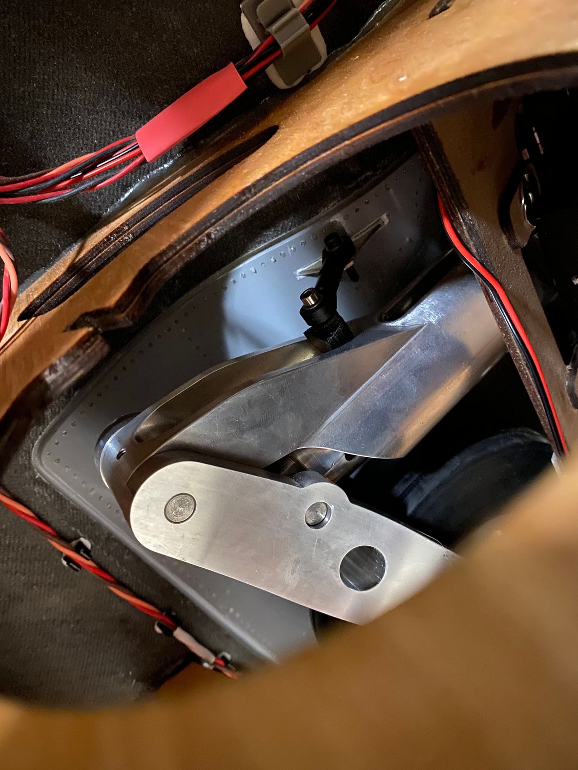

Feels like a while since the last update. Been working on various fronts, but not a whole lot of really visible progress. Here's the last months' work in an approximately chronological order.
Attaching the main gear door drive links. I laser cut the mounting brackets for the door end out of 2mm G10, along with a simple alignment tool that would set the spacing of the drive bracket relative to the hinge line. After Dremeling out the slot in the door, the drive brackets were Hysol'd in place.Once cured, a function check allowed the rigging of the drive rod to be adjusted and both door were confirmed to work well. Another triumph for the proceeding CAD work to confirm the geometry.

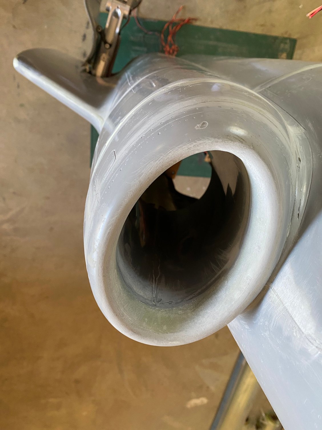

One area that I had not been happy with were the inlet ducts.Whilst the duct inner surfaces were fine, the glass came out all wrinkly when the vacuum bagging were I had tried to make the ducts in a single piece. The second pair I tried were not vacuum bagged and were around 50% heavier due to the excess resin not being removed. I also damaged the mandrels with this second pair so this was an opportunity to start again.
The second set of mandrels were made with a adequate draft angles allowing them to separate as they were taken apart. I had a different molding approach in mind, rather than using the vacuum bad, I tried wrapping the layup with Stretchlon bagging film, but that didn't work out as I couldn't get a good seal. This one (#5) also came our wrinkled, but again usable if I had to.
At this point, I decided to make more traditional inlet 1/2 molds an then join the two pieces afterwards. I 3D printed the 4 1/2 mold segments, glassed them and finished with Duratec. These pieces came out well, and I used the mandrels as an alignment fixture to join the halves together, so they were not wasted. Finally a decent pair of inlets that I bonded into the forward fuselage and blended the join with the inlets.
Those inlets were harder than they looked, but it was a valuable learning process.
