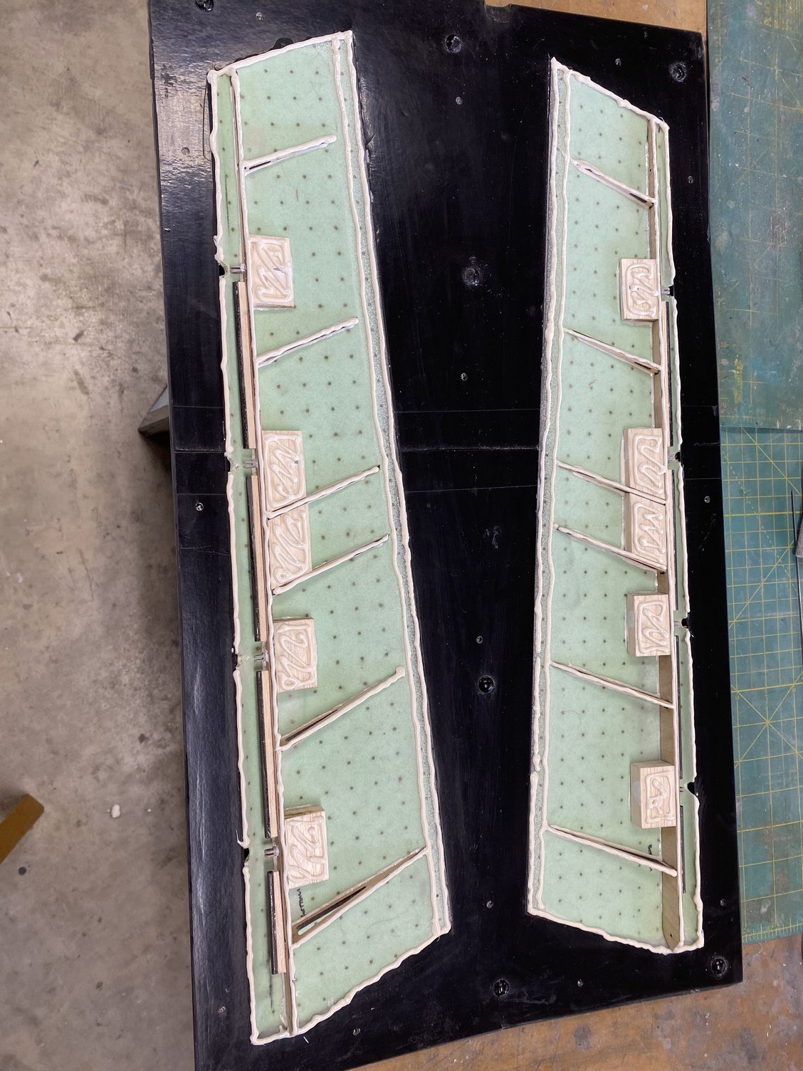

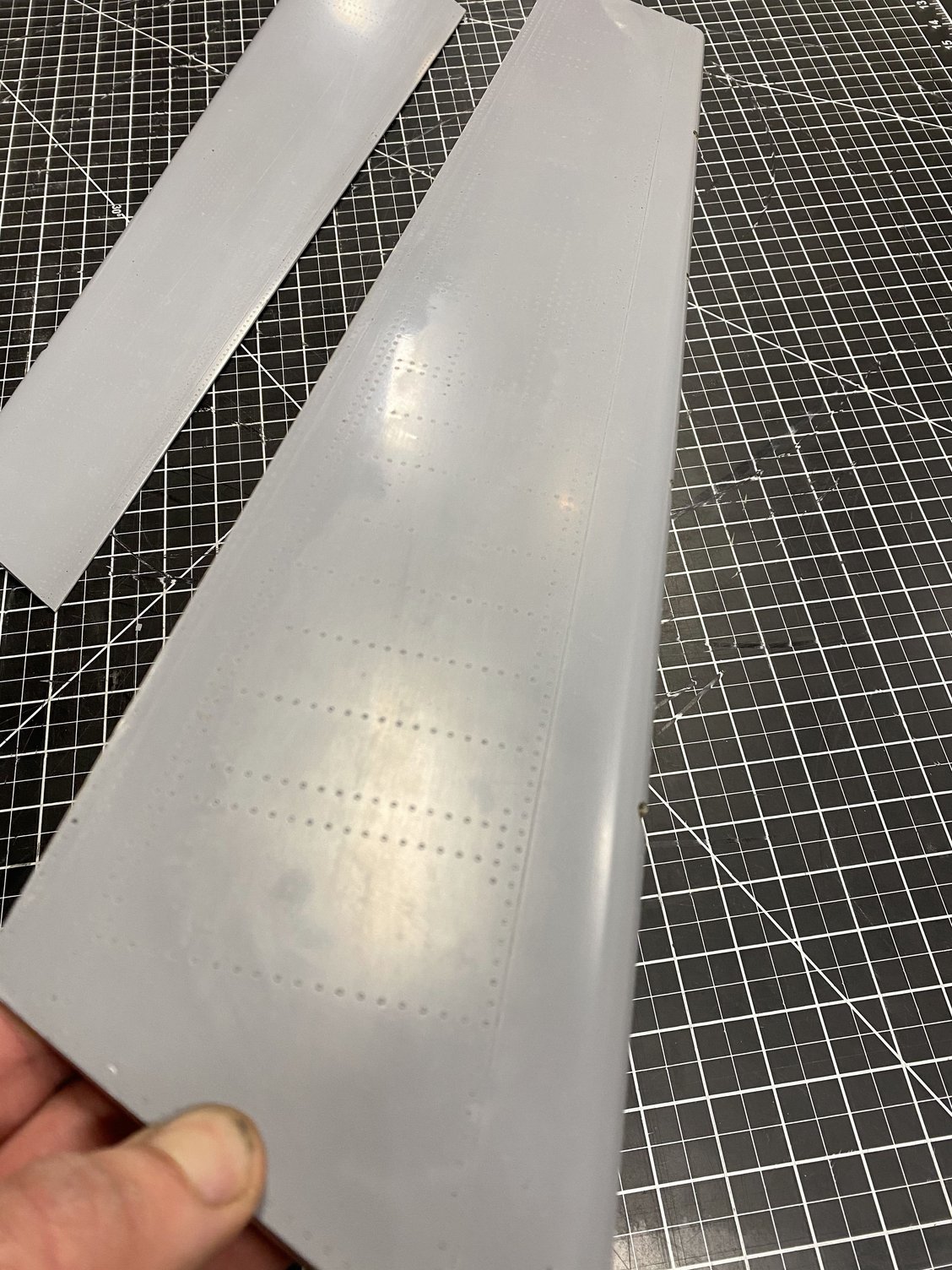

Just over a month since I lost the first version, and v2 is progressing well.
I'm working on a lot of the smaller parts first, going through each one and correcting design issues that I noted during the initial build, and others that I have spotted on a review of the CAD files. On the control surfaces, I re-positioned the spars to give the correct hinge installation location and added a hinge pin guide tube to make installation of the pin easier.
For all the Airex skins, I have reduced the glass weight down to 0.75oz, and the unsupported glass is now just 2 layers of 3oz + 1 layer of 6oz. For the highly curved inlets, I reduced that down to just 3 layers of 3oz and that saved a significant weight on each part.
Hysol 9642 is being used for all assembly bonds.
Redoing the main gear doors, I made 3 sets in an attempt to get the detail reproduced and to reduce the weight of the parts.
I have made new molds for the speedbrake drag links to ensure that they fit the cutout in the fuselage and speedbrake correctly (there was no gap allowance on the first ones), plus I have worked out how to reproduce domed headed rivets in the mold, rather than just simple flat topped cylinders.
I have also remade the aileron molds to correct the surface detail, going from raised rivets to flush rivets.
I sent off the wing joiner blade spars to be machined out of AL 7075 and they have just arrived.
Inner Flaps and Rudder skins vacuum bagged
Inner Flap internal structure
Inner Flaps internal structure
Rudder internal structure ready to close up

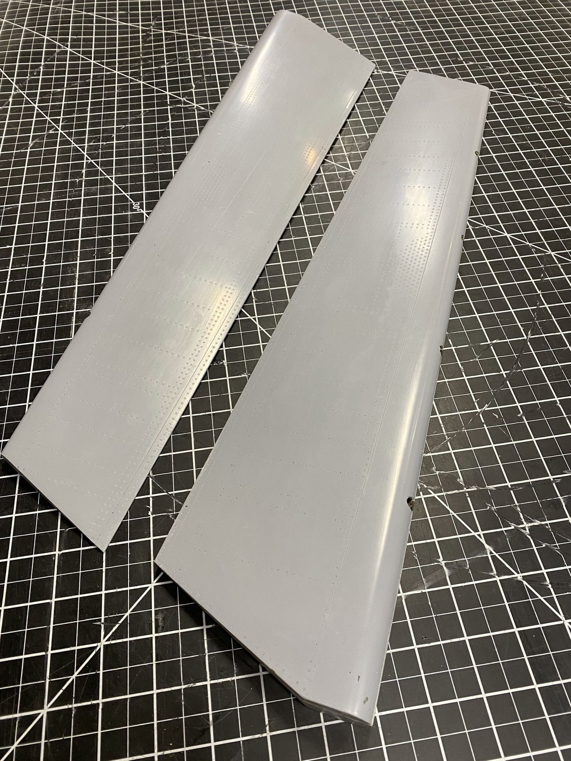

I haven’t posted much on this thread since the loss on first flight of model #1 8 months ago, but I’ve been working steadily (if slowly) on building model #2.
The build of #2 hasn’t looked a lot different that all the previous build pictures, but it is been changed significantly internally. The majority of the internal structure has been re-designed, nothing drastic, but incorporating lessons learned from the first one plus correcting design errors spotted since it was first drawn. For the tailplane and flaperons, I switched to using glass/ foam skins rather than just glass skins, so new structure had to be designed to accommodate the thicker skins.
New molds were made for the flaperons, correcting the previous raised rivets to now flush rivets.
The biggest change has been with the molding process. I spent some time plus a few trial parts trying to optimize my layup, and I finally settled on using 2x layers of 3oz + 1 layer of 6oz glass cloth for the glass parts, and not using the initial surface veil. For the center and rear fuselage sections, as these take most of the flight loads, the 6oz glass was replaced by 6oz carbon cloth, sandwiched between 3oz glass. For the foam skins, the foam was sandwiched between 2 layers of 1.5oz glass.
I picked a new trick, of using powerful magnets to hold the parts in the mold so that sit correctly while joining the various skins.
