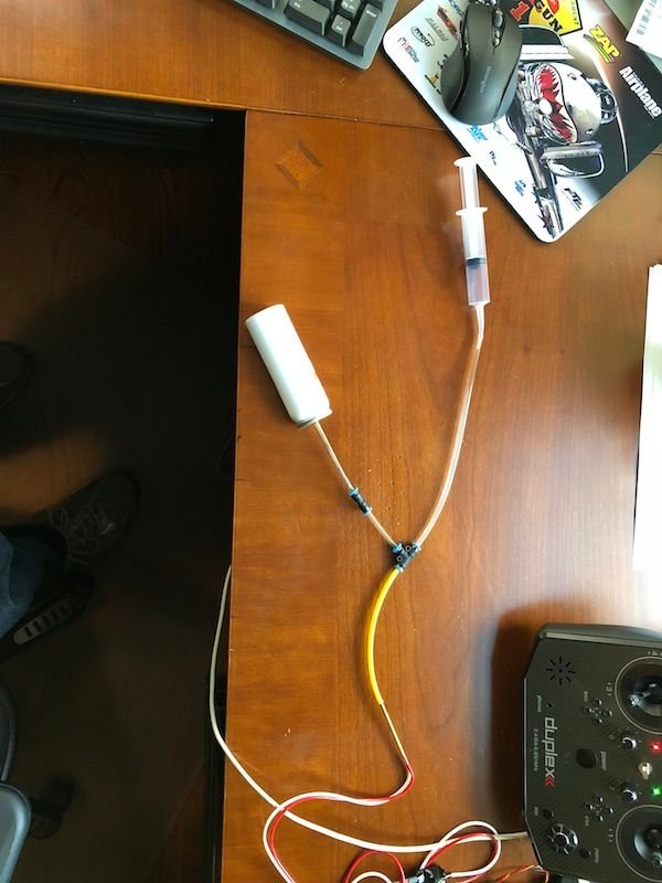

FYI, I only have a DS-24, I have no idea if the code will work properly on a previous system ... I have done a pretty careful job of testing on the Jeti emulator, the TX and I've been flying the apps all summer on my own jets ... but have not done a lot of optimization on space, speed that might be needed for the DS-16. Based on what I have read and learned, I suspect the speed and time announcers will work on on the 16 but there is no way the LSO will...
Regarding playing with the speed announcer .. as you can note in the code, if you set the speed interval to 99, it turns debug mode on. setting it to 98 turns it off. Those are both implausible values for this parameter that should be about 10. You can also just edit the code and set DEBUG = true. Then it will print the stuff it would have done via text-to-speech on the TX (the Jeti emulator seems not to support playing audio .. unless I have missed something), and it uses the P8 slider as the airspeed input. So you can get an idea of how it works. By print, I mean it will show up on the Apps console. Works on the TX but much easier on the emulator.
If you want to play with it in a more realistic way, you can connect a small syringe to the pitot tube static port .. but you have to be careful .. it senses fairly small pressures and the sensor is delicate. So you have to add a "buffer" volume so that the syringe does not make too much pressure. See the attached pic. You still have to have a light touch with the plunger!
Dave
Pitot airspeed test rig with the Jeti MSpeed sensor
