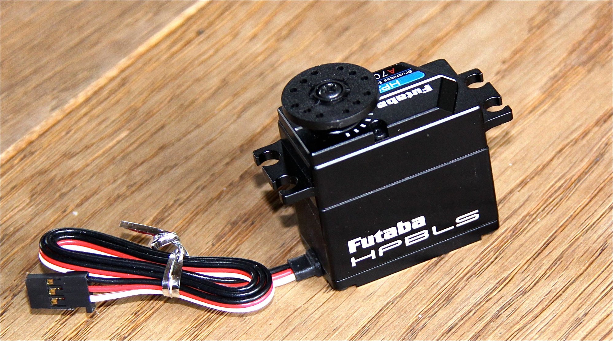

Futaba HPS-A700 Servo
https://futabausa.com/shop/servos/servos-airplane/servos-airplane-sbushv/servos-airplane-sbushv-std/futaba-hps-a700-servo-01102295-3/
Is it me or are these specs crazy?
What you think? Anyone try one?
I just Ordered 2 for my 1/2 scale Christian Eagle. This way one servo for each elevator vs 2.

That means that with a 1" servo arm, it can pick up somewhere between 54 and 60 lbs. That's quite a bit of weight!
The servo mount, the linkage, and the flying surface horn better be securely mounted to be able to take advantage of that power! Also, at that size, its not going to be able to apply that force for long before it gets very warm!

Worst idea for your elevators. The reason we put two servos on many models is nothing to do with torque, it’s the servo gears and gear play. Your huge elevators will have quite a bit of free play and all that unbalanced weight on a bouncy landing with give the couple of small gears revisiting something to think about. It’s a servo for very few practical uses.

I don’t post much on these forums these days but here goes:
I have purchased and tested two of these servos and will buy more.
They are are quite brilliant devices, obviously with great power but with exceptionally tight gear trains, designed to handle the torque.
My FC Mig 29. Originally had two JR 8911 servos on each stab. but these were replaced by single 6311 HV, which coped well and currents measured by my Weatronic gear were modest. One servo instead of two halved the chance of failure.
On its its last flight the Mig suffered stab. Flutter due to developed wear in the torque tube holes. The servo gear train remained undamaged. The loads imposed by flutter can be , are enormous ,potentially destructive. so if the gear train can handle those forces then landing loads will be a mere trifle. The gear train on the Futaba device, will , I am confident will be just as capable, or even more so, considering the enormous torque capability and the very tight gear train will be exceptionall good for resisting flutter, and preventing it from starting due to minimal gear slop.
These Futaba servos will be used on the Mig. Stabs.with every confidence., and K Lenke states the obvious , the mounting needs to be very solid.
During extensive testing these servos did not get VERY, warm, just mildly so, although max torque was not held for long. This tends to verify Futaba,s published graph of case temperature and time and their decision not to use a “ finned” all metal case as on eg the JR 8931. Brushless motor.
I did a review of these servos in the last but one RCJI, giving some figures for speeds, currents and torque.

Did anyone else noticed that the final output gear is stainless steel?
Sounds like it will take the vibration better

I just received 7 of these today. Unbelievable gear train.
I spoke with Futaba, if used as/with SBUS use the optional capacitor.
I plan on using with Royal and per Powerbox, capacitor is not needed but can be added to each bank. They recommend splitting the servos up between the two power banks as well.
Time will tell but looks like a good upgrade from BLS series.

Which optional capacitor? What do you mean?
In fact this servo for the same torque (according to Futaba) consumes around 2-5 times less power, hence it's not getting hot.
I bought also 7 for my new project and seem great in performance and indeed I run them in 2 hours each continuous operation on a Polaron Charger (servo test) without issues.
