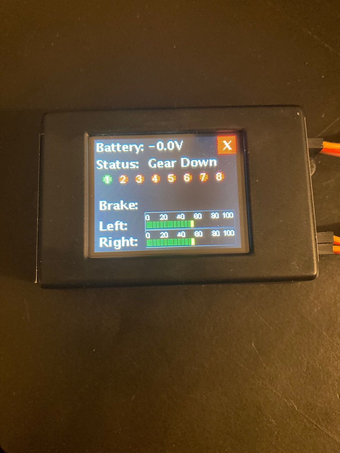

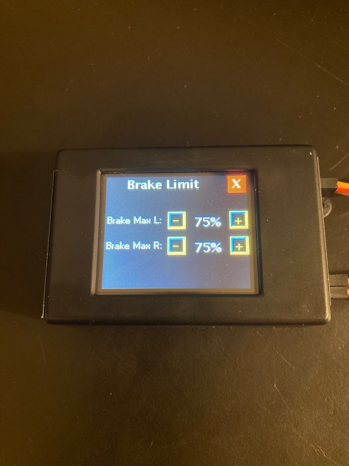

I just purchased the Xicoy LG15 and the setup was fairly straightforward. But, there is one odd thing. If I set the brake limits to 75%, go back to the main page with gear down, activate the brakes it show I am only getting about 50%. Is this a defective unit or am I missing something? I have attached a couple of pics. Thanks for any help.

The one question I have is; why does the battery voltage say 0.0 volts? If I was testing, I would have the battery and gear plugged in. From the picture, it does not look like you have fully simulated the conditions necessary to do any testing (i.e. plug in the battery and gear). You are just running part of the controller. The brakes and gear motors do NOT operate off the power supplied by the connections to the receiver. But once you fully simulate the conditions for testing, and if you still see the 50% on the screen, I offer the below information:
Try rotating the tires with the brake fully on and see what happens. It does not take as much power when the tires are NOT rotating. It might not even take 75% to totally lock them up. Also, if you simulate a skid to the side, you will see the power go up to the limit on the side needed to straighten the plane out. It should go up to but not beyond that limit. Also, your ABS and gyro settings can also have some interaction with the power applied to the brakes. But in your case, the 75% is the "hard" limit. Typically, all I ever used that screen for was to match the brakes. The prolinks I had on the Ultraflash had one brake that always worked better than the other. One would lock up before the other. So, I just cut the power back a little on the offending brake to match them up when the brake was fully applied.
Remember the battery supplies the power to the brakes and gear motors. The receiver connection power only operates the controller. These two power supplies are isolated from each other in the controller.

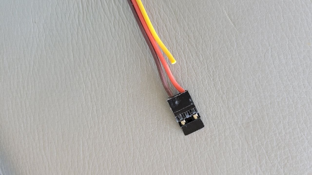

Tom, thanks for starting this thread! Martin’s video is also very helpful. I bought a LG15 several months ago and didn’t use it due to complexity and lack of good instructions/manual.
I am now ready to use it in my Baja Hobby F15. Forgive me if I missed this but the pins/polarity on the side where the battery input is located are not marked. I am referring to Brake R, Brake L, Mains R, Mains L & Nose inputs.

the middle pin is not used, the two outside pins are neg and pos. Which way you plug them in is dependent on the config of your retract motors, you plug them in so that your retracts all move in the same direction when activated. Brake polarity does not matter. Hope this helps. Tom

The Pin 1 and 3 thing is the only thing in the manual that is missing. If you follow the manual, the LGC will work. It may take some discovery time and effort as you fine tune it. But fine tuning it will give you a great LGC. The first time I set one up I laid the gear, LGC and a spare RXer, etc. all out on the bench and played with it. Once I had it all working, then I installed the gear, LGC, etc. then it worked flawlessly w/o fishing around inside the plane. Also, it should be expected that you will spend some time tweaking the gyro, brake power levels, etc.

Tom, thank you! I took a regular servo extension and swapped the signal and positive wire. I am assuming this should work?
