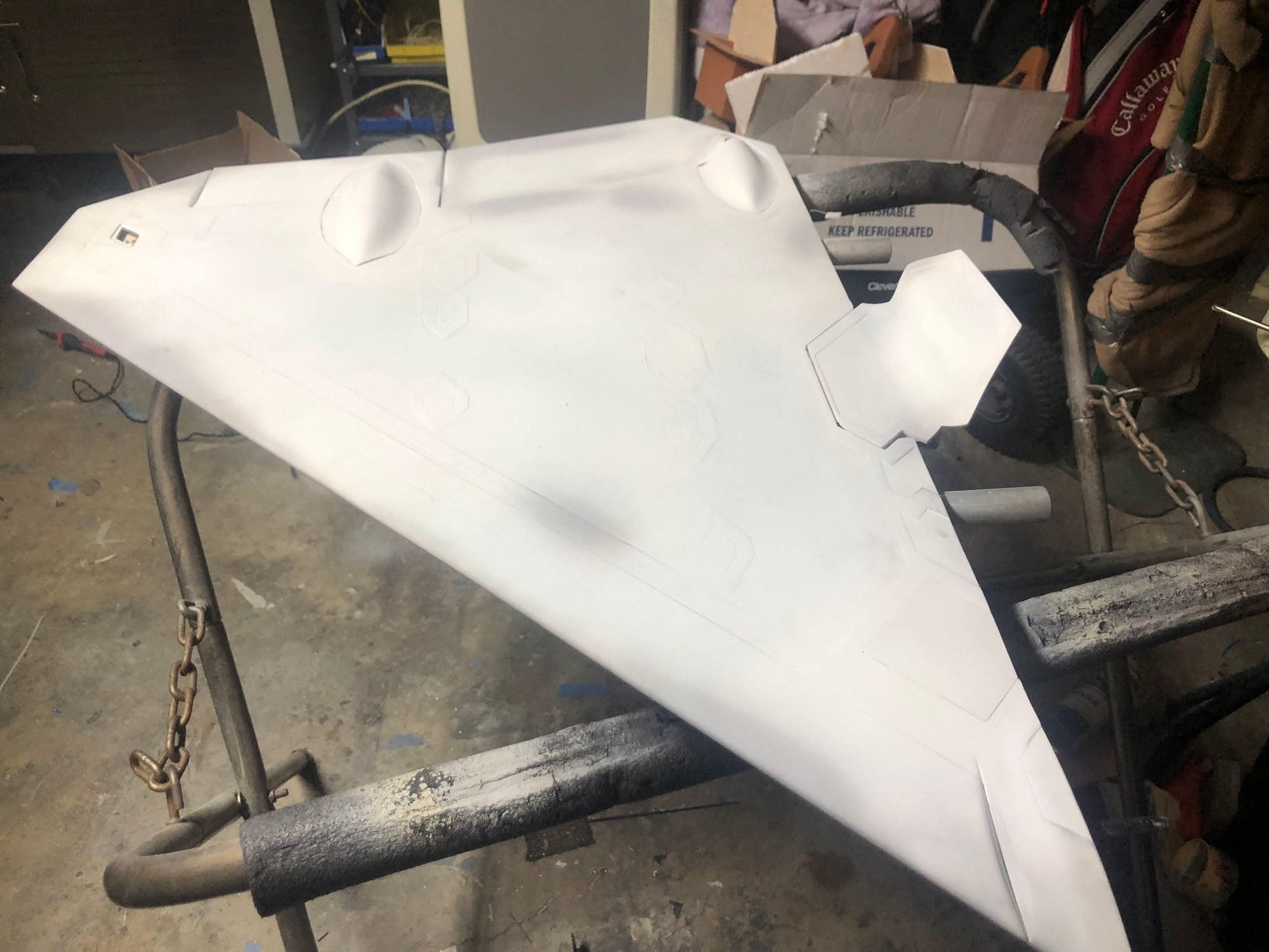

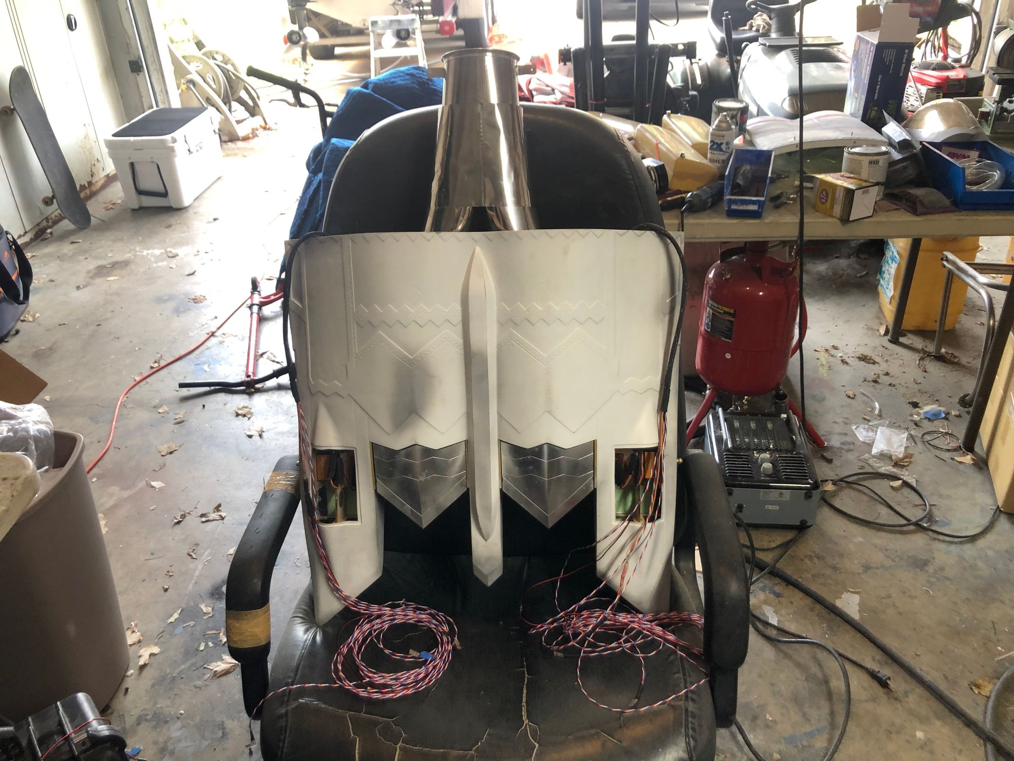

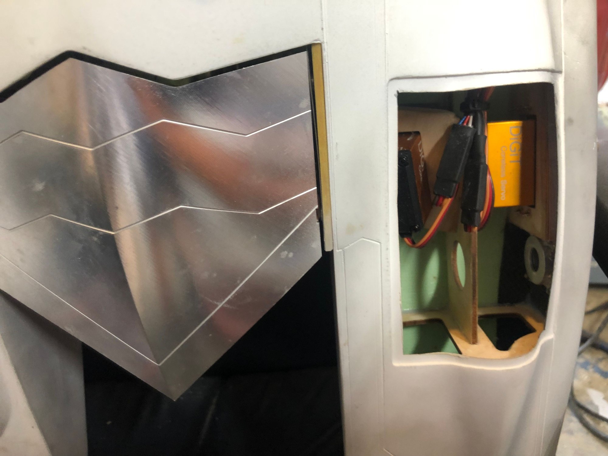

Horizontal stabs took a little more effort but still not bad. Hardest part was having to cut down the servo arms since mine where to long. You will want about a 3/4 inch servo arm. These give lots of torque and resolution. I had to trim the fuselage back a little to get decent throw.

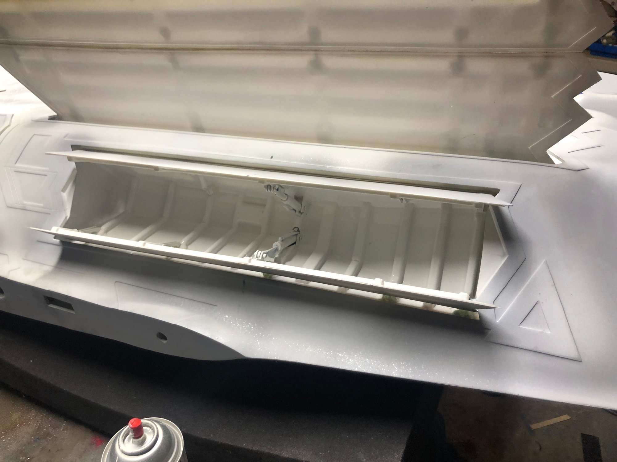

Took a break from servos and painted the bomb bays. They look sweet!

Using normal 6MM line. High flow would be 8MM.
The paint is some white spray bomb used to paint full scale aircraft parts. Its an enamel. Cant wait to get into the weather side. Going to get nice and dirty in the bays. Sean McHale is sending me some beautiful missiles for the side bays. The trick will be finding time to make them stick out with the doors open. Not allot of room in this area with the inlets and fuel tanks. We will see.

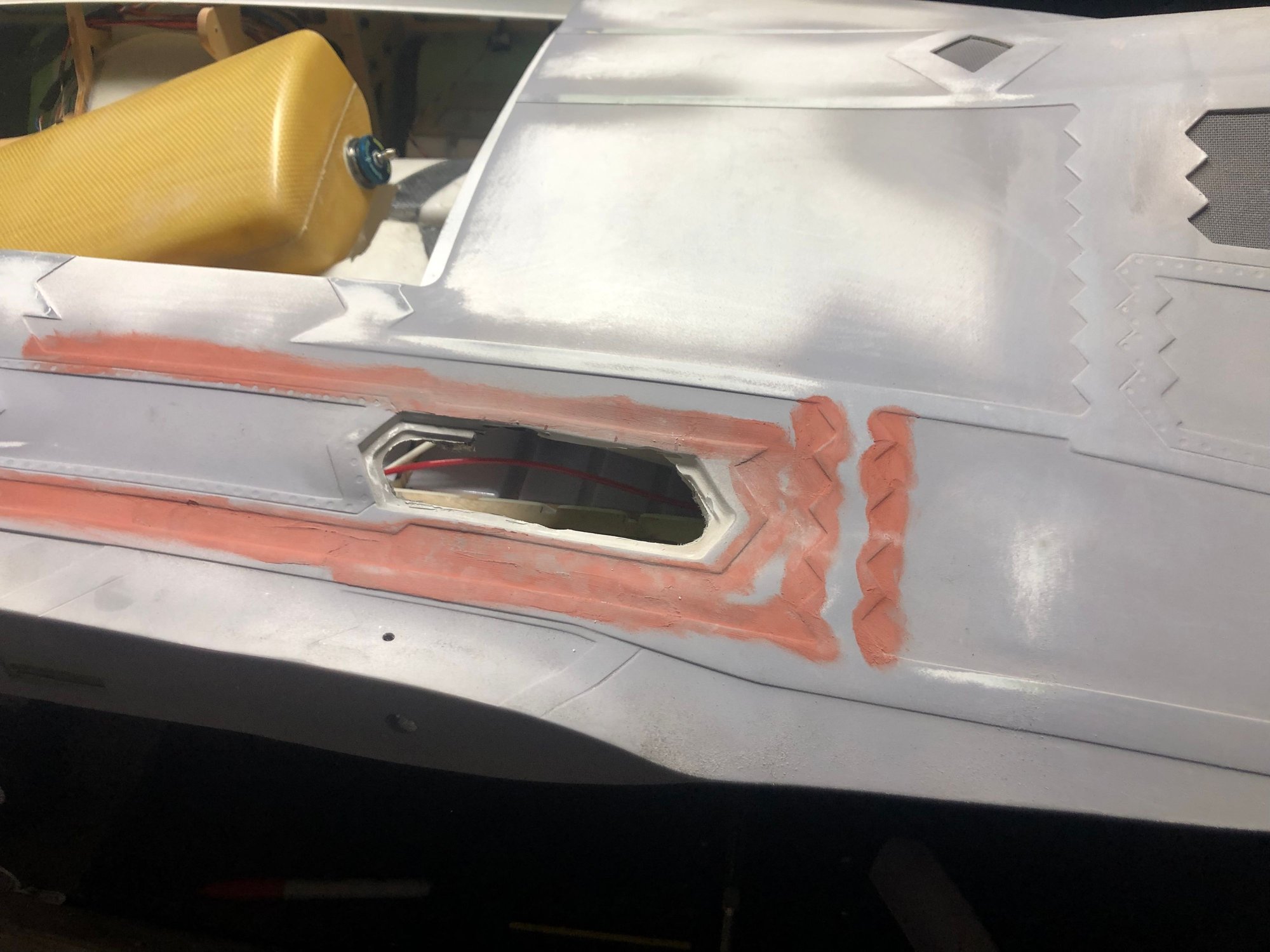

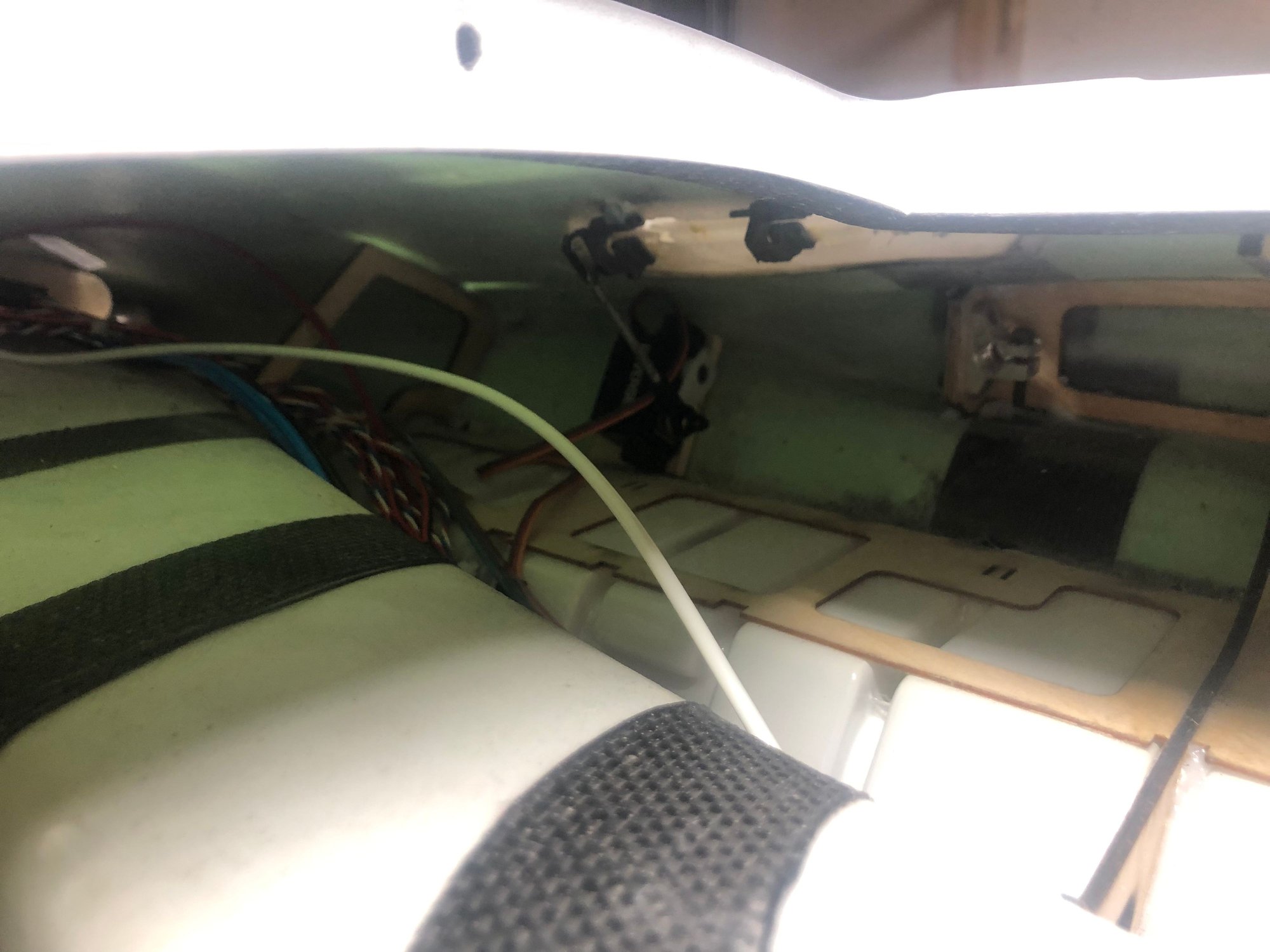

Didn’t want fuel vents showing on the belly. So I took advantage of the screens installed on the belly and made hidden vents through them.
2 blocks of wood with a brass tube glued into it. They sit right on top of the screen.

Got hinges on. Forward hinge will just clear the fuel tank. Going to be allot of fun installing a servo for it though.
I also cut the hatch latches off! I hate hatch latches. They ruin the plane. So I will be trying to come up with a hidden latch system. I have something in mind but not sure if it will work. We will see.

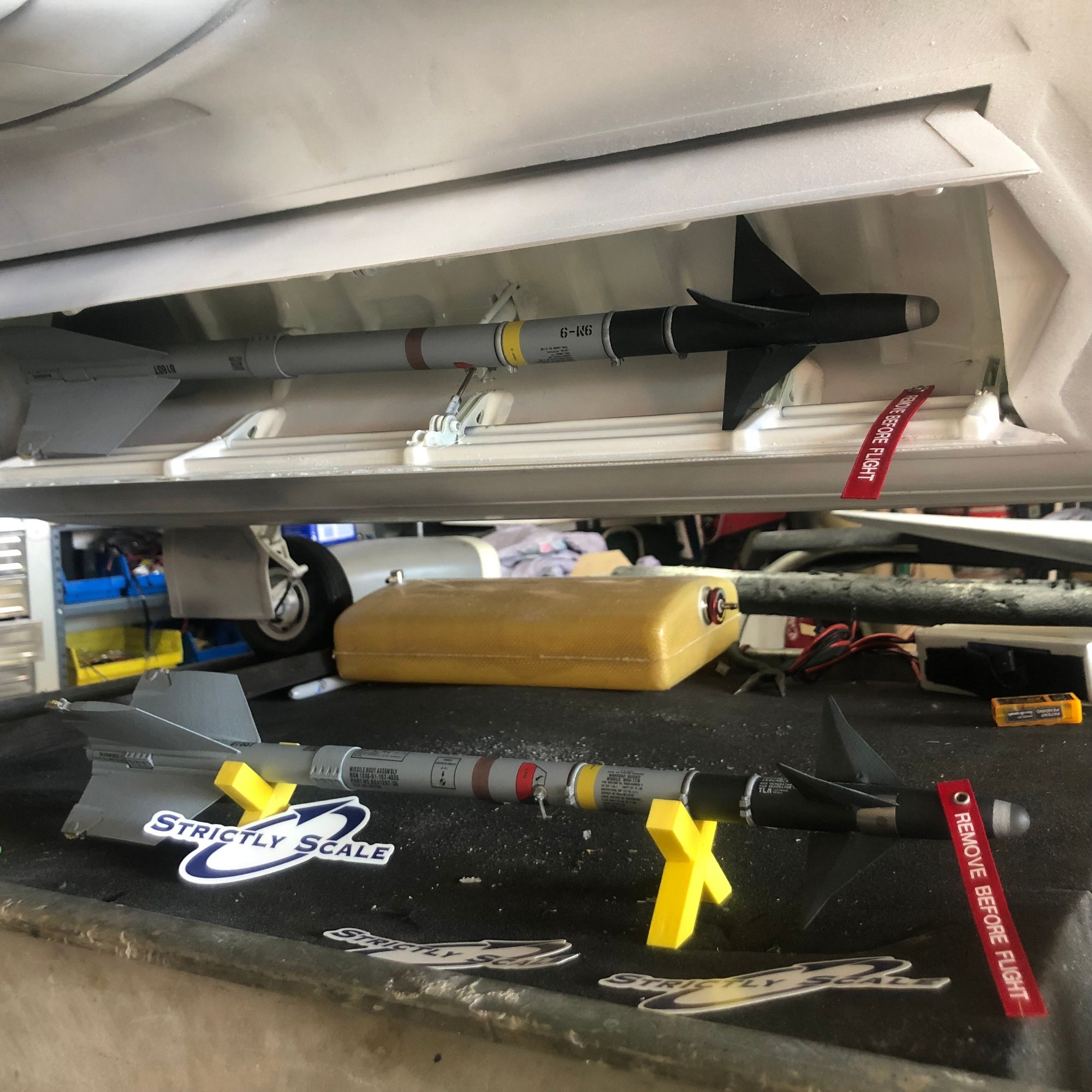

Got missiles from Sean McHale at Strictlyscale! They look freaking great! Need to do a slight trim on the fins that are on the inside but fit like a glove.

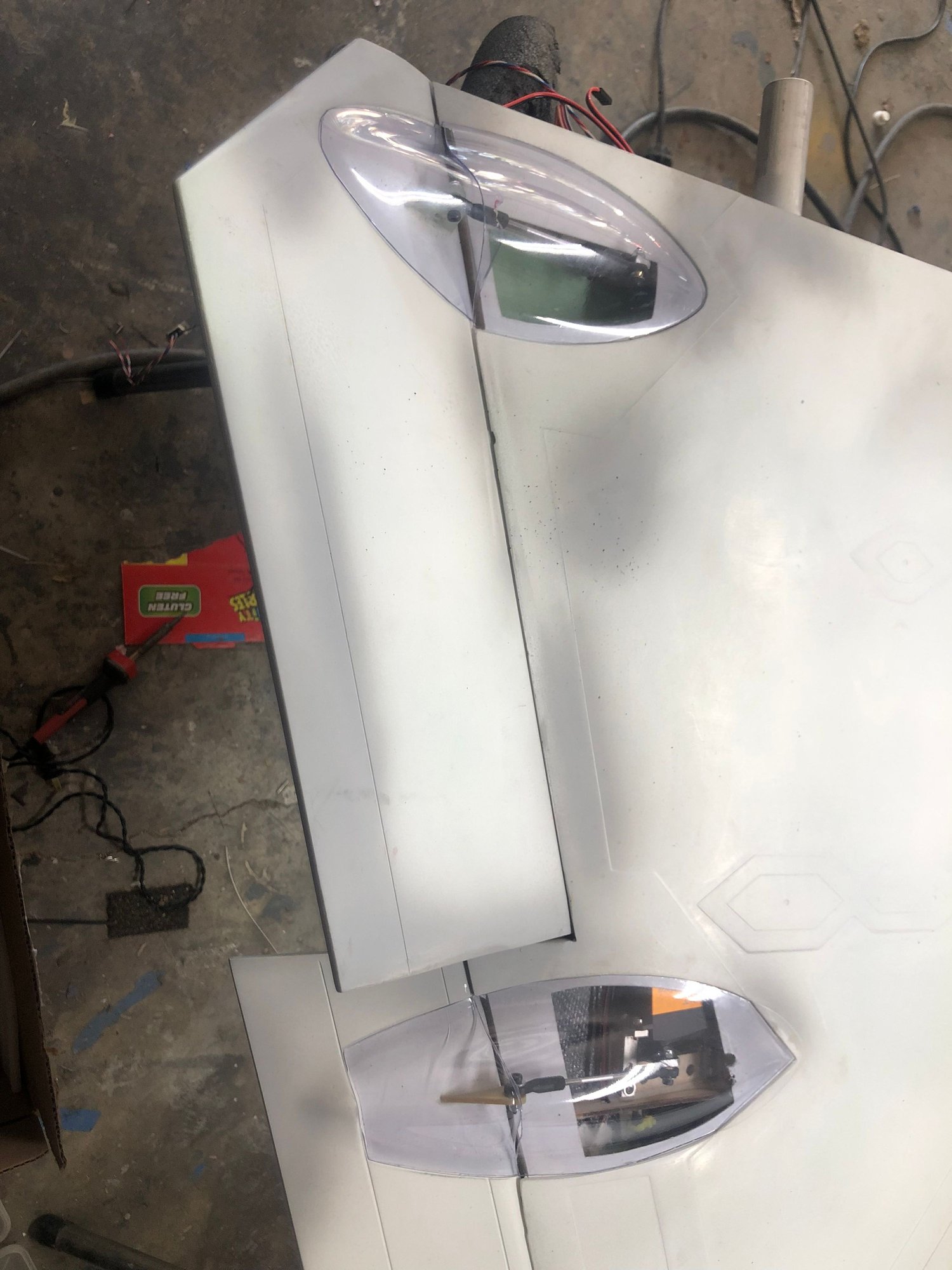

All servos installed for wings. Took a couple evenings to get done. Pretty straight forward and easy to do. Biggest thing is to use small servo arms and strong servos for the leading edge flaps.
When i I built my skymaster F18 I think I spent almost 2 weeks getting the wings done. It was a complete cluster *uck. Spent so much time with a dremel trying to make servos fit and get wired through along with trimming the rear spar...
this is is nothing like that and is well thought out and goes together pretty smoothly.
Leading edge flap.
Covers are clear.
Aileron servo
Flap servo
gunradd is offline

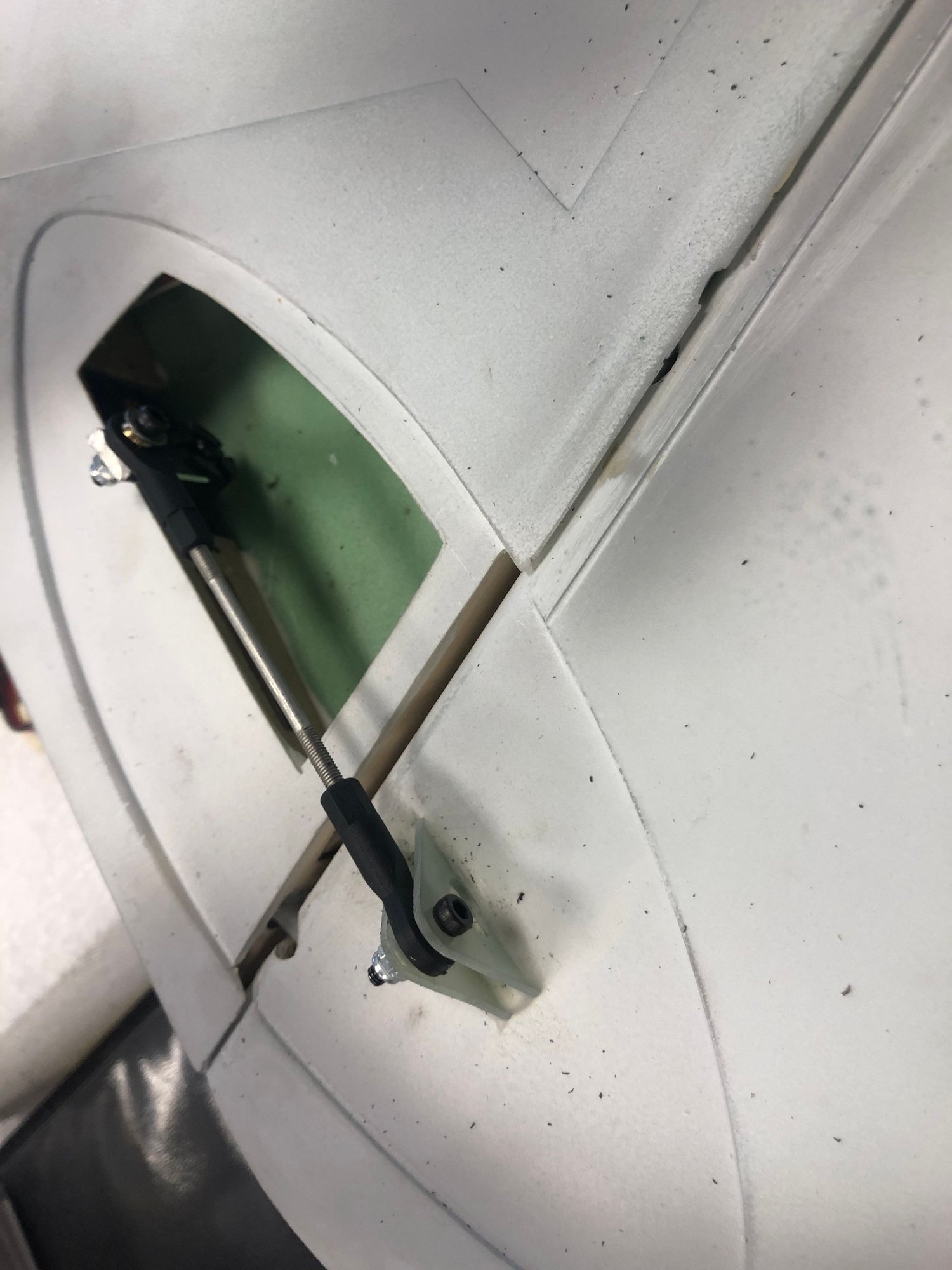

Servo arms I used where to long so I had to cut them down and drill and tap them. For the ailerons and leading edge you will need about a 9/16 length servo arm from hole to hole.
