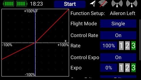

I'm looking to see if anyone knows how to setup aileron differential on this radio. I have 1 Aileron Function with 2 servos assigned to that function. Servo 1 is for the left aileron and Servo 6 is for the right aileron. Richard at PowerBox told me to make the left and right aileron functions seperate and adjust the curve in the setup menu for each servo at that point. However, this seems to make things way more complicated. If I need to ever adjust the expo/dual rates on the ailerons I'd have to adjust everything twice and double check the values on both functions seperately. In addition to that, any mixings that would require aileron such as Rudder/Aileron (Which I use for Knife Edge) would become even more complicated to setup because I'd need two separate mixes for that purpose. Does anyone have any experience with aileron differential in this radio? I'd like to hear how you guys personally set it up on your radios. I'd like to keep it simple while setting it up so that it doesn't overcomplicate things in setup.

My understanding is that there is no Aileron differential "wizard" for the CORE and until there is you will have to do it as Richard says. I believe this function is a high priority though and that Powerbox will implement something soon. As nice as the CORE is there are a few ***? things about it and this is one. If I misspoke apologies all around, the software changes very rapidly with a flurry of updates and there are also some very clever solutions guys have got for these situations

As a matter of fact, Richard said the wizard for aileron differential will be available in about 2 weeks. I honestly think that will be the best option as it'll really simplify things. Creating 2 separate functions for the aileron just creates a ton of new things to look out for when making adjustments to mixes or expo and even dual rates. I can't wait for that update to come out as I really need it.

I just set the travel with an offset for each surface, left or right input. Then all expo and D/R changes follow the same percentages.
it’s rare to have a model where the travel percentages are the same anyway. They might start at the magic 100-100% but to get perfect rolls having 98-99% one direction is common. So for top hinge surfaces where you need more down aileron than up I have 100% up direction and 105% down. (Or 95% up and 100% down direction etc)

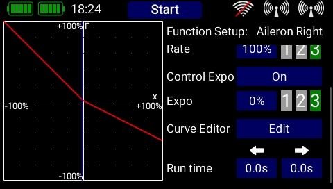

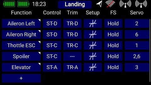

Hello together,
from perspective it is super easy to setup a aileron differential.
Step-1 create two functions one for aileron left and one for aileron right.
Step-2 create two 3 point curve in each curve editor like shown in the pictures
Job done.
BR
Dirk CB Elektronics

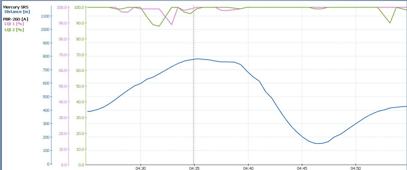

just a quick snap shot from last weekend Predator/Core flight. The graph shows the correlation of max GPS distance to LQI1+2 of receiver A. Nearly 800m and it was already difficult to see the Jet at this phase in flight.
I fully trust my CORE!! In use now over 2 years!!
BR

A snap shot from PB, Ideal conditions even at 1/2 the claim still impressive.
