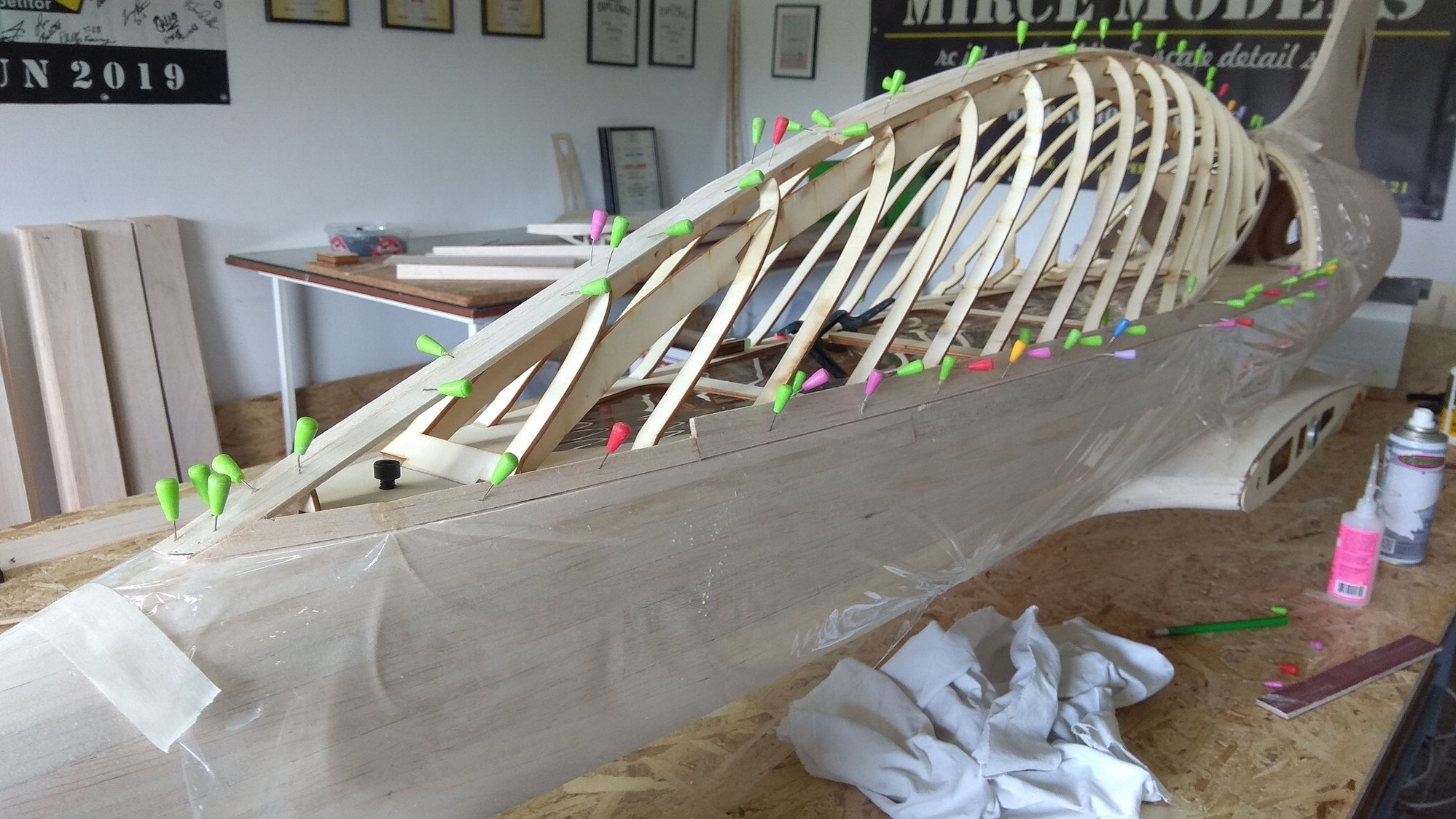

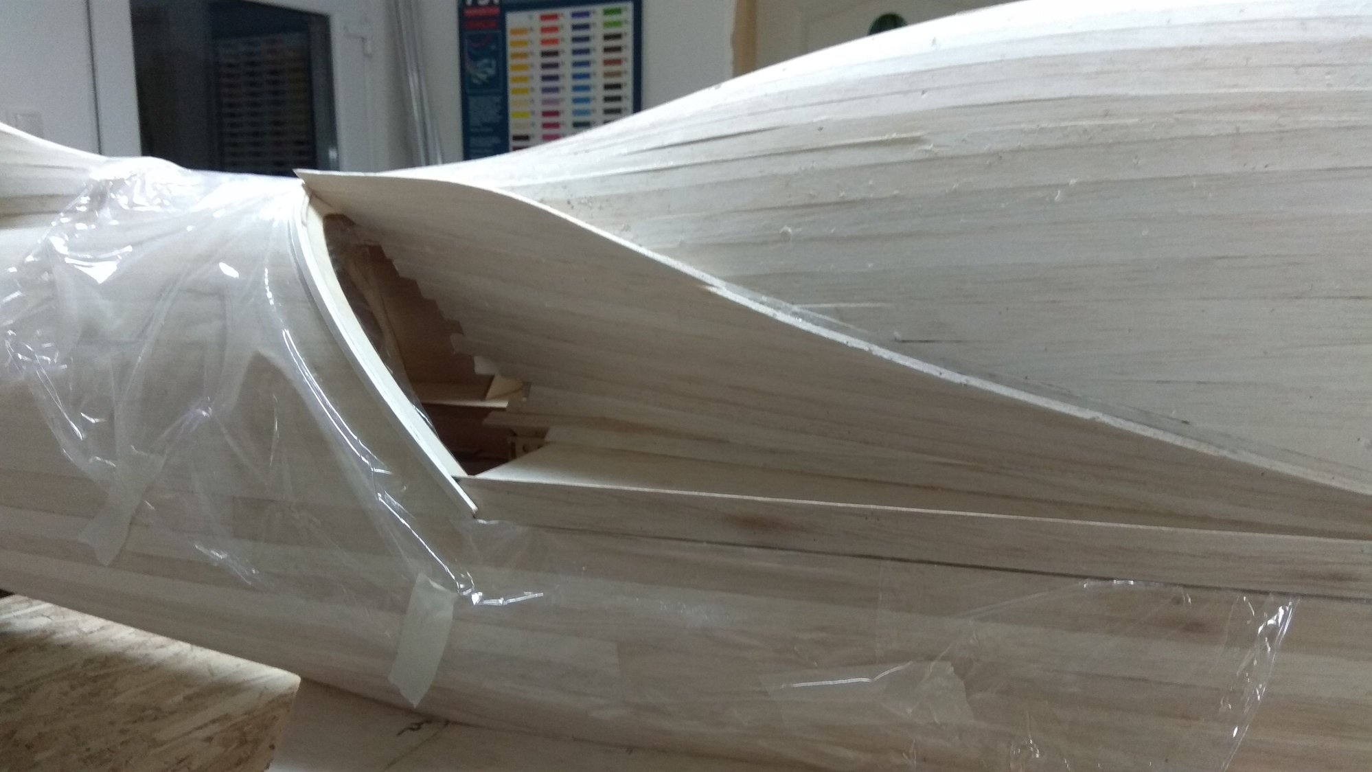

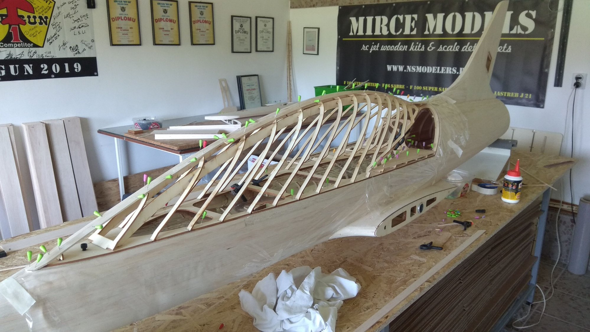

My second "NEXT" model...
The first was a prototype made for Damiano, and with it he has made more than a few hundred flights so far.
This second model I started more than a year a half ago, meanwhile making a few F 100 and F 86 and finally it was time to finish “NEXT”.
http://www.nsmodelers.rs/jet/next---aerobatic-jet-model
For more information or order, please send email.
[email protected]
A little reminder of how it was at the beginning. Fuselage...

A couple of pictures from the making of the wings.
As you already know, this model is completely made in 3D and the parts are cut on a laser cut machine.
It is interesting to note that this, as well as all "Mirce models" wooden kits, have templates in which the wing ribs are placed.
Production is fast and precise.
We use G 10 parts for flap hinges with offset displacement, which allows ventilation when the flaps are in the lowered position. Horns are from G10 material also.
This parts are available on "Mirce models" web site and can fit on every big jet or warbird model - Galeb G2 - hinges & horns from G10 material - nsmodelers.rs
The recommended retracts are Electrons E 40 and the template that comes with the model allows easy positioning of the opening.
"NEXT" - aerobatic jet model - nsmodelers.rs
