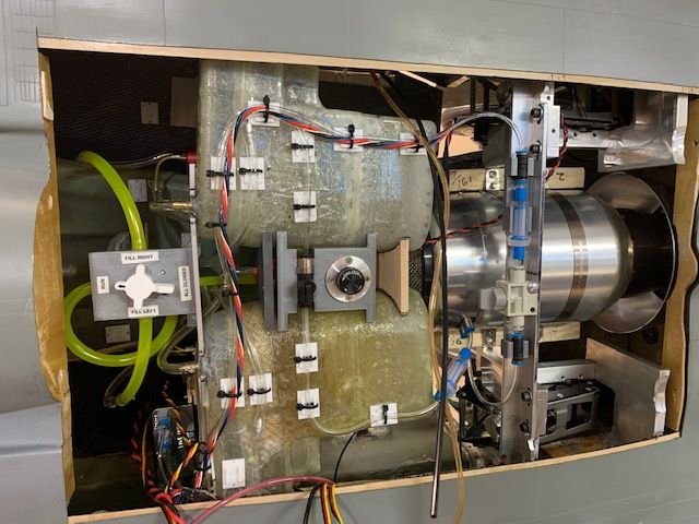

Default Progress update on Byron F15 turbine conversion
Here's a few pictures of my F15 turbine install. It's been a while since I updated. I read back over some of the earlier posts here, and ran across post #158 where I mentioned I'd been sick with the flu. I have to say it was a very weird flu, nothing like I'd experienced before. Of course, none of us had any idea of the tsunami that was about to come. Soon after post #158, the big Pandemic hit us and I always wondered if I actually had Covid. Guess I'll never know, but isolating gave many of us the biggest building season we've ever seen. I hardly flew at all, all summer long. I can't say the extra time really made much difference. I got more done when there wasn't time.
FINALLY FINISHED MY DIY CUSTOM SADDLE TANKS. LEAK TESTED OK!
THIS IS A HOME MADE UAT. THE 2ND ONE I'VE MADE.
I ALWAYS MAKE MY OWN AIR TANKS FROM ALUM HAIR SPRAY PRESSURE CANS.
3D PRINTED FESTO TUBE GUIDES TO KEEP THE STIFF TUBE CURVES FROM MESSING UP THE SEALS.

Sweet, I like the hair spray can, nice setup !!!!
