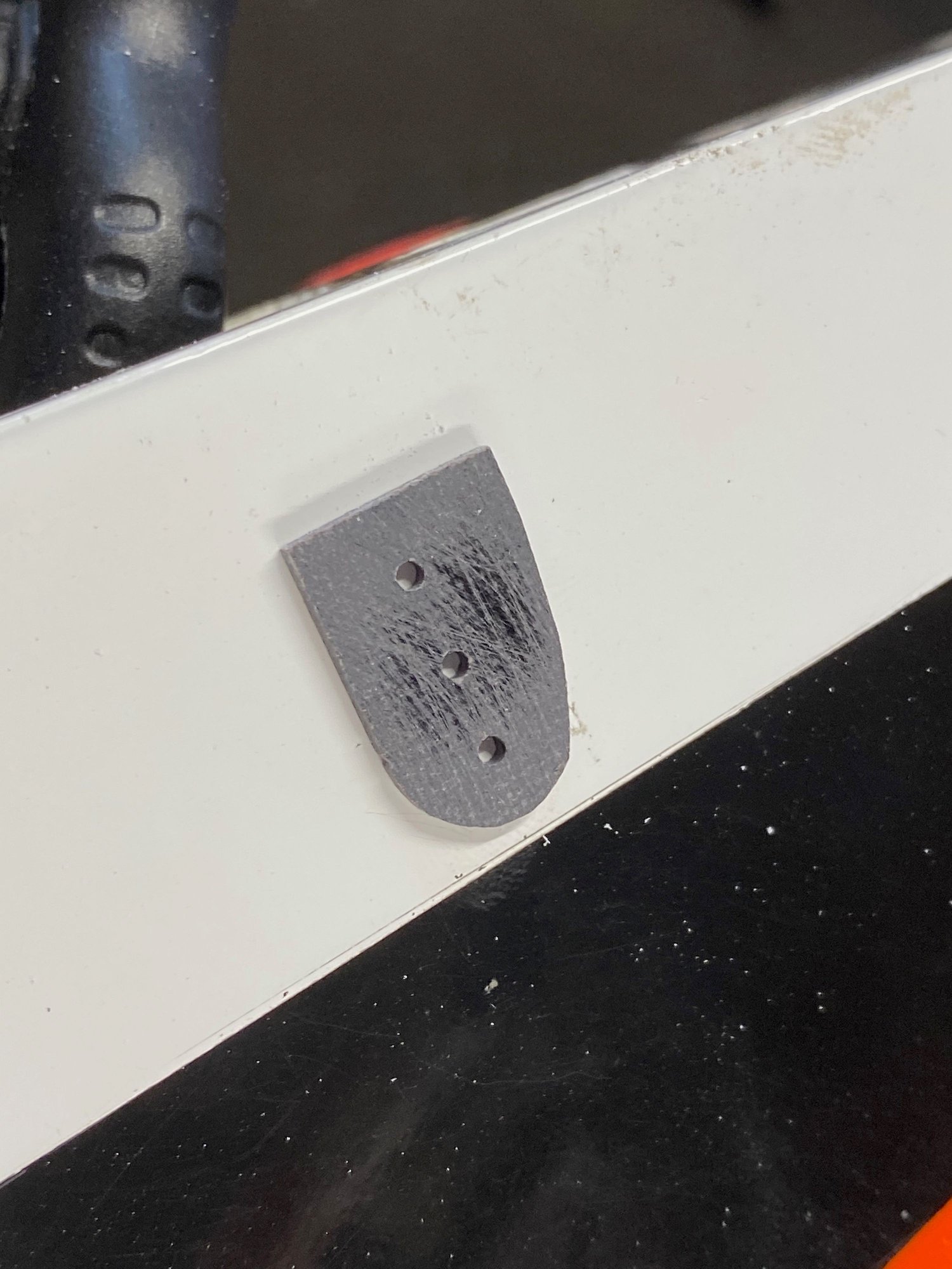

My right wing came. The factory failed to install the control horn for the flap. They did send the part either. I made one from G10 and guessed at the shape. I measure the left wing to try and get the geometry the same. The wing half cost about 1/3 of an entire new kit. One would expect better quality control. In the end, I have no choice but to make the part and move forward, I cannot send the wing back.

CARF reached out to me and were sorry the horn wasn't in the wing package. I was a bit harsh with my comments, I made my post when I was mad. So, please don't think that CARF is not trying really hard to be the best RC company out there. I really enjoy their models. I have two of them and I'm think to get a third. I sure many people would be sad if CARF was not around.
Making the replacement flap horn and installing it was not hard for me to do, because I've built many molded sailplanes and this type of work is often needed. I actual enjoyed doing it.
When I finished, I found the control rod from the original wing was too long and couldn't be shortened. I made a new rod using Sullivan 4-40 clevises. 4-40 is about the same diameter as 3mm, but the Sullivan Clevis is considerably shorter than the 3mm ones that came with the Rebel Hot kit.
