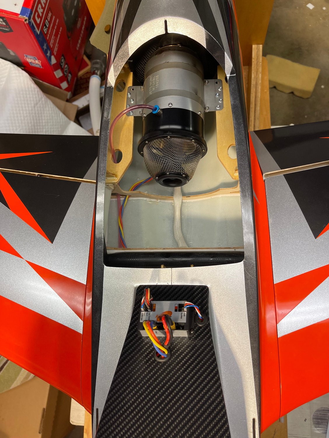

Wanted to share my install. Just finished the rebel Hot. With UAT full and Tank empty came to 6kg even (13.2lb). I have a JetsMunt M70xbl. Still have to CG. Will start at the back of the wing tube.

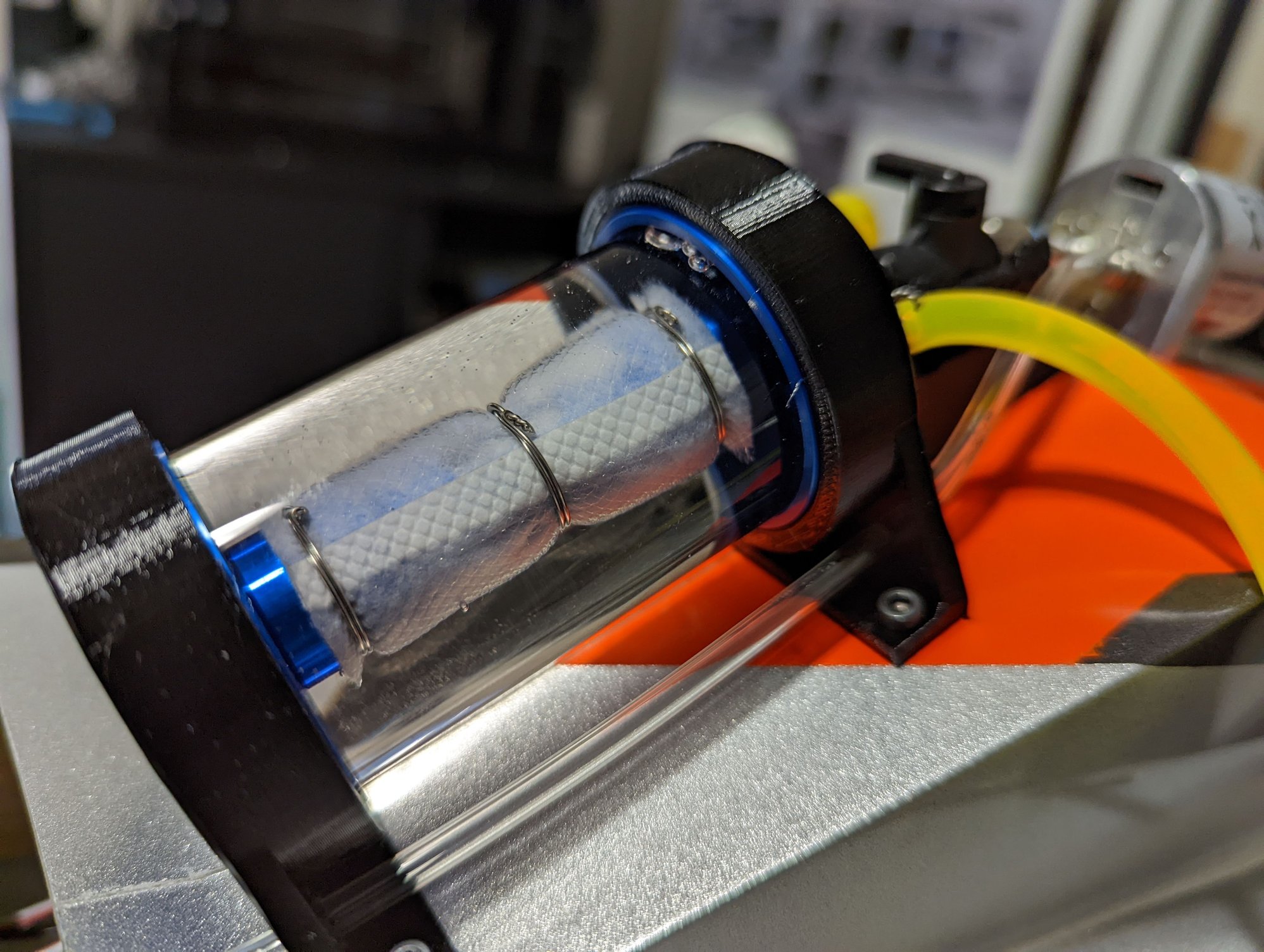

Default Critique my fuel setup
So I'm done with plumbing finally, only missing step is installing electronics, programming radio, and CG.
Tried to keep it as simple and clean as possible. I modified a 3D printed valve holder STL with an angled base, which came out great, though not as perfectly aligned as I had hoped.
Anybody have any objections on my setup? In hindsight I have 2: Should've mounted the UAT with the ports vertically to facilitate bubble elimination (meh I can always just tilt the model around). And I know Tygon on festo connectors is controversial, but many people swear by it and I have a CM jets tank on the way so it can be festo connectors on 4mm PU hoses all throughout the system.
And no I didn't forget the filter, my fueling cans have felt clunks and a final 2 micron industrial filter before the nipple to the fill line, and this DIgitech UAT itself is a very fine filter (supposedly).

Tygon on Festo is a 100% No No and people who swear by it fools.
I know it’s a small turbine, but 4mm od (2.5mm I’d) tube on the suction side gives the pump a hard time. The difference in area between 3.2mm Id Tygon and 2.5mm tube is huge as a percentage.

I use 6mm festo tubing between the tank and UAT. I prefer hard tubing everywhere possible, only using Tygon inside the tank or on a barbed fitting, ie the fill line. But never into with a Festo!

I installed the same Digitech header tank in my K70 Rebel Hot. You can see it in post #891.
I suggest you rotate the tank 90-deg so the line to the tank is at the highest point, keeping as high as possible above the fuel inlet to the pump.
It seems you have the fittings installed wrongly. Swap the barbed fittings to the fill line and use the Fesco fitting between the tank and header tank inlet. Use 6mm between the tank and header tank. 4mm between the header tank & pump and between the pump and the turbine inlet.
As Dave W. pointed out, it is better to use larger tubing on the suction side of the system so that the pressure drop is minimized. But since the clunk line is smaller than 6mm, this is only a very minor improvement.
I like to put the pump close to the turbine to keep the discharge line short. The pump is positive displacement type and cavitation is not an issue, so as long as your set up is leak-free the pump will deliver the fuel.

What's the merit of keeping the tank inlet up? I figured bubbles are gonna rise to the top anyways and if I needed to vent them out I can just move the whole plane itself (not ideal I know but I was more concerned with packaging and if I change the orientation the valve mount would be in the way and I'd have to re-do everything)
I considered putting the pump on the engine mounts but was concerned with CG being too far aft since it's a bigger engine. Won't really know until I put it in the balancer, I may relocate it.

You need to turn the hopper 90 degrees. At the moment you will only get the hopper tank half full. Follow the process, fuel goes in, hopper fills till it starts to feed to main tank.

I was wrongly rationalizing that it wouldn't matter but I see why now, any bubbles would just stay stuck up top instead of venting through the tank port right?
Dammit I have to redo almost everything mounting wise then

Well before I tore everything apart I decided to test the thing for grins with my new RC fueling systems can with the graylor pump and long story short as far as I can tell the way it's mounted should be a non issue. When filling up it does go up to 99% with the tiniest bubble left over at the top. When emptying with my pump at full speed, there's a lot of cavitation bubbles but even then if I run it in reverse until the main tank is dry, the UAT never seems to go less than 80% full. And the turbine's pump is nowhere nearly as powerful as this so as to cause the bubbles. I plugged off the vent to pressurize the whole system a tiny bit and everything seems tight no leaks whatsoever. I guess this fueling pump is powerful enough that the orientation doesn't really matter and the bubbles just get pushed out to the main tank vent no matter what. I tried filling and emptying while tilting the plane around and the results were pretty consistent. I'll obviously do one final test on the ground with the engine itself and shaking the crap out of the plane in the process but I have no reason to believe it will be any worse. Dunno if it makes sense but if you guys really want I could take a video.
About the average size bubble I saw. Worse case was not a whole much more than this.

When you did the filling the fuselage was flat like it would be on the wheels? I know the hopper is angled, but still does not look like it would fill completely sitting still. Yes you can manoeuvre the airframe around while filling just about any set up-but that is not always practical.

I can't see a bubble or two in the air trap mmaking any difference.

Correct they don’t that is the point of them!
This is my bubble trap at the end of a 6.5minute flight

I just don’t understand……you buy an expensive UAT, and then decide the design is not good for you installation…so you change the way it’s suppose to be used….then once you get a flame out….your most likely going to say the UAT wasn’t good…..well good luck 🤞

Let's not be drastic here. I won't. I am capable of learning from my mistakes. Should it work flawlessly, and I don't see why it wouldn't so far, what are you going to learn from that then? Furthermore, at least I'm getting CNC machined parts and industrial grade connectors. Overkill? Perhaps, but I'd say that's far more for my money than paying $50 for a glorified $2 nalgene bottle with a $2 lawnmower filter with some holes poked through it. Those gave me far more flameouts.
