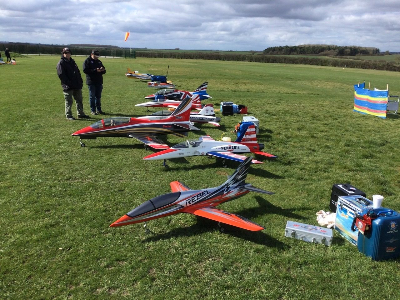

This Rebel Hot with a distinctive scheme at the JMA meeting at Buckminster Lodge over the weekend
Alistair Powers
