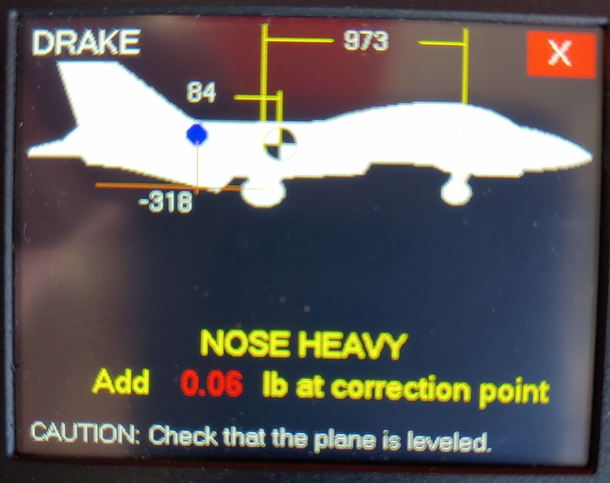

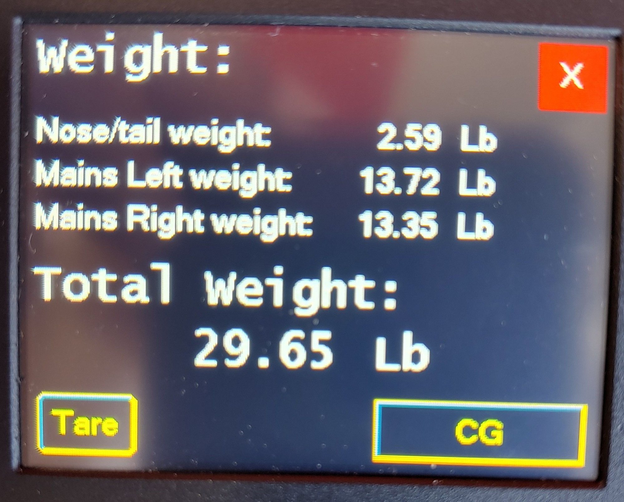

I actually balanced my Drake 1 7/8 inches further back than the manual states.
I just keep moving things rearward a bit at a time until it flew really well.
I just acquired a Xicoy electronic balancer and as you can see from these photos the balance is near perfect
The - 318 mm is the distance behind the mains wheels to where I added weight (at the engine area)
