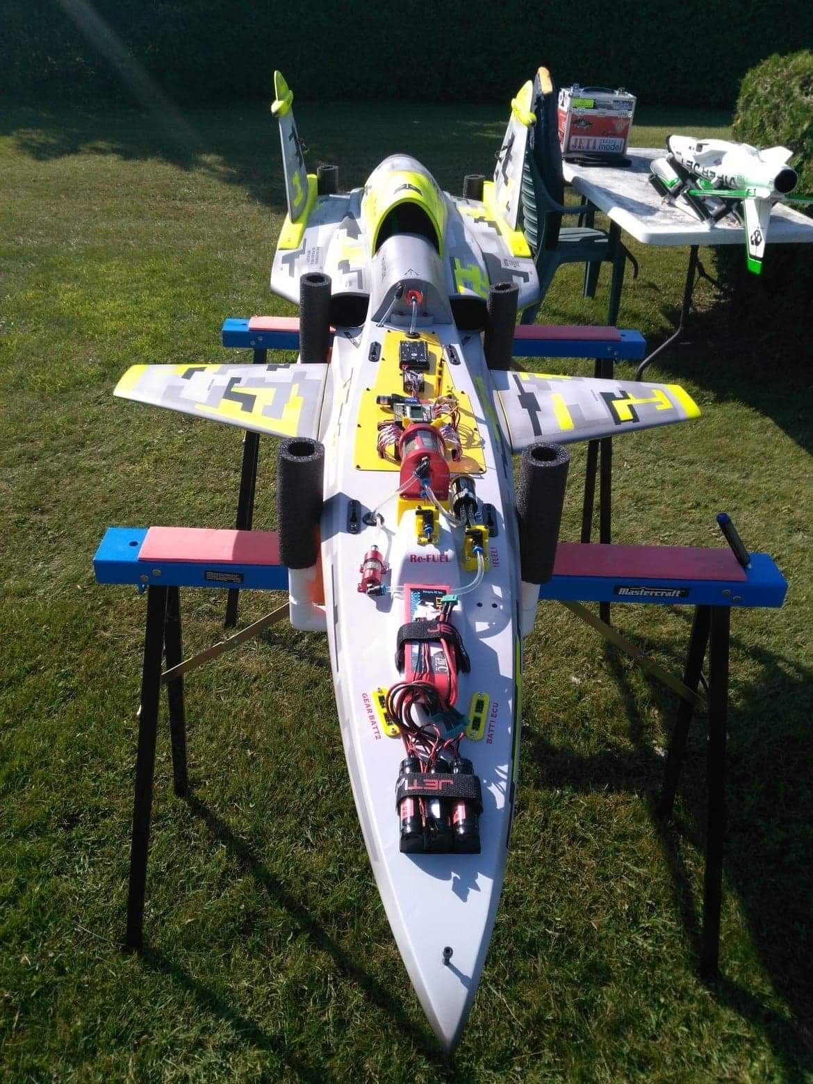

I wanted to get one the day I saw it......for 2 reasons, The model has quite an orignal design that appeal to me, and I have own many SAB Heli and they were all great so...I taught the Plane would be great as well....got one of the first In North America.....put all the best in it....with a K210.
At first I was like geez this nose section is so heavy with the unknown amount of lead the factory put in it.....build it like the instruction said and place as much forward as possible....did the CG and had to put even more lead into the nose....??
The fuse is now broken just half of the split.......not sure if I will ever fix it, or get another fuselage......it was flying fine...but I think the jet is just too heavy, because of god knows how much lead there’s in that nose...I added 336gr....to the big chunk...also run 4 batteries (needed the weight anyway)

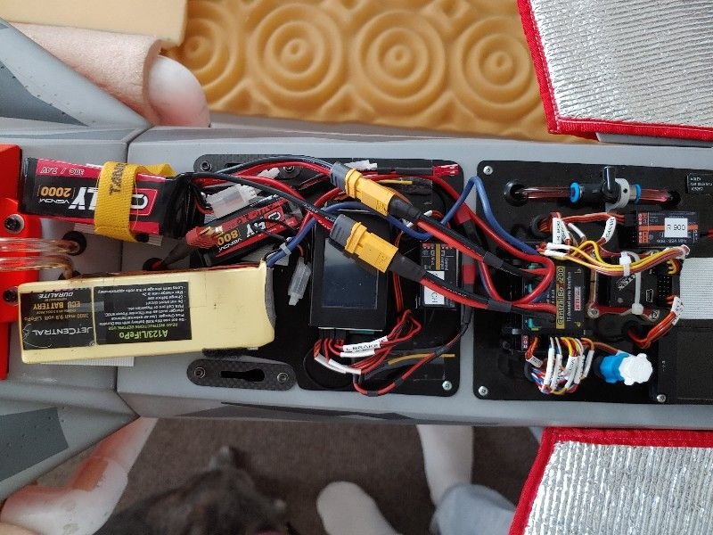

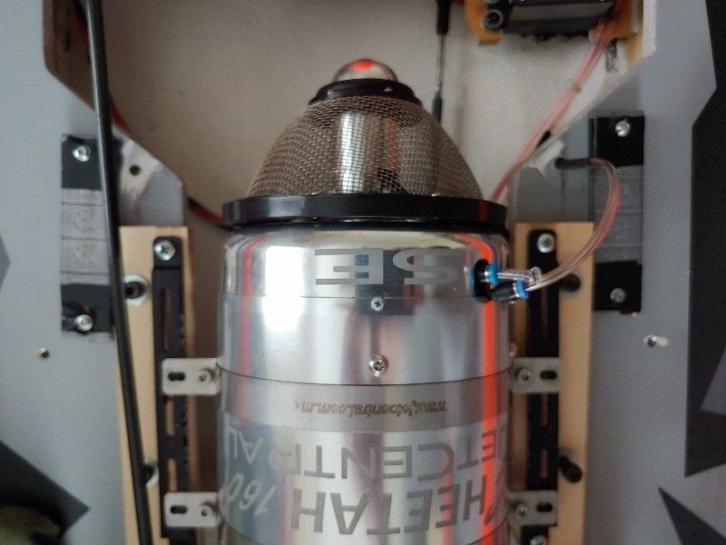

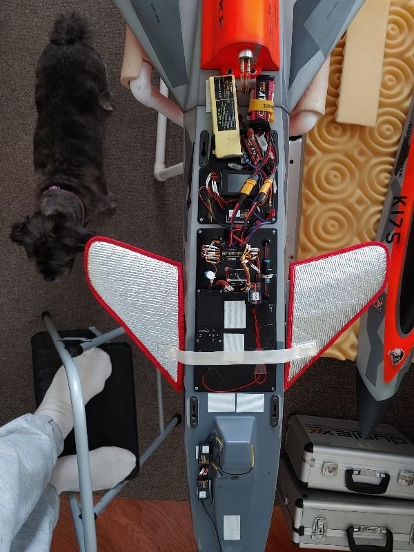

I have the Drake that Dr. Scoles built.
Balanced it as per the manual and have to agree with everyone that it flew as if it was VERY nose heavy.
I had placed two(2) 3,200 mAh Venom hardcase LiPo receiver batteries ahead of the nose gear wheel well, the ECU battery and an 1,800 mAh battery for the gear just behind the nose gear wheel well.
The Powerpack for the JC Cheetah was installed under the rear equipment tray and the UAT was placed under the forward equipment tray.
I used a Xicoy LGC-15 controller for the gear and brakes to have more control over the braking.
The Drake balanced exactly where the manual showed.
As you can see in the photos I have switched to smaller (lighter) batteries, except for the ECU battery and moved all the batteries as far back as possible. I have also placed 6 oz of weight near the motor.
The Drake now balances 2 inches further back than what the manual shows and is just slightly nose heavy. The thrust vectoring now has more authority than the first flights even though I only have a 36 lb thrust motor.
It flies well, is very stable and when I slow it until it stalls the plane starts to mush and then the nose gently falls with the wings remaining level.
I use both rudders as airbrakes and it slows the plane up a bit but also keeps the nose up in a good attitude for landing.
I flies a lot like my C-ARF Rookie and am really pleased with it.

Where did you get the wing bags for the Canards?
Tone

They were canard covers that I had left from a Rookie.
I cut them down to fit the Drake canards and added the strap to hold them in place.
