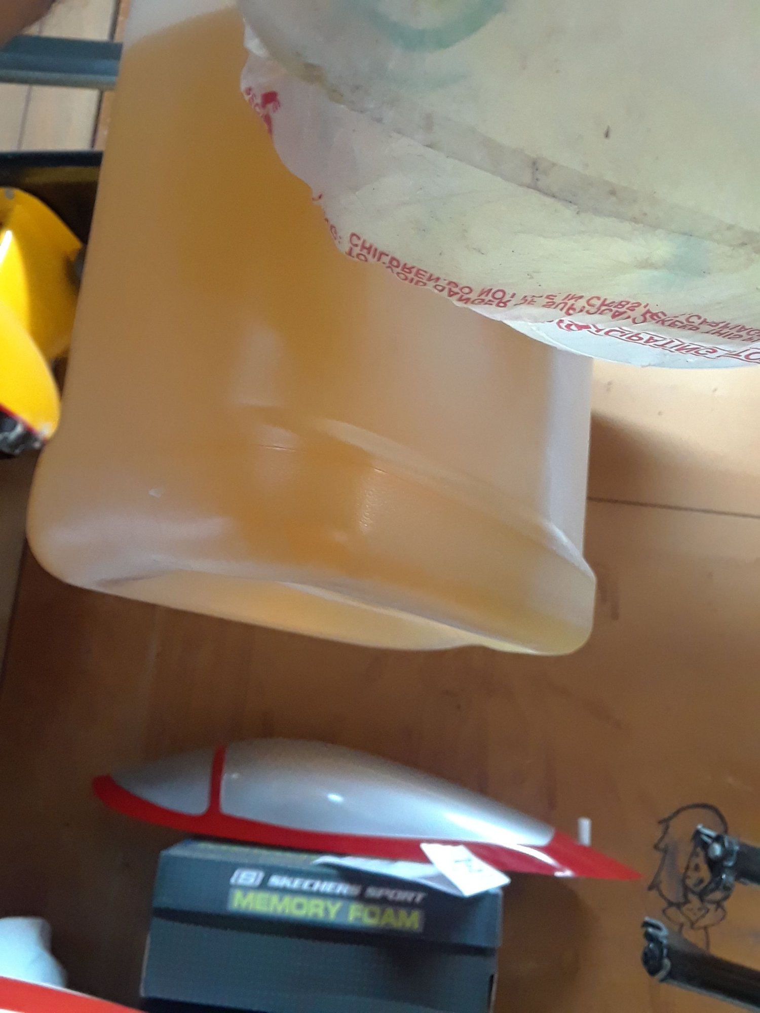

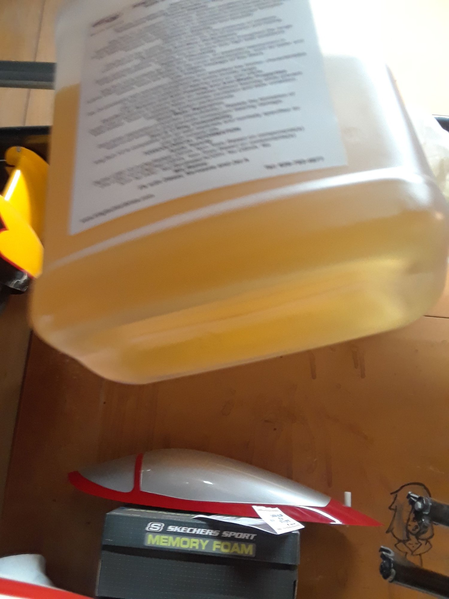

As the title says I am new to turbine jets. I have a couple of questions about the fuel. I am currently using a stainless steel fuel can and running kerosene with the king Tech turbine oil. Here are my questions
1. When I had my turbine on the test stand on a hot summer day I noticed that the fuel sitting in the fiberglass tank got much much darker after being in the Sun for a couple of hours. It went from almost clear to a light tea color. IS this normal? Or if something weird going on?.
2. I mixed my fuel with the kingtech oil but because I had some issues with the turbine and am waiting for my jet to arrive, the mixed fuel has been sitting in the stainless steel can for a few months now. How long can the fuel sit and still be usable. I have several gallons left and would hate the thought of disposing of it if it is still good.

Yes the fuel will turn darker if left in the sun. It does not affect it though and is fine.
The kingtech oil is fantastic since it does not separate in the fuel. It stays suspended so it should be fine in storage for a long time as long as water in kept out.

The darkness thing was bothering me a bit so thank you for the clarification. So even though it gets darker, the oil is not breaking down or anything? Also, how long is a long time for the fuel to sit in the can?

If you still have it next year, it will still be usable. Just take care to prevent moisture absorption.

if its moisture free then a few years would be fine.
