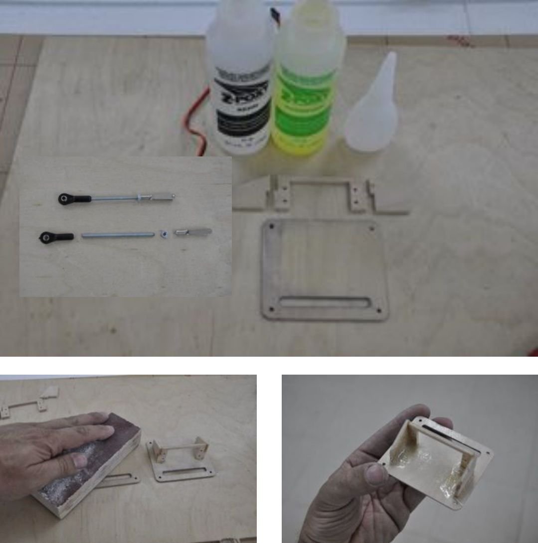

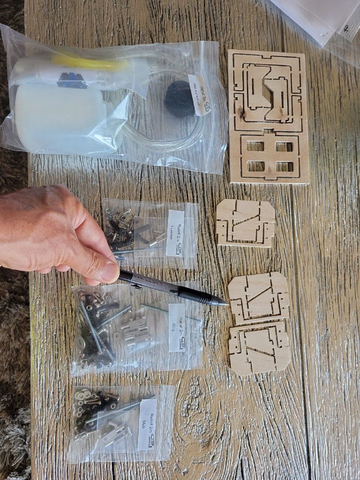

Guys, my apologies for asking too many rudimentary questions. I have been flying PNP jets and my build skills are not that good. I am trying to figure out how to install the aileron servos. I see the wooden brackets in the parts bag, but not sure how they get assembled and installed. A picture of the installed servo would be greatly appreciated!
I'm also not sure what the bigger piece of plywood with 4 square cuts is for. That was in the UAT bag.

Yes, cut them out, assemble and fix to plate. Plate will need rough over with 80 grit and alcohol. Look at something like a Viper manual on CARF’s site.
other plate is for CARF hopper tank…scrap wood for the box😉

Dave, you are a lifesaver! Thank you! The Viper manual has detail explanations and pictures for servo mounts. I copied a picture of the mount here, maybe it helps the next guy.
