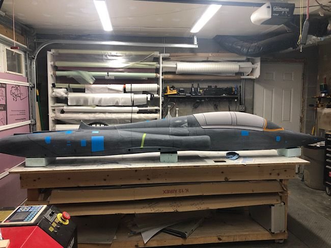

Its been a long time coming, but the new nose is done and the fuselage is officially ready for detailing.

Detailing has begun
i started off with the canopy and the windscreen. I use varying widths of masking tape for any parallel panel lines. I use a 4mm vinyl masking tape for the outlines of the clear portions. Panel lines themselves are either 1/32” or 1/16” chart pak tape. I also marked canopy and windscreen frames for all of the drill positions for the screws.
i also wanted to see how the vinyl cut hatches would do, so i put the ones on the top of the fuselage behind the cooling vents on

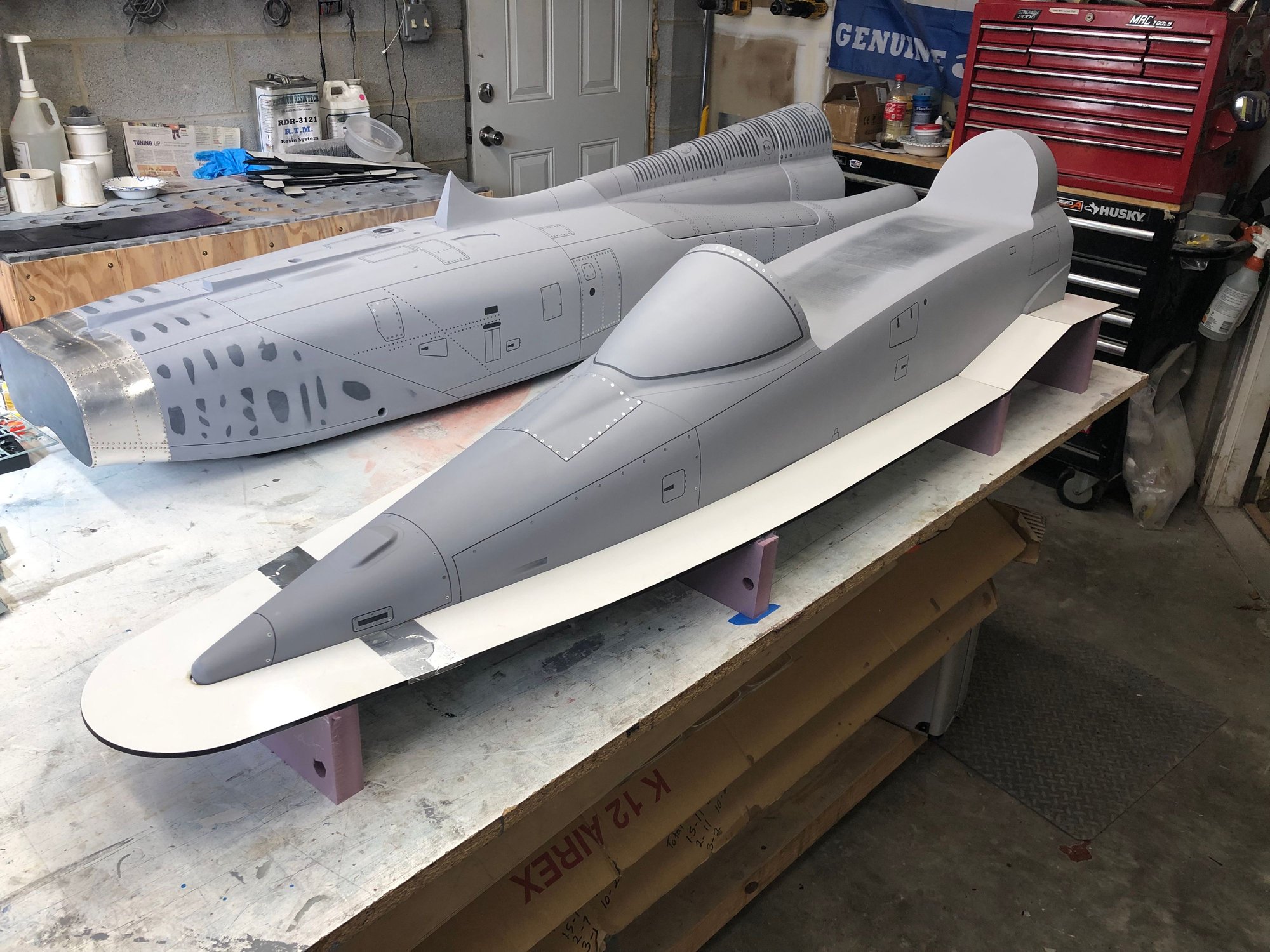

The fuselage detailing is complete with the fuselage spine texture now sanded in. The 3d printed parting planes will be done today. When i get back home next, i’ll finish drawing the remainder of the fuselage parting planes so they can be cut on the laser.
if all goes to plan, the two hatches and nose will be ready to mold by the end of the year.

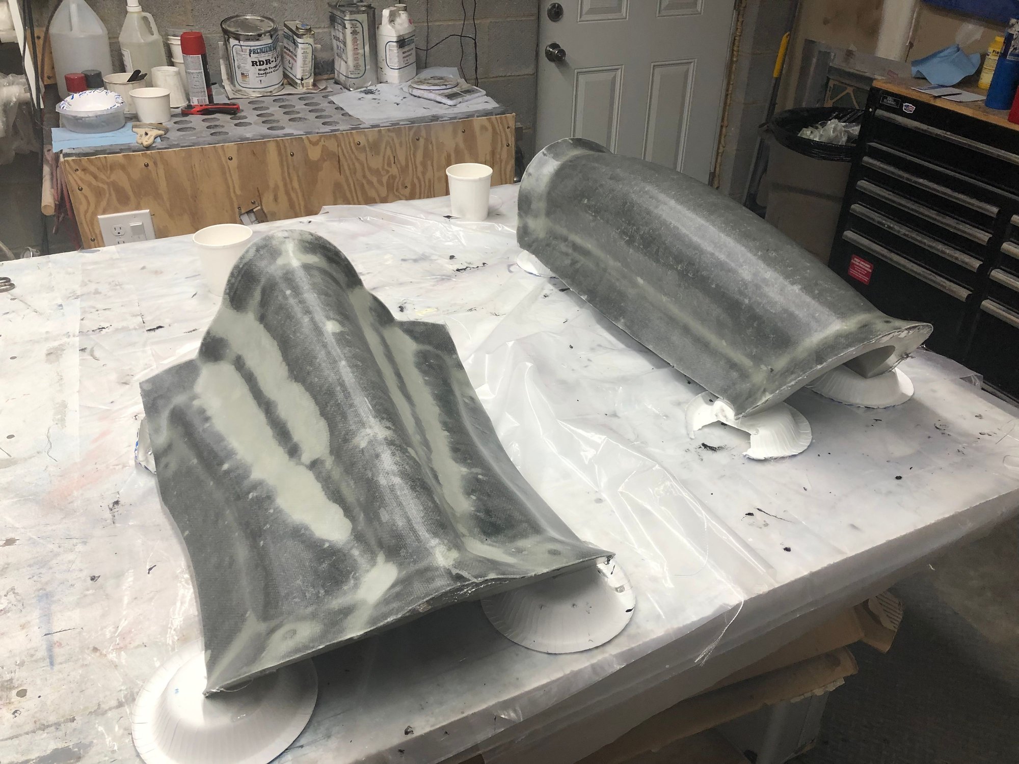

There has been substantial progress made the past few weeks.
The hatches and nose were parting planed off. The hatches getting 3D printed ones and the nose a combination of printed and laser cut white board material ones.
The hatch tops were then molded.
The hatch bottoms got a similar 3d printing parting planes. These parting plans are placed on the trim edge of the hatch flanges an will hopefully make it easier to trim the flanges consistently.
Next up, the fuselage top was molded. This was a nine hour layup from start to finish.
Two days later, it got rolled over, pva’d and then the bottom was molded.
