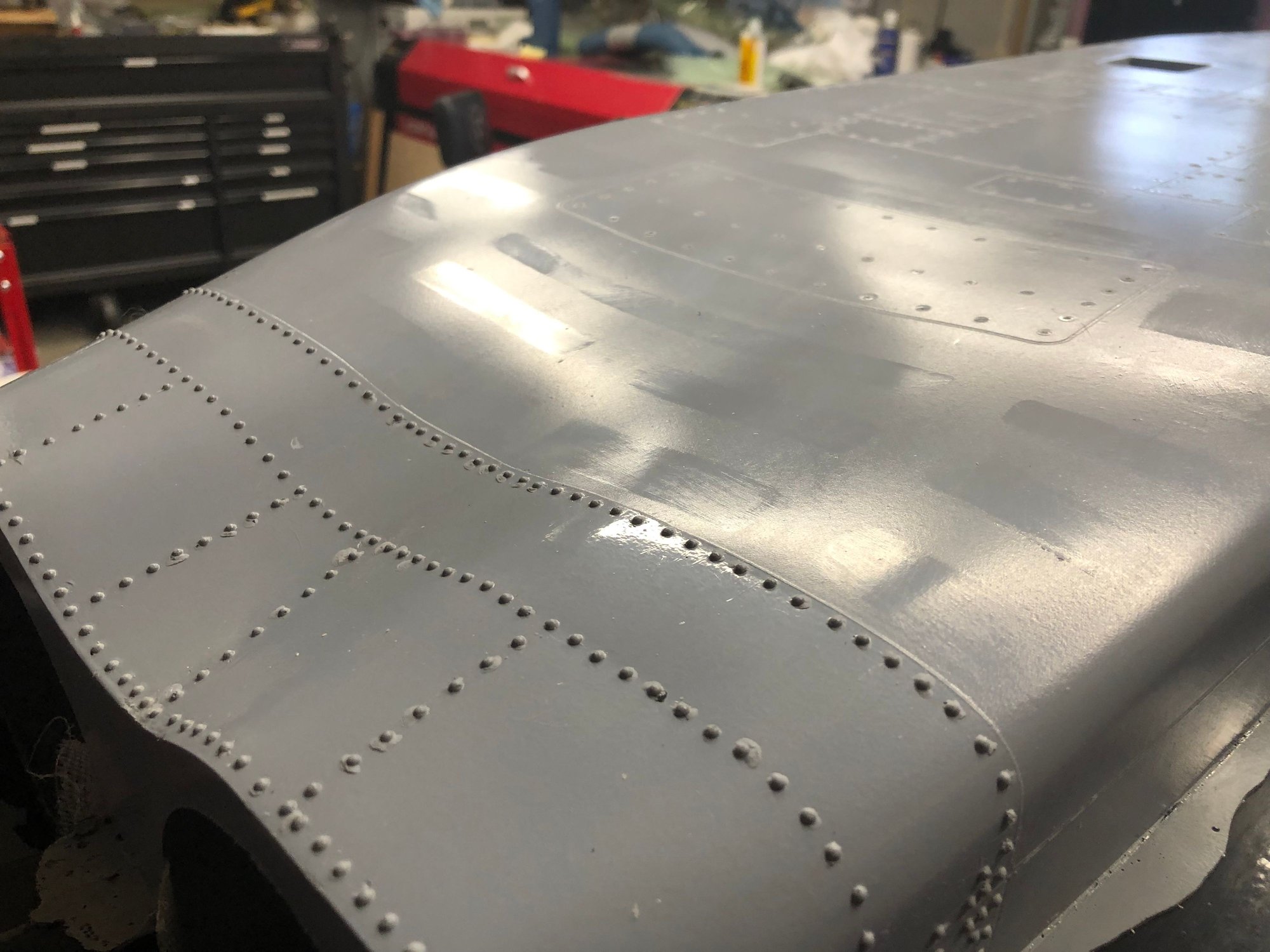

All of the airex, fiberglass, carbon fiber, peel ply, perforated plastic and bleeder layers are cut. The molds have also been cleaned, frekoted and primed. Tomorrow i plan to get the first of the main fuselage skins layed up. The plan is to get the first fuselage out of the mold sometime this week since all of the test structures look like they will be fine with minimal adjustment needed. I also got the inlet duct and bypass molds prep’d as well for another round of layups.

Posts have slowed down, but work has not. The first complete airframe is now out of the molds and its complete weight it 18lbs. The only items missing are the gear doors, speed brakes, exhaust nozzles and the cleae canopy pieces. The planned 20lb airframe weight should be easily obtained.

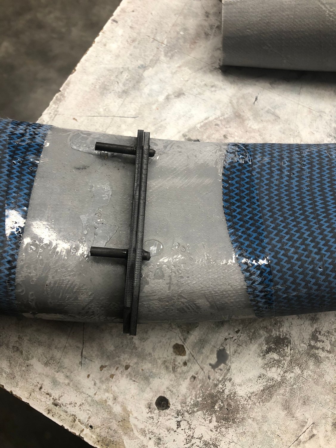

I was also able to get the mockup tailpipe into the fuselage. Unfortunately that will require a two piece inlet duct system, so i cadded up some bulkheads for that. These will be 3mm airex/carbon pieces and use some 3/16” pins to locate them together.

the two piece inlets are also done:
and the inlet ducts installed and rough shaped.
