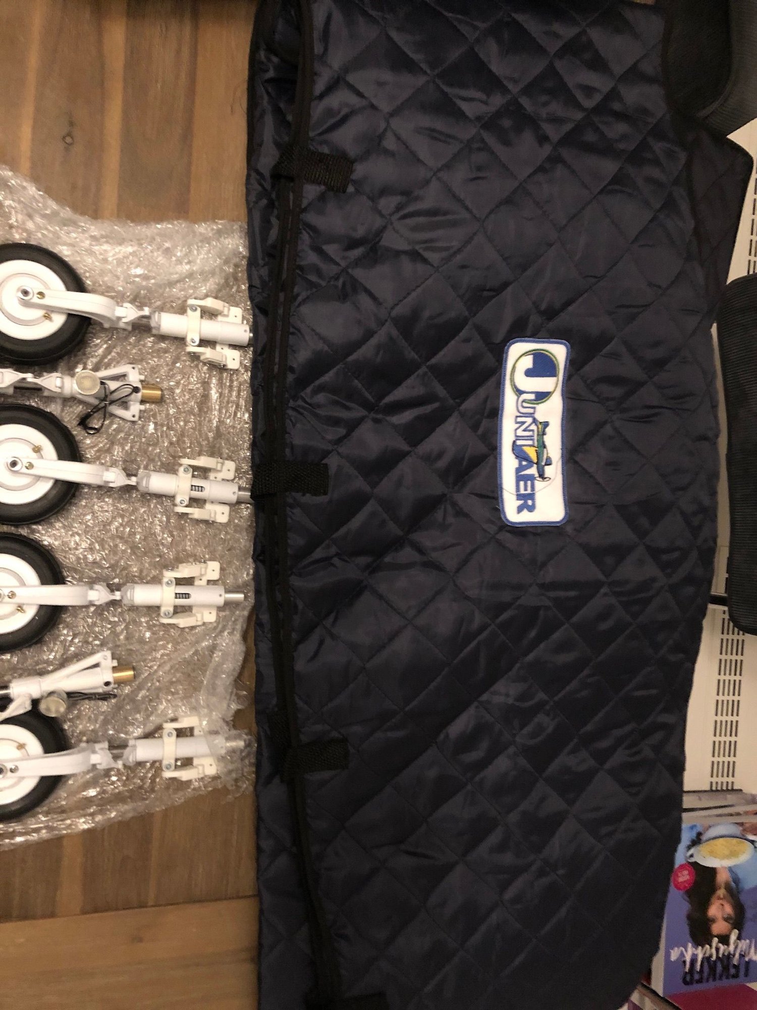

Is the factory gear dependable?? i like the electron conversion with the factory struts. Do the factory wheels have brakes??
Thx Vin

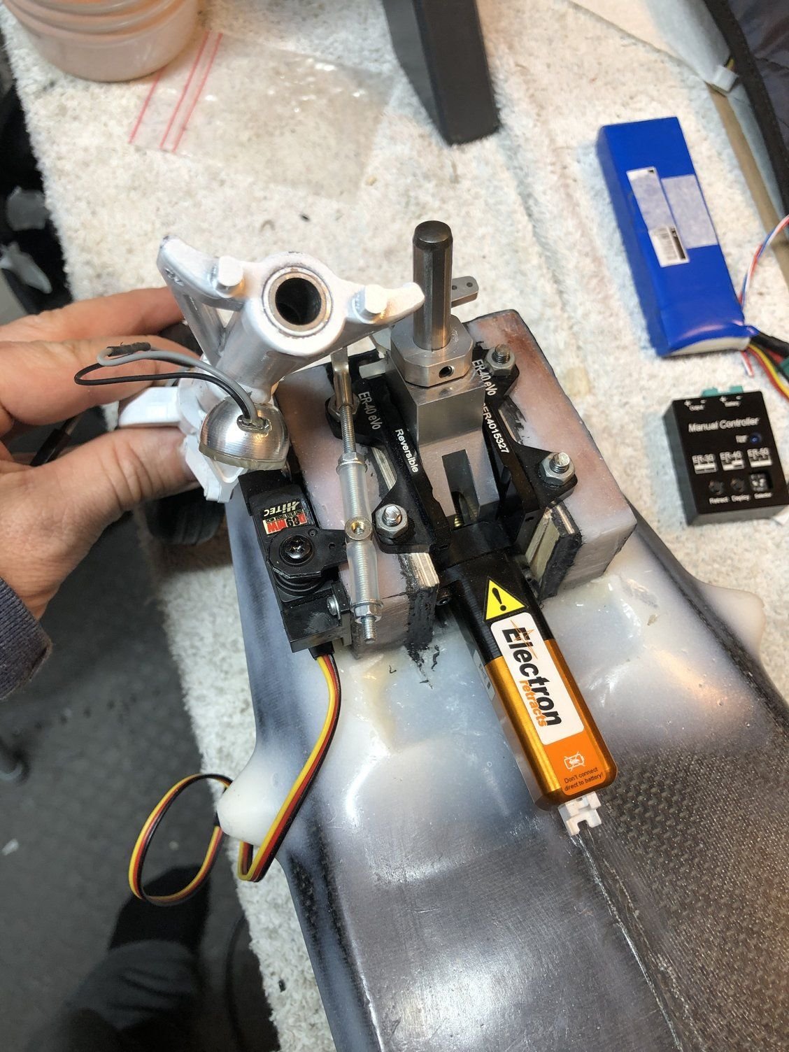

The factory wheels have pneumatic brakes. I did not like that as I have electron retracts. So I modify the brakes to make them electric
I am a big fan of electron elec gear too. Did you make an adaptor for the nose strut (8m-10mm) and how do the mains connect to the electron gear?? thx
Yes. I made a bushing 8-10 mm for the front retract. The front retract is 100 degrees travel.
The Trunion pin of the original main gear struts is 13mm. So I bought the ER40evo 13mm retract with 85 degrees travel.
‘Electron Has trunnions available in both 8 and 10mm swapping them is very easy....no need to make anything...

I see on the electron website they offer a 13mm pin so the factory struts should go right on.
The original strut is 13mm on mains, so the 13mm Trunion from electron fits perfect.
Due to the steering mechanism from electron, the Trunion for the nosewheel steering is 6 or 8 mm. The size for the connecting pin nose strut is 10mm. So I made a bushing outside 10 mm, inside 8 mm, so I could use the 8mm steering Trunion. I hope it make sense now.
