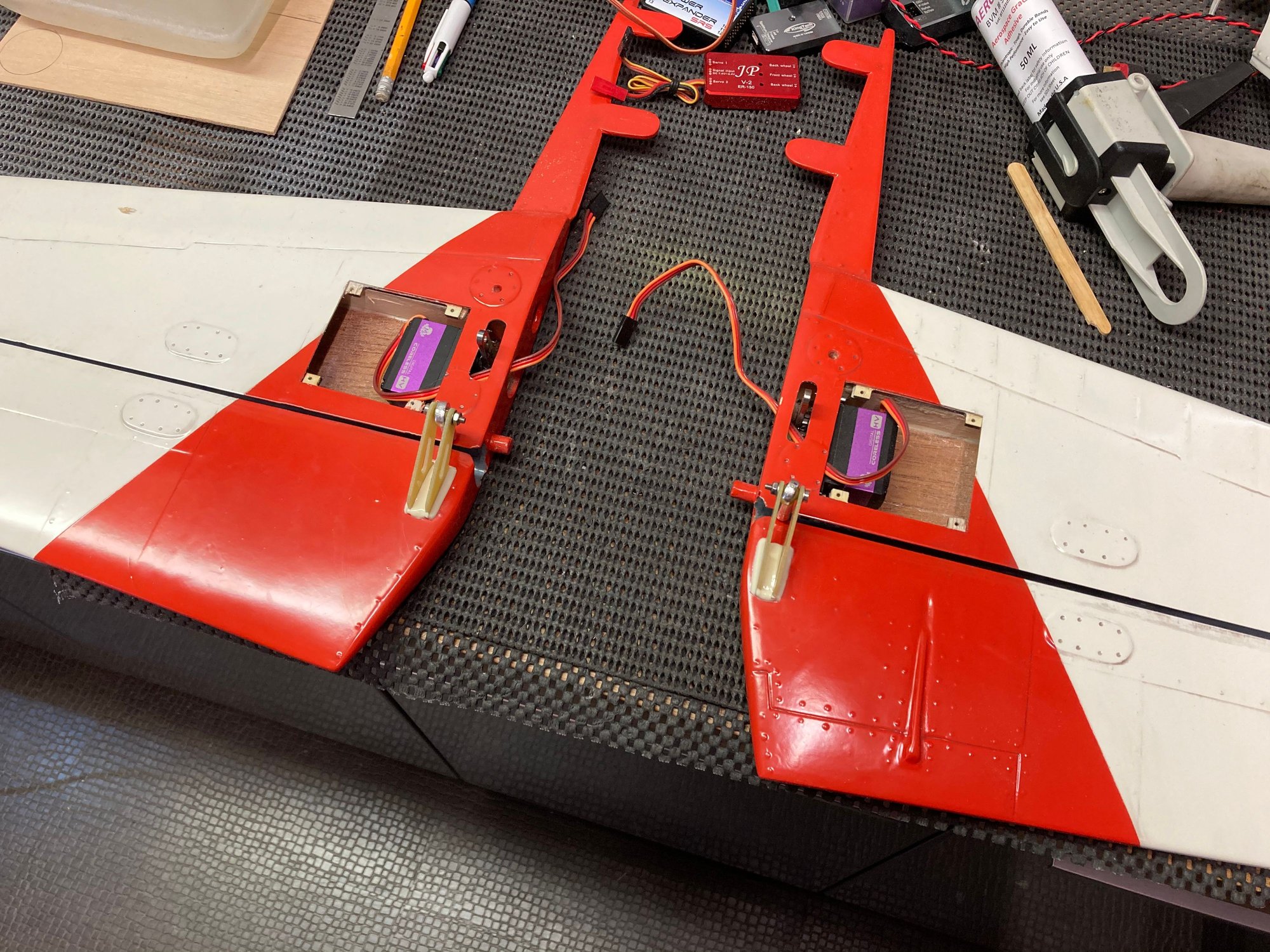

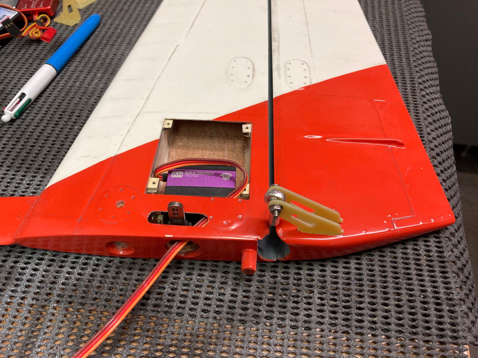

Modified rear servo hatch cut and a former to strengthen servo area
Former secured with Hysol
Servo secured on its side and hatch mounting splints added.
Rudder servo in the rear to provide extra space inside the fuz up front.
Elevator servos fitted.
Juniaer Modelismo (08-17-2020)
Old 08-16-2020, 07:53 AM
DUCMOZ
Join Date: Sep 2006
Location: , WA
Posts: 764
Received 9 Likes on 8 Posts
Looking goog Neil. I am currently working on mine. Done with the wings and working on stabs. My friend Dr. Scoles cut some carbon control horned for us and I used BVM flap horns for internal Flap servo assembly. I thought the original control horns are too big but they work. One thing we have noticed here is that the tail flexes a lot during the flight so we are adding a horizontal former on the skinny part of the tail to help. Mine will be electric as I couldn't bear the sound of the 50cc motor in a slick plane like this. Probably will order a TP soon as well.
Behzad

Thanks for the heads up on flex in the tail. Can you please share a photo of your added former.

Will do as soon as I get there. To explain, made of 1/4 balsa about 7" long going horizontally on the skinny / flat part of the fuse in the middle (under the tab cut outs for front section of the stabs). This is how we used to fix the flex on the late 80's early 90's pattern planes And worked great.

The factory has started to reinforce this area with carbon fiber. Perhaps yours is new enough. Bezad, mine and Mike Scoles are all older versions.
I did what Bezad suggested and it worked fine.
Paul
