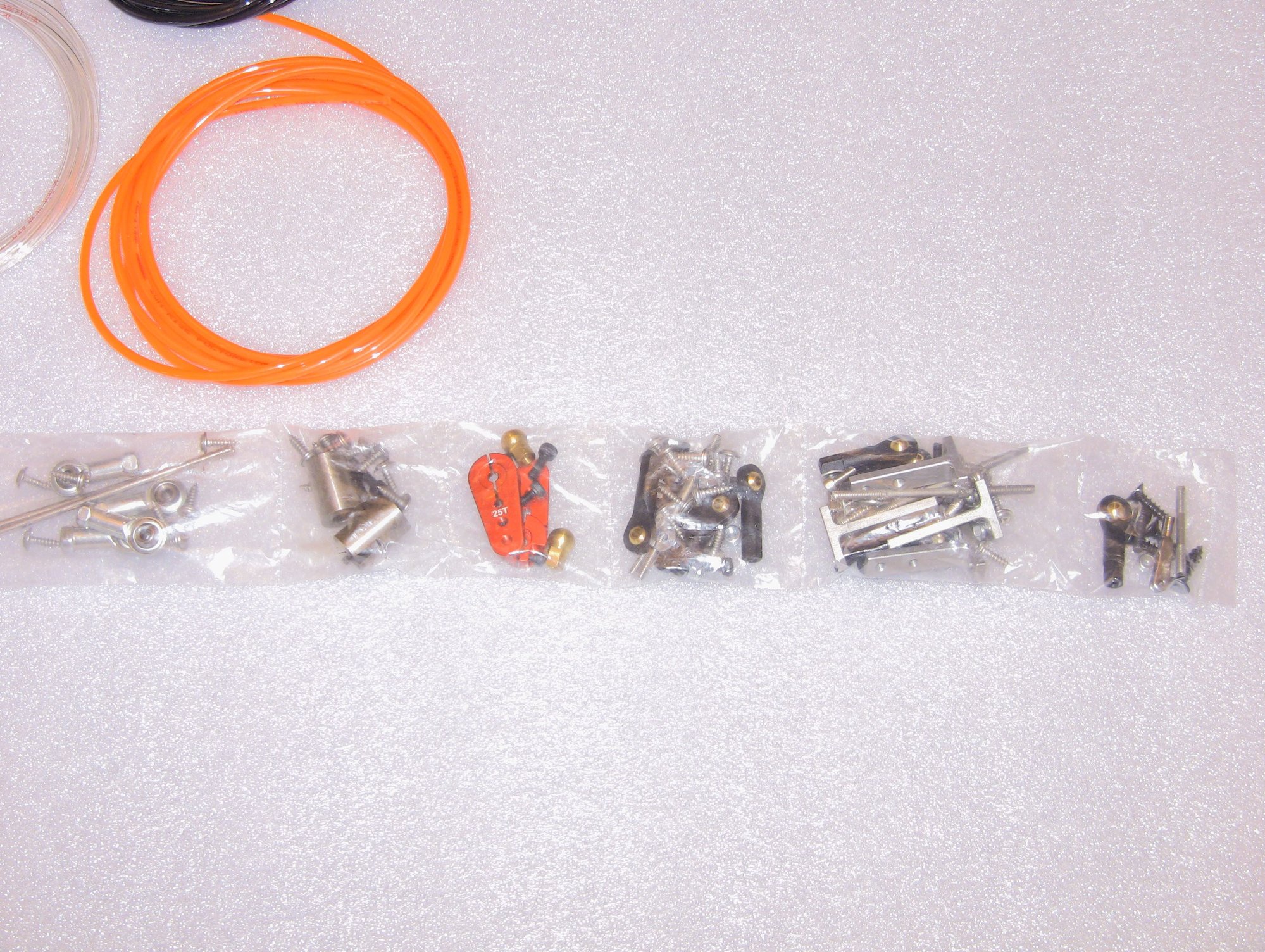

Lots of clear fuel line
The T fittings are really nice design and I use the quick disconnects in my Viper already
Servo arms for the stabs are beefy, nice rod ends with bearings, not a lot of hard ware really needed for the model

Before I head back out of town I wanted to ask questions and post the dreaded "The Good, The Bad and The Ugly!" haha not to worry much easier one to write this time.
So for the Good: #1 Great packaging, nothing was damaged!
#2 Great Quality, I have only found a couple small things I would have changed
#3 Good hardware that I would actually use!
#4 High quality gear and at first glance good air cylinders
#5 Great painting to include the bays and gear
#6 So much extra work done that saves time in building
#7 Good cockpit and quality, the seat looks a bit small but if you use a pilot I doubt you would notice.
#8 While I am biased and haven't used them yet the lights and controller seem nice! The Formation aka slime lights are awesome and the whole reason I didn't put my own brand in the jet
#9 Good fuel tanks, a little heavier but they are kevlar so that's normal
#10 Gear doors, bay doors, canopy, and all removable surfaces/hatches fit perfect!
#11 Seems to be a solid layup and weight is as low as it can be with these type of materials
#12 I like how the added inlet ducts through the model
#13 They are def true modellers, I say this because they are taking recommendations on improvements in a positive way and they implement the changes!
The dreaded BAD!
#1 So far I have found no manual of sorts, which is not uncommon and one of the reasons I do this but I cannot find anything like mounting the turbines servo setup, CG or controls throws. I think at a minimum this should be sent with the model when you buy it.
#2 Hollow carbon wing tubes, I am listing this because it worries me a bit and one wing has a bit of play. That being said if this design can handle the Gs of basic scale flying then Im okay with that they just seem a little thin. So I will like to hear from folks on this!
#3 They added a front tray in the nose but its glued in and will be very hard to mount things to if need be for CG. Would be nice to leave unglued if possible so easy mounts can be attacked before gluing it in.
#4 No washers on bolts going through wood bulkheads
#5 That's it for now not much so far
The Ugly!
#1 There are a few scale decals that are common to all F22s that would have been nice to see on the model
#2 Only putting this since I think they missed it on my scheme, shouldn't be a problem for all models. The canopy are the clear portion glues to was the wrong gray than the pictures I sent, it should be the same color as the base colors. Not a big deal still looks good and I could easily change this if I can match the color.
#3 A could door hinge mount locations have a bit more glue than needed, but I can clean this up with a dremel

I have another possible BAD
#5 The stab direct drive arm pins, I’m a bit worried about having just a brass pin moving a metal channel. This is a point of discussion but having to metals rubbing is going to cause wear which ultimately leads to play.
the brass pin looks like a ball arm on rc helicopter swashplate just bigger. I personally think this needs to be a bearing but I no engineer. So thoughts on this?

Got back home today and was looking at the stab drive design, seems like this is the same they have used on others. I have one local here I will be checking out that has some flights on it tomorrow so we will see how it holds up. Any thoughts from anyone who has one of these or any other model T-on makes with the same design would be useful. Cheers
Brass ball and what looks like aluminum insert.

Pretty sure the servo gears will wear out before that ball does.

If that was the case then all ball ends/rod ends would be metal on metal, gear mesh and a round surface rubbing back and forth on a flat surface are two different things. I don't know man, whats yours reason for saying that?

That ball only moves a little bit back and forth. I just donít see it wearing out very fast.
btw the skymaster 1/5 F16 Iím building has the same set up on the rudder and flapperons.
but letís say it does wear over time. I had almost 30 flights on mine with no signs of wear. So it should be able to do at least 100 flights you would thinkbefore replacement.
that part is probably pretty easy to change if it needs changing worst case scenario.

Yeah on a rudder I wouldnt have any issue but on the stab thats constantly moving just worries me a bit is all.

I think a dab of heavy duty grease on that would probably last 5+ years.
And with your preflight checks (I like to tug on all my surfaces before each flight, it’s on my check list!) you would notice slop building up in that linkage I’d bet.
