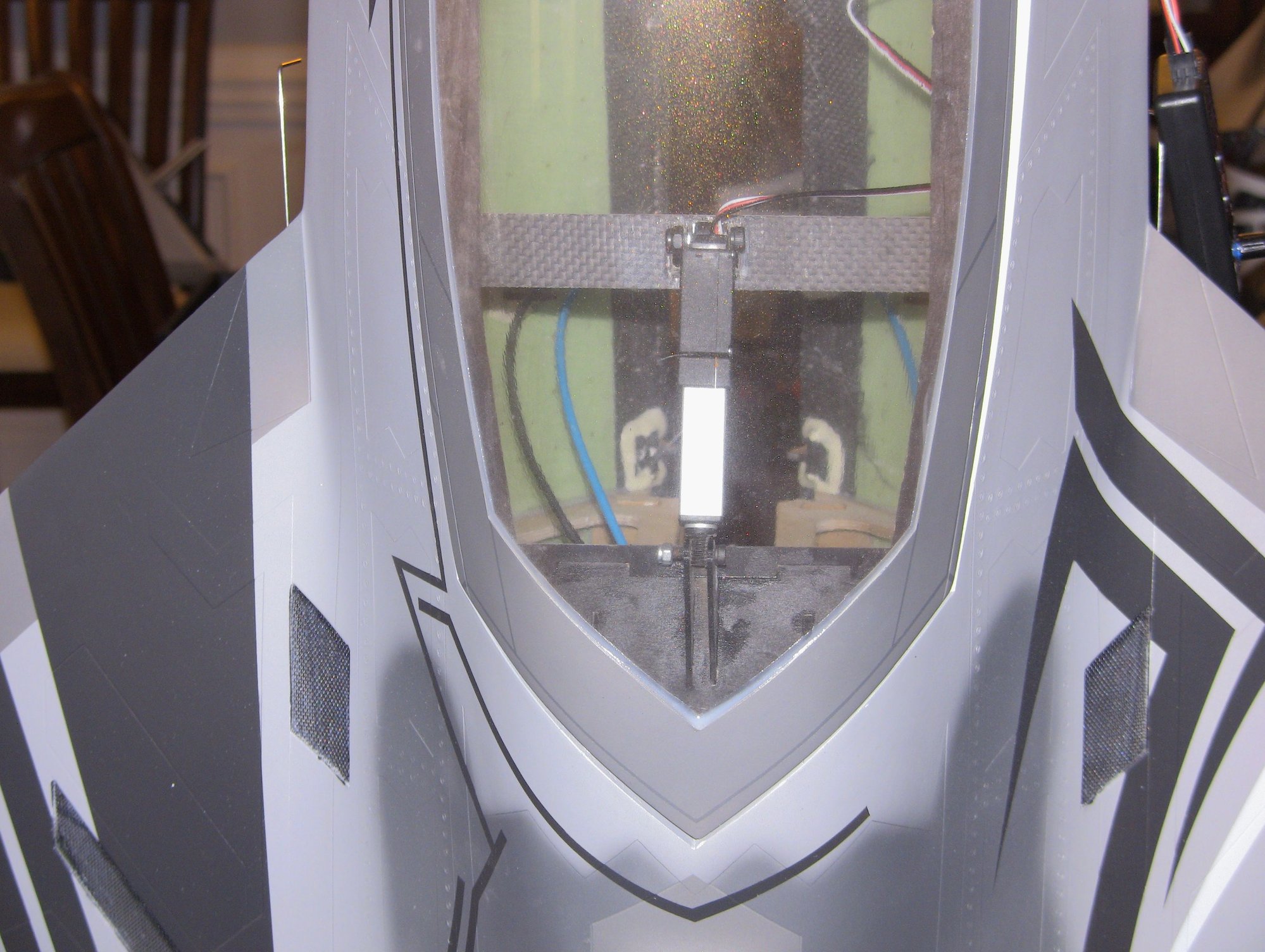

very little work today, I had a full day of other things getting in the way. I did switch gears a bit this evening and did the canopy open and close actuator. I simply removed the two tabs on the cross beam they installed for what I guess would have been an air cylinder, my kit was missing this but I planned to use my own setup. I added a 30 mm stroke Actuonix Linear servo, I have been using and selling these for a few years now. They are plug n play and work just like a regular servo and can be adjusted like servo via the radio. I went with the 210:1 gear ratio(18 lbs) since its a much higher torque but since it lifts real easy and not very heavy I may just use the 100:1 or even the 50:1. Lower ratio is faster but has less torque but the canopy has no force on the actuator once down a locked. The hinge needs a few mm removed from the rear part of the frame to allow for full extension, the amount open is very scale from the pictures I could find.
Sorry for the vertical picks, the jet was worked on while standing in the corner.
Oh and I will be removing the front air cylinder they glued to the canopy frame for a lock. I am going to use a 20mm stroke Linear actuator which very small, about the size of a micro servo.
Metal mount bracket, supplied with the actuator
Installed on cross beam
Actuonix 30mm Linear Actuator
BAM! on less valve and air leak to worry about!

Well today was another slow day the canopy install was a rough one, its hard to get the proper alignment to make the rear section clear while making the front align. When the installed bulkhead is off a hair it makes it much harder, but I got and in the pictures you will see two washers on the right side I used align the canopy. The linear servo works great and I am uploading a video going over the work so far.

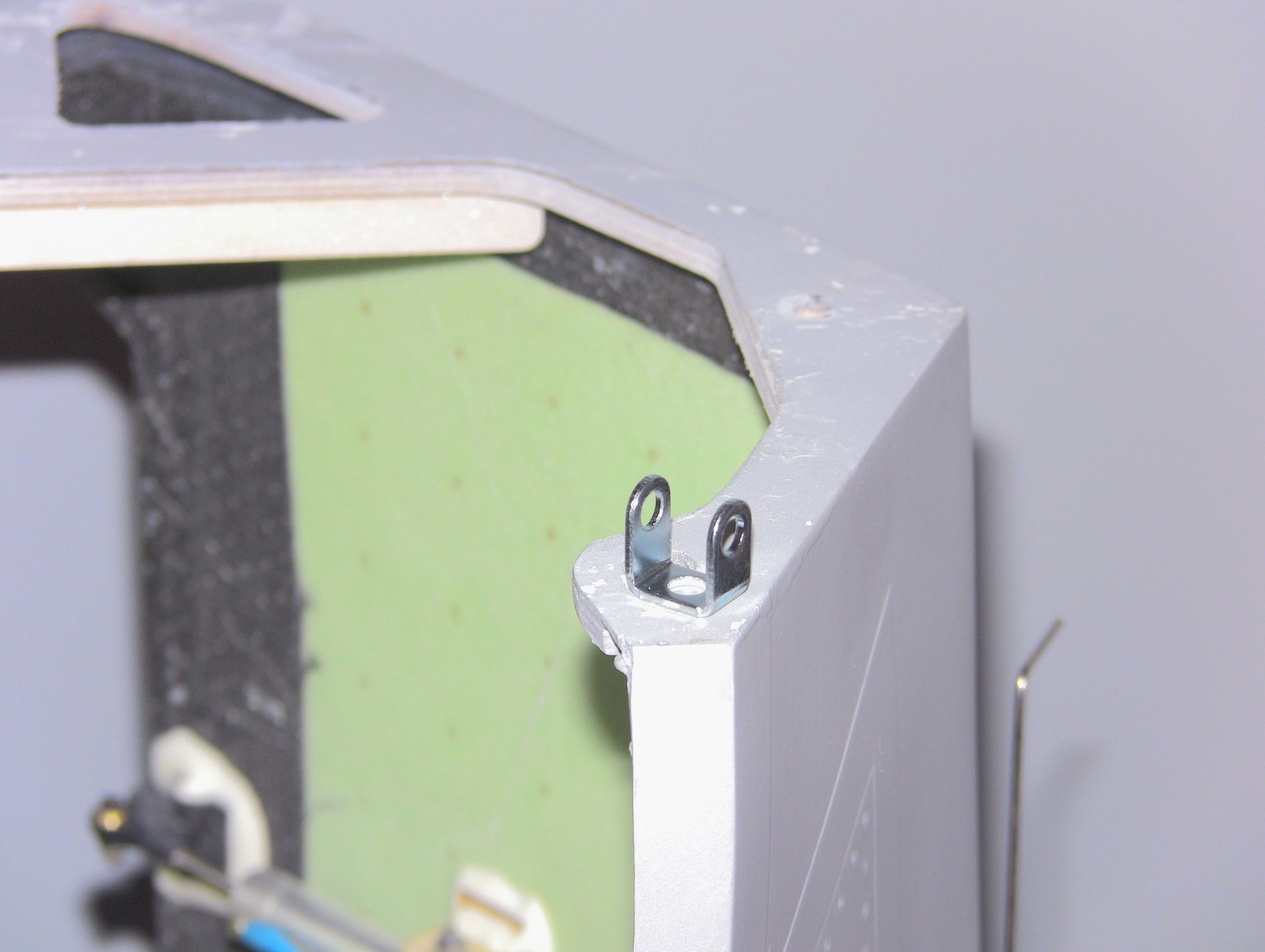

I removed the stock air cylinder lock and will be using a second Actuonix 30mm stroke actuator for the lock but mine will be mounted to the nose instead of the canopy.
I have been putting off the motor install just going to be a lot of trial and error so I skipped on to some easier things.
https://www.youtube.com/watch?v=gx2o...ature=youtu.be
This is the factory lock, I removed it and will add another Linear servo
Removed a small amount of material for clearance
PAIN in the but I spent all afternoon on four screws!
Closed
Open
All the required items for the nose steering
Completed, the factory had the light bracket on backwards scissors go aft by the way

Managed to get the motors installed, while not super hard but it takes some thought and based on your motor will be trial and error. I suggest watching the video explaining my method and if you have any questions let me know. Trying to explain what I did would take more than I would like to type.
Nose wheel is in as well, pretty simple I had to dremel some areas for clearance but nothing that shows when doors are closed.
I also made a small mount for the canopy lock actuator and its currently curing and once dry I will hysol the brass tube guides in the nose and canopy. Then the fun begins, the equipment and fuel system install!
