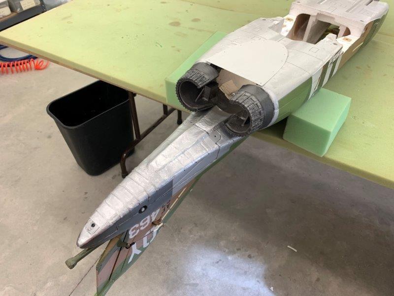

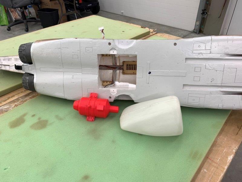

Freewing 90mm F-4 EDF Turbine Conversion
Many people have ask me to post photos of my F-4 turbine conversion using a K-45G3.
Here we go. Not all in the exact order but you can get the idea.
All credit here goes to Paul Appelbaum and his conversion design and his custom fuel tank. I followed his lead except for the tail mounted turbine. I used the same turbine mounting in the tail as I did on my first F-22 conversion.
First step was to get exact weight and CG from the EDF that I flew for several months with a HRB 6S 6000 mah battery. My CG was at 203mm from the LE with about 2.5 oz lead on the tail. The book CG was 190 which I found to be very nose heavy. The EDF weight was 8.55 lbs.
The next step was how to fit this stuff in the F-4 foamy. Answer...follow Paul's example.

Underwater tank test
Checking CG for turbine tail mount or mid mount with pipe. I elected to go with tail mount as the prediction only needed about 2.5 oz in the nose and saved me lots of money for a pipe.
Foam drill made from 1/4" brass tube sharpened on one end
G10 used under bolt head to keep from crushing the foam.

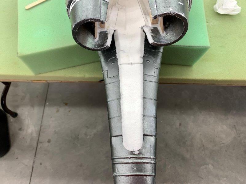

Posts: 2,423
Received 330 Likes on 217 Posts
FOD cover made from .010 G10 material
BVM heat blanket felt material glued to foam above turbine and aft of exhaust on bottom of tail
Heat blanket covered with aluminum HVAC tape
Ink removed from HVAC tape with acetone
Tape painted with silver acrylic craft paint I stole from wife's craft room.

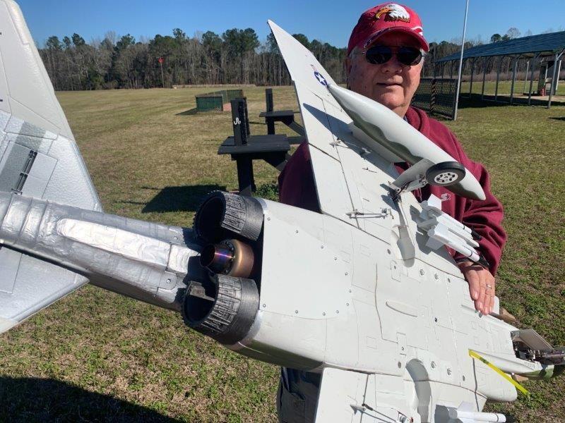

Final weight and balance being supervised by Pixie!
Stovepipe from hardware store to protect tail during turbine starting
Weight and balance with take off fuel and landing fuel and fuel system tests using pump test in ECU
Turbine run tests
Ready to fly!

After several flights no heat issues under tail at all. Nothing done to stabs.
New MAP 2 oz air trap
Tank marked in 200 ml increments to calibrate the CTU for fuel telemetry
Turbine filter installed vertical to avoid trapped air
Start pipe in use

Final weight was 8.55 lbs empty with 2.5 oz of lead on battery box. Take off weight is 10.9 lbs. Landing weight with 30% fuel remaining is 9.15 lbs. Landing weight CG is 86mm from main landing gear on the Xicoy CG machine which is 202 mm from the LE. The FW book CG is 190mm so I am 12 mm aft of the book setting and it lands very nice. Take of CG is 199 mm from LE. Rotation is nice and it does not jump off the ground. Control throws are standard. I have about 10% rudder to aileron mix with flaps down to assist with adverse yaw. I get 6-7 minutes flight time and land with about 30% fuel remaining. Overall it flies very nice. I keep the speed below 100mph similar to my max EDF speed and have had no problems. It will go much faster but I want to avoid a foam explosion.
Good luck. It makes foamy jets much more exciting.
