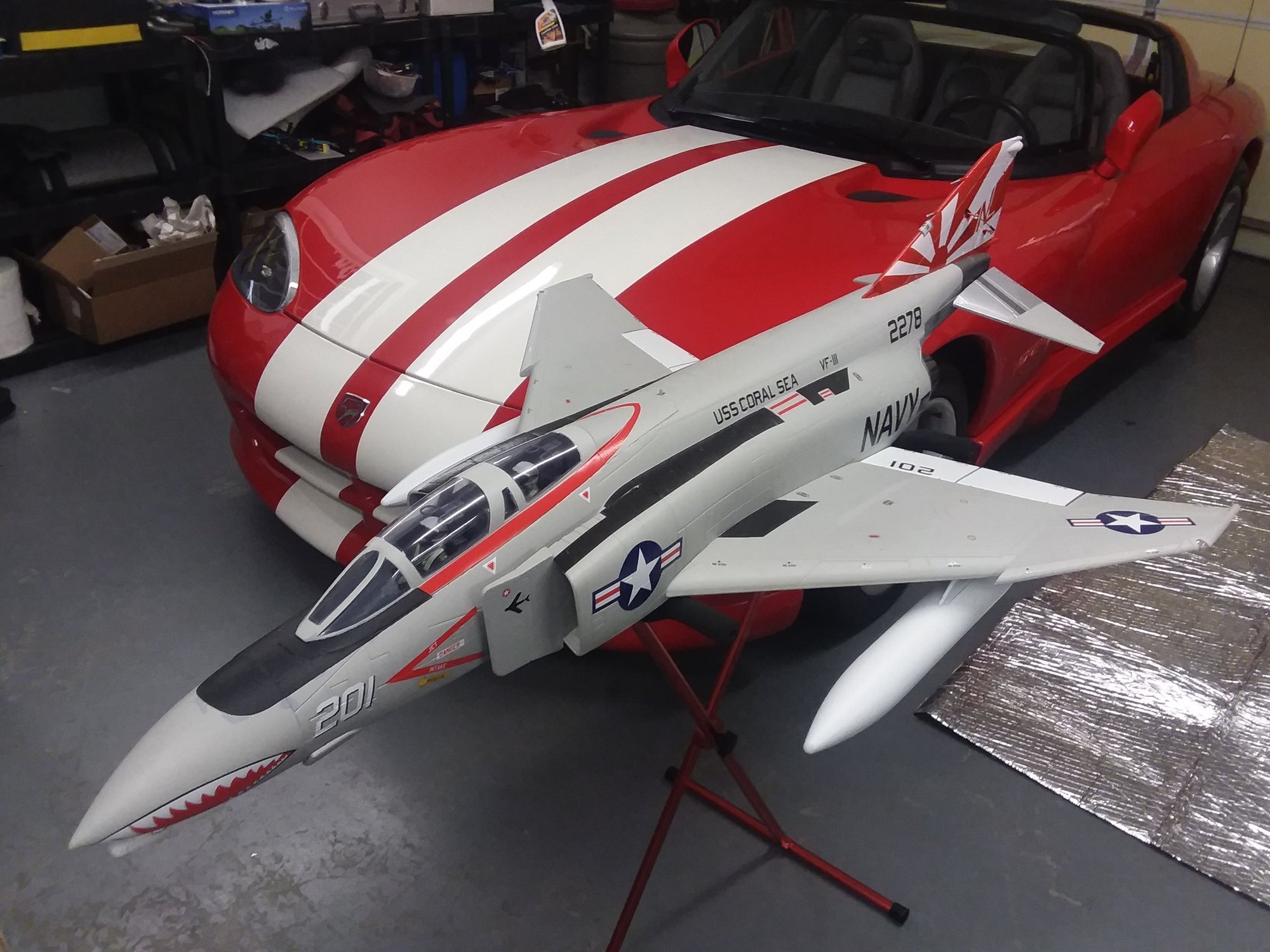

Viper1GJ and Tip22v,
I did the mod on my wheels/brakes but also added the AG63 Gyro Assisted Brake Controller that comes as standard equipment on AeroFoam turbine jets.
Take off rolls and braking after touch down are straight as an arrow regardless of speed . . . well worth the $.

By the way . . . the Viper does NOT have anti-skid protection, ABS, or traction control! LOL!

Greg is that the Eflight F4 with turbine?
BTW I dont think the wheel mod is needed with the AG63 controller.

This does not look like the EFlite F4, the EFlite F4 has a fiberglass fuse and built up wing, the F4 in this picture looks like foam. I’m guessing this is the Freewing F4.

My F-4 Phantom is the Freewing from Motion R/C in the Ghost Gray scheme and water slide decals that came with the ARF.
Flys very nice on 6S lipo but really want to get my K45G3 installed!

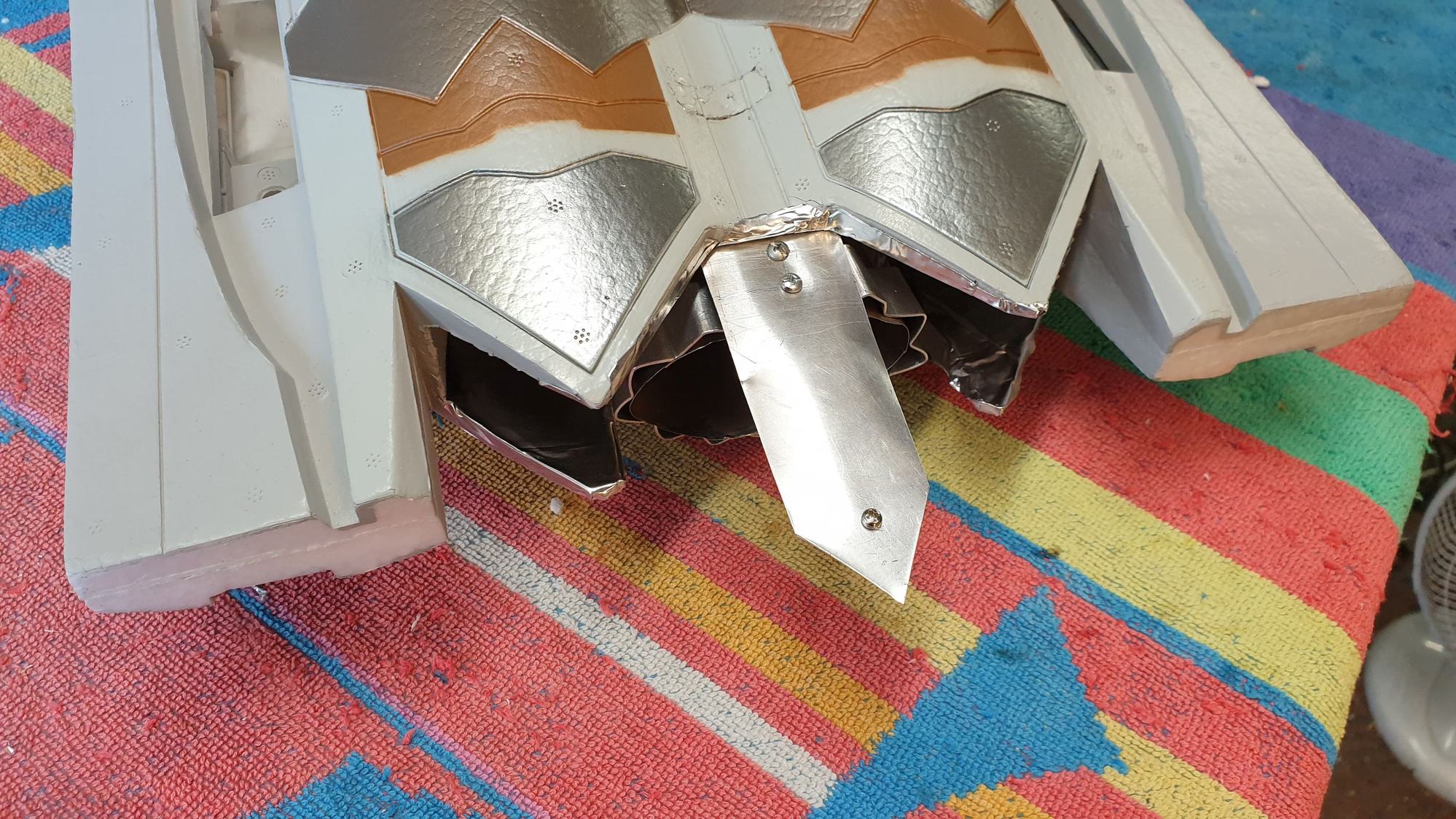

I finally picked up a Freewing F22 to do a turbine conversion and I had to decide on either a rear mount or a thrust tube and engine on the EDF mount. After some calculations, it worked out better to use a pipe, which I made myself and it only weights
Final tank position. Kitchen knife great for carving foam!
Centre duct clear, before lining with aluminium tape.
Duct is 55mm diverging to 60mm, then extension flattened to 70mm.
Oval outlet.
Turbine duct is mostly hidden from view plus engine is protected from FOD.
Could possibly make a better rear pipe cover, this one was just lying around!
75 grams. This is a very easy conversion, compared to others! My one litre tank fits underneath the spar, almost over the CG and I will be fitting centreburners either side of the pipe, for visual effect. Jet is not finished yet, but will balance without lead and a 3s LiPo 2200 in the nose cone, so may have to dial down the X45!!
Oval outlet.
Nice! I really like the pipe and the oval exit with the stinger. Should be a great flyer. Post photos of flights!
