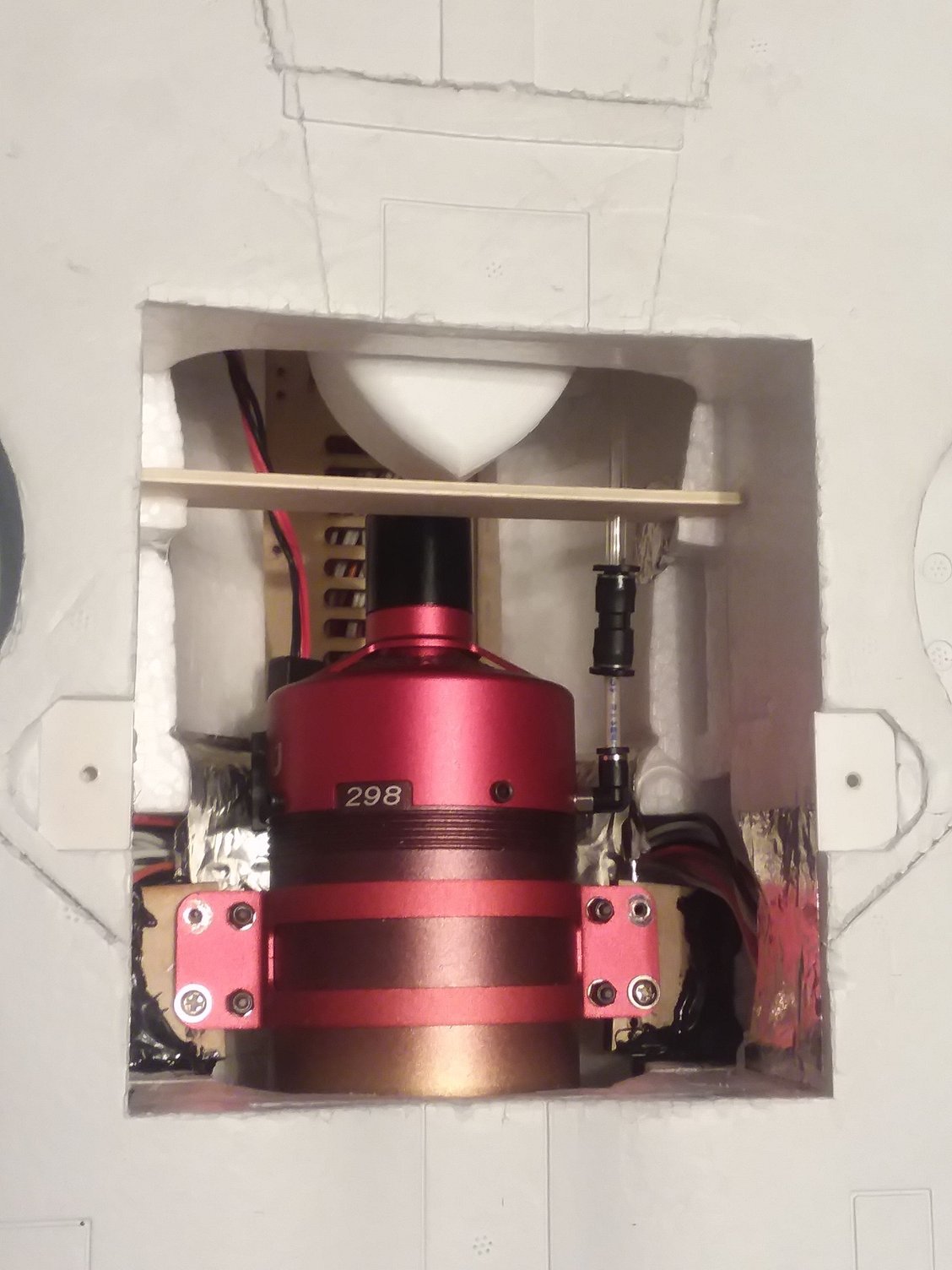

Progress on the Freewing F-4 Phantom! Just waiting on my cool little 28cm pipe from J.E.T. Pipes

Looking good Greg! Post pic of your pipe. Been wanting to see one of the small ones from Joey. Is that a Keith 3D tank?

I weighed the 6S power system (fan unit, motor, ESC, & wiring) and it came out to 1.35 lbs. the turbine sits in the same spot and only weighs 1.03 lbs

Carving this jet up was crazy.
Thankfully I only sliced through 1 servo wire . . . LOL!

More progress this evening
Love me some aluminum tape!
Weighed everything & I'm at 7.7 pounds without receiver battery.

Sorry to mention as i know you are not done but it is a good idea to safety wire all the tubes where they go over the nipples. Air bubbles would be deadly.

Thanks for the heads up Ducmoz . . . still have to make sure the C/G is going to be good once my pipe arrives (more than likely Monday).
I'm also going to get the solid on/off valve and fuel line reducers (6mm to 4mm and 4mm to 3mm).

All that's left is to install the pipe and the fuel tank hardware

Hi Greg, no problem. A successful turbine conversion means an additional jet pilot for our community. Now please also check your UAT. I have not seen that one before but I am mostly sure that the nipples need to be on the top and might cause issues if installed side ways. I am sure the supplier can help on that also.

Behzad,
The UAT is the same one Viper1GJ used in his Phantom (see post #47).
https://www.modelaviationproducts.co...-accessories/6
It is 2 oz. and since the fuel is fed to the pump from the very center of the unit, mounting orientation should not matter (vertical, horizontal, angled, etc.).

As long as you tilt the plane while filling to ensure the Uat is bubble free then you are correct regarding orientation.. .
optimum orientation is so that the nipples
are up iot evacuate all air out while filling

Pipe installed . . . it only weighs 3.4 oz 👍

Looks awesome! I have mounted that same UAT with a K30 in a Habu32 and it works fine on it's side. As someone said here though, make sure you tilt the airframe when you are fueling to make sure you get the air out of the UAT. Also, on your safety wire, you will want to make sure you wrap the wire around twice before twisting it, that way you have even contact all the way around the tube. Can't wait to see video of this one! - Tom

I flew her three times on Saturday adjusting the CG back after the first flight.
Second of all, it turns out my pipe was too close to the turbine and was not producing full thrust at max RPM.
Also I'm going to have to trim off some of the back of the fuel cell so I can slide it further aft . . . more centered over the CG.
We should be golden after that!
