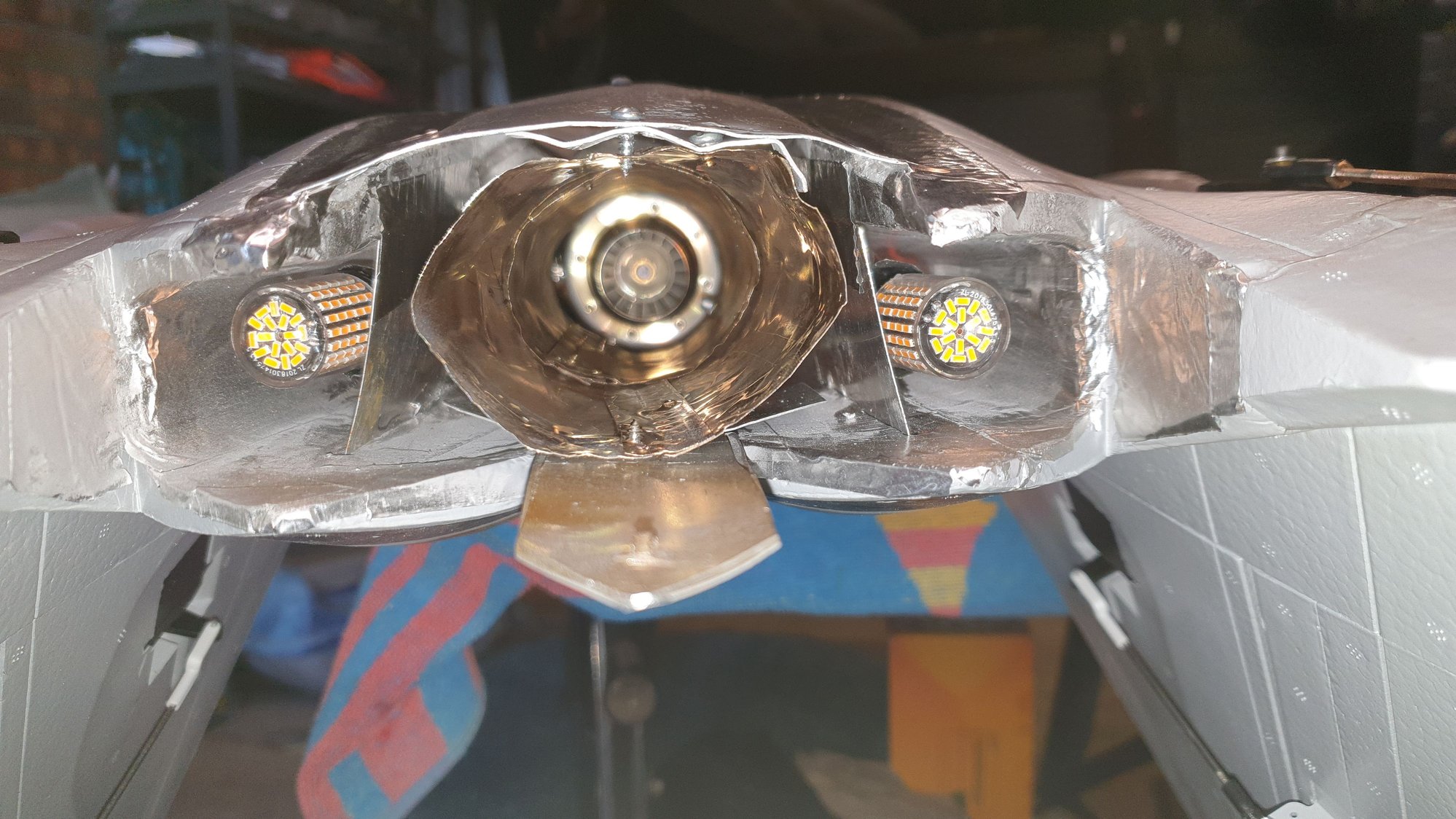

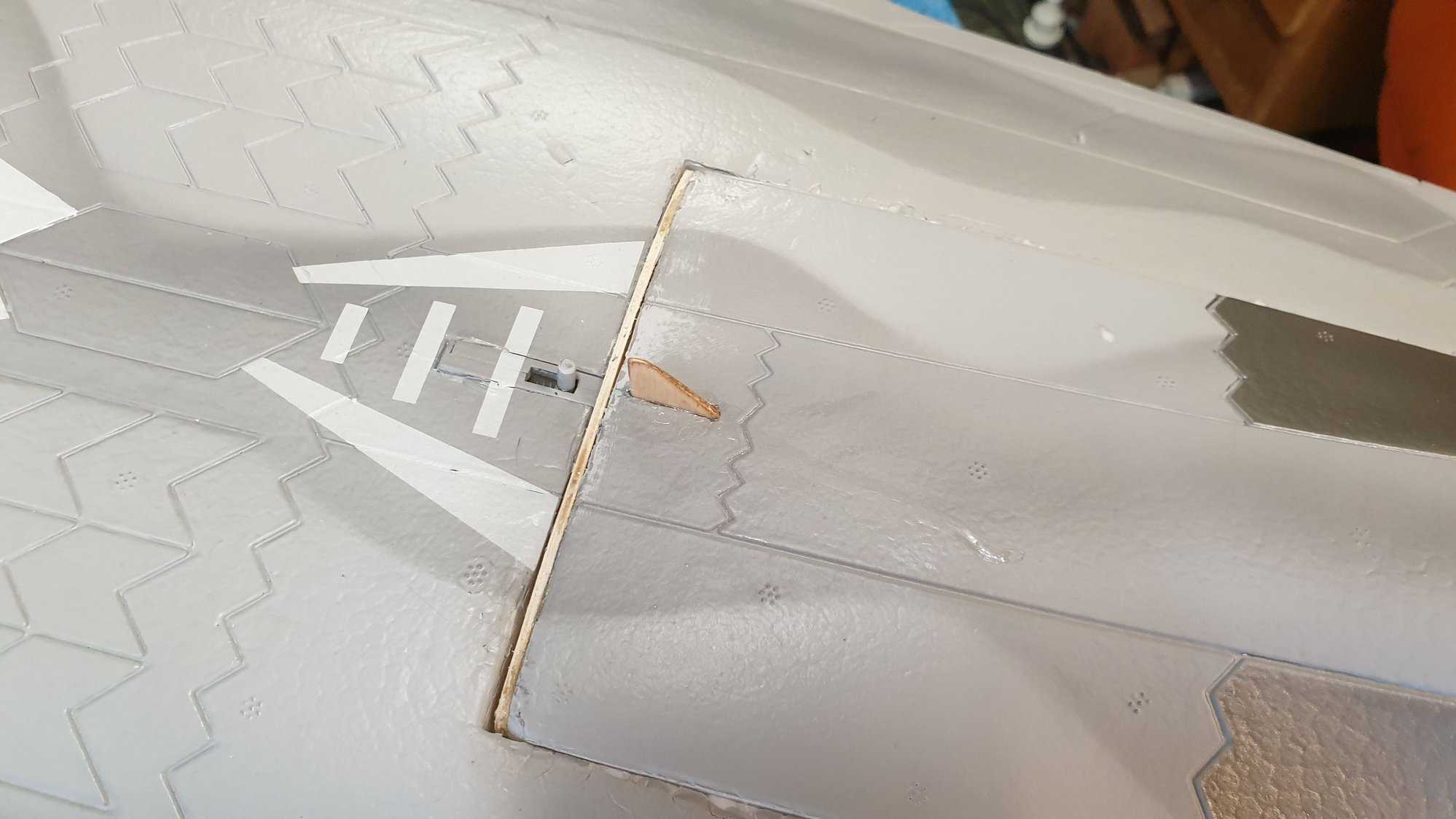

Guys, I now have about 12 flights on my F22/X45 turbine conversion and it is now one of my favourites! I have strengthened the stab linkages as well as statically balanced them, which appears to have made a massive difference in accuracy in how it flys. The after-burner lights are a big success and extremely bright in flight plus I sealed the two cheater holes over and put the fuel vent out the side of the fuselage which avoids sucking in gunk while on the ground. Here are some pictures of these mods and a couple of videos.
Ply facia to strengthen the canopy latch. Also fitted a bit of ply so as to lift off the canopy easily.
Solid 4mm rod stab connectors.
Thin aluminium protecting the lights from mt thrust tube.
I removed the milled aluminium EDF motor mounts from the lights.

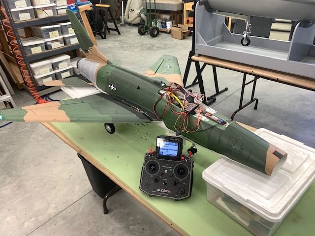

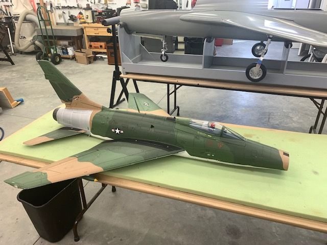

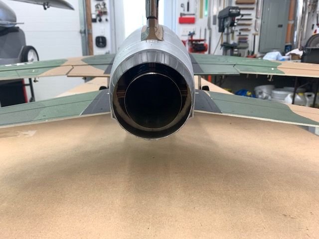

Flex F-100D with K-45 conversion
This Flex F-100 was converted by my friend Keith and flown 19 times with a K-45 before I got it from him last week. It was a very easy conversion since Keith had already done all the hard work with the tank, pipe, turbine mounts and battery location.
The turbine mounts to the original EDF fan mounts. Keith used a single wall pipe with no bell. Aluminum tape was use to shield the foam from any heat around the turbine hot section and pipe.
Keith 3D printed a the 1.2L / 40 oz. tank. It rises up into the air intake tunnel. The leading edge of the tank is tapered toward the front to provide a smooth air splitter in the intake tunnel. There is plenty of space on either side of the tank for air to get to the turbine.
It was a fairly easy job to mount and hook up everything. It was another task altogether to stuff it all in the space available. Since the air tunnel goes right under the cockpit hatch there is no a lot of depth under the canopy.
I finally got everything updated and stuffed in. I did have an extra piece to fit in since I like using a CTU for turbine telemetry.
The top front of the fuel tank is about 1" behind the pump and air trap tank. Left of the pump is a small cavity that I used to stuff excess wires into. The ECU is below the filter and fuel valve. The Jeti gyro receiver and CTU are in front of the ECU and battery is in a carve out in front.
The air trap tank is a 3D printed design by Keith that serves as a mount for the K-45 pump and allows the 2 parts to be stacked to save space.
Tail pipe is supported by 4 plywood tabs at 12, 3, 6, and 9 o'clock positions
Keith had 1.75 oz of strip weights in the nose to get a CG that was 12 mm behind the factory position. My CG with 25% fuel in the tank was exactly the same.
Jet looks good. It has a nose high pitch attitude sitting on the ground which should make take off easy. Empty weight with air trap full is 7.7 lbs. Full take off weight is 9.7 lbs. Landing weight with 25% fuel remaining is 8.2 lbs.
Ready for turbine test run, range check, and taxi test. Hope to fly next week if weather permits.

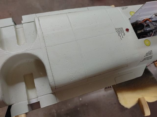

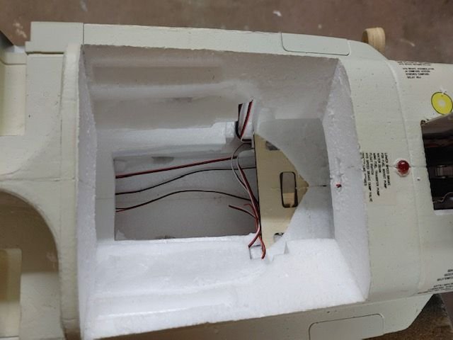

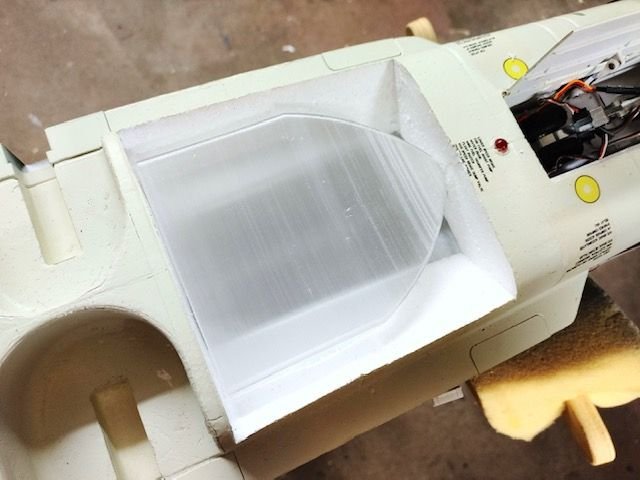

3D printed fuel tank for Flex F-100
These photos are pictures Keith made during his conversion of the F-100.
Screen shot of the CAD tank design
The tank is printed with PETG plastic (plastic soda bottle material). It hold 1.2 L or about 40 oz. Note the pointed shape that faces forward inside the air intake tunnel. The tank is shown here just off the 3D printer and ready for epoxy coating inside and out. West Systems epoxy was used inside and out to seal any possible pin holes from printing.
The bottom hatch is cut out of the fuse with a draft angle to keep it from falling in when replaced. The top of the air tunnel is cut out to received the top of the tank (bottom of photo)
Tank is inserted in fuse. Keith glued wood mounts under the edge of the tank and glued some mounting rails to the sides of the tank. Screws hold the tank in place using the side mounting rails.
Foam hatch is replaced to cover the tank.

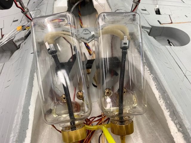

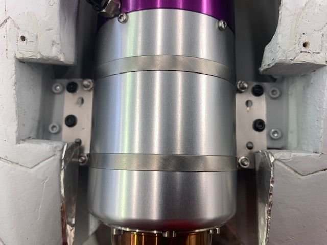

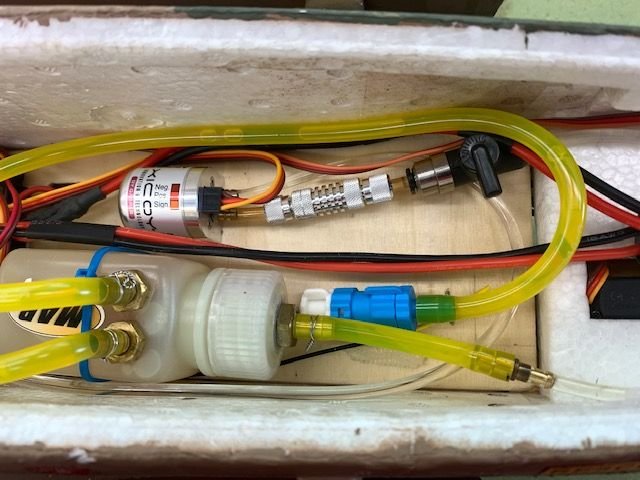

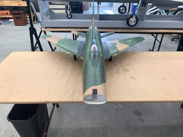

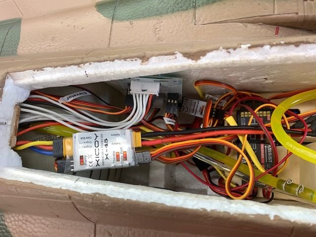

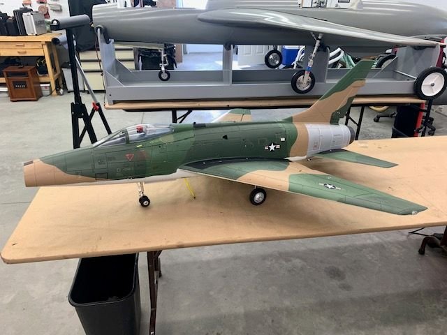

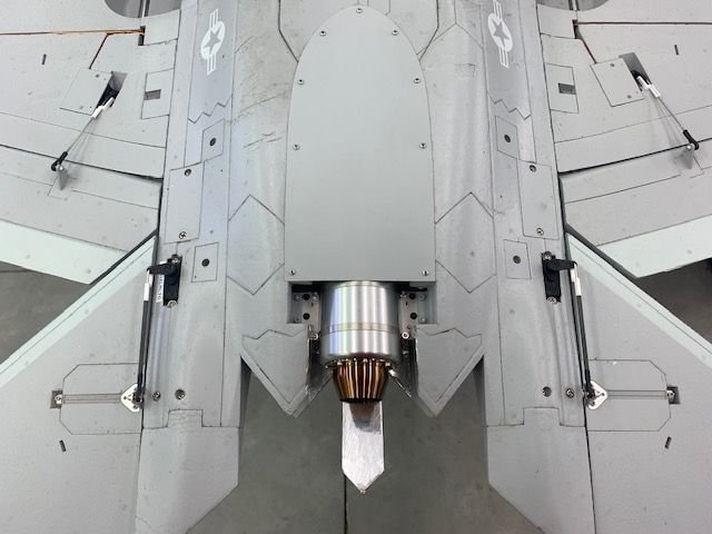

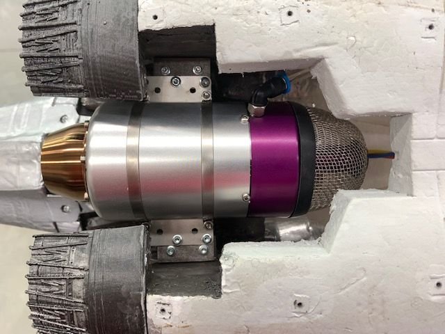

Turbine change in FW F-22
This is the same F-22 jet that I posted the turbine conversion for back in 2019 in post #15 above. A couple of months ago I had opportunity to sell 2 of my K-45s and I replaced them with X-45s. I finally got time to install the X-45s. Above is he weight and balance after the install. I switched from a 3S LiFe to a 2S LiPo so the battery in the nose was lighter. I had to add 2.5 oz of weight in the nose to keep the same CG. The X-45 started and runs great. I like it better than the K-45. The X-45 on my FW Mig-29 seems quieter than the K-45 and that's nice. I don't like the telemetry display on the Jeti screen but the Xicoy software will not work with a DIgitech CTU so everything is displayed on the Jeti screen in square boxes instead of the nice CTU engine display page. Also the temp is in F not C which is weird and different. Setting the pump factor requires public math and is a PIA compared to the Digitech CTU but it can be done. For the part that really counts, I think I like it better than the K-45 especially if I can start using just one type fuel for all my turbines. The K-45 used kero only. This one will use kero or diesel and is selectable but I haven't tried that yet.
Pump install was simple. The pump is smaller than the KT and takes up less space. The manual explicitly says nothing between the pump and turbine so valve and filter are in front of the pump. The Digitech SB-IAS module is where the CTU was.
The X-45 "Lite" data hub is just above the front of the tanks. Data cable length is not long enough to get it in the front but the hub is small and light and can go almost anywhere with no problems.
Dual 500ml tanks with winged felt clunks pulled up for fitting data cable and fuel line to turbine
The X-45 mounting wings are more narrow than the K-45 but it fit right in the same hole.
The X-45 holes lined up with the edges of the K-45 mount so I capped and epoxied on the old mount a piece of 1/16" G10 material to extend the mount surface inward.
I epoxied a piece of 1/4" ply to the inside of the existing mount to give the X-45 screws something to grip into.
FOD shield repainted and installed. Test runs good. Ready to fly.

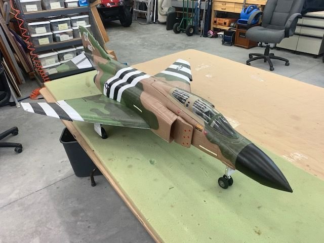

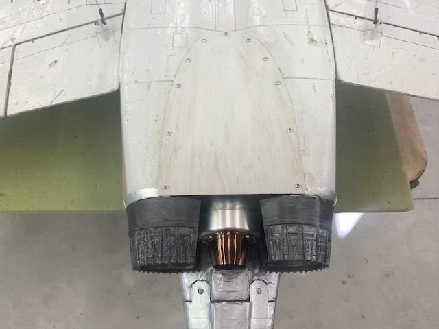

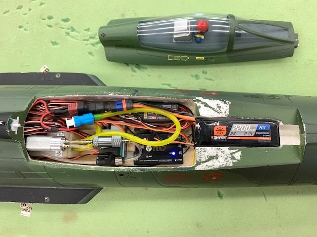

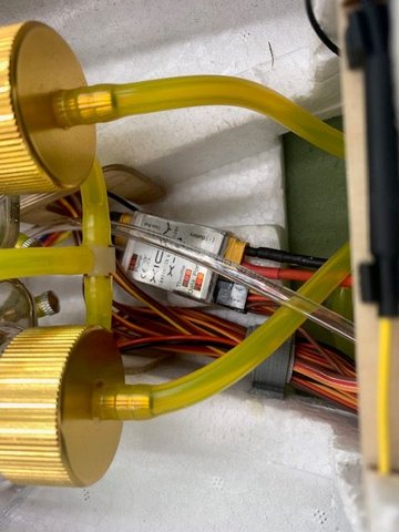

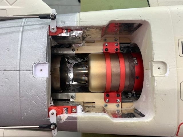

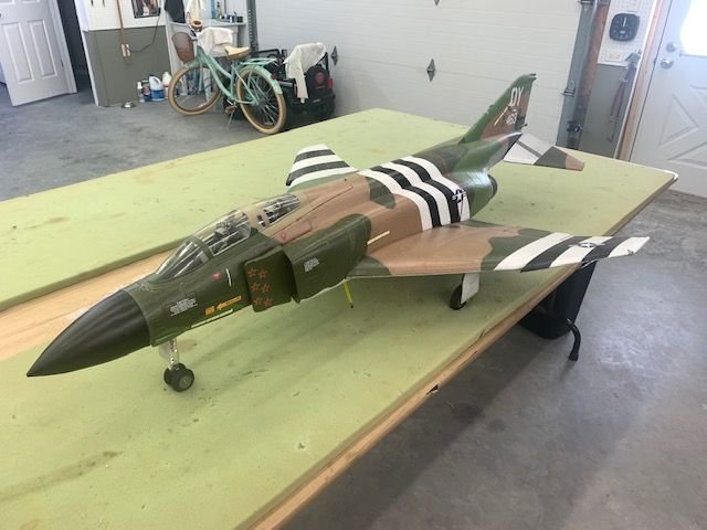

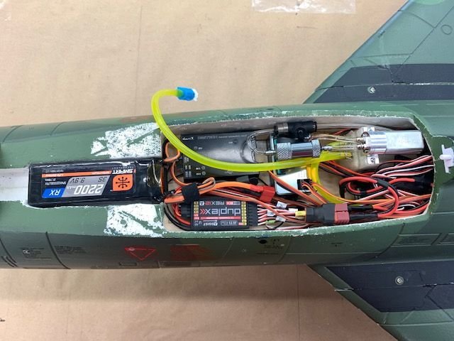

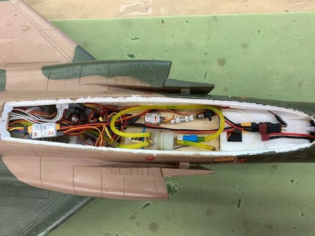

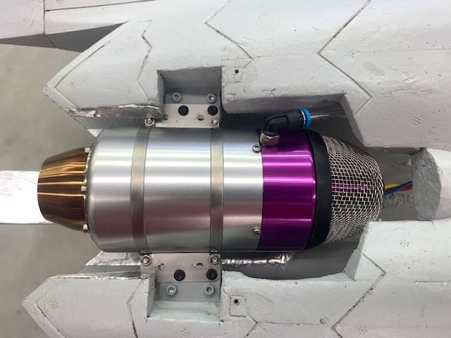

Turbine change in FW F-4
This is the FW F-4 I converted to a K-45 turbine in post #38 above. I had already flown it with my first X-45 so the turbine and pump mounts were already modified. I when I sold the K-45 in my Mig-29 I removed the X-45 from this F-4 and it sat with no turbine for a while. This X-45 install was pretty simple.
The X-45 holes are once again inside the K-45 holes. The old screws hold down the mount cap plate that extends the mount inward to catch the X-45 screws. No other mods were necessary.
Plywood epoxied inside the mount to give the X-45 screws some wood to grip to. Down thrust is already built into the mounts.
The "Lite" data hub extends into the cockpit area and is easy to get to.
Pump mounts to the equipment tray and the fuel valve and filter are installed prior to the pump as per Xicoy instructions.
A new Xicoy brake controller was installed under the board. It works much better than the JP brake controller.
FOD shield installed over turbine
Two starts and runups were made and the turbine runs great. CG was already adjusted to compensate for the lighter battery so this one is ready to fly again. I really like the X-45 turbines. I just wish the telemetry data on the Jeti screen was presented as jet engine display, the pump factor for fuel calculations was easier, and the temp was in degrees C. It's a shame to have such an excellent turbine saddled with clunky display software.
