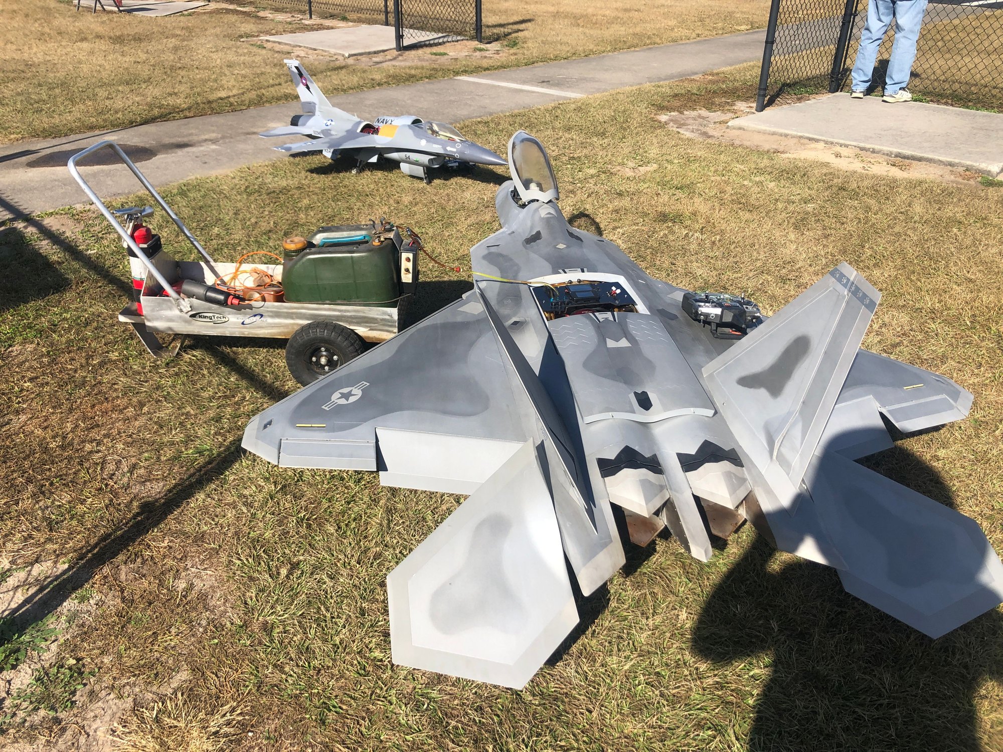

4 more flights on the raptor yesterday! She is really flying nice. Filling out my TopGun paper work today. Going to enter the F22 in the expert class so she will get static judging.
will start getting my paper work together and getting her detailed up.
still trying to pick the best takeoff with or without flaps. Right now im thinking I like no flaps takeoffs.

She looks like a big-girl next to that F-16.
Old 12-07-2020, 11:45 AM
  #247
gunradd
gunradd's Avatar
Join Date: Aug 2008
Location: Springhill, FL
Posts: 3,425
Received 50 Likes on 43 Posts
She has a bit of a drinking problem lol. I've been putting lots of fuel through her lately.
