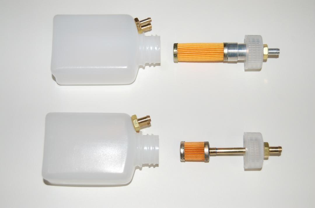

Quick question....I assume on a Nalgene bottle air trap (ie MAP, etc) that either of the top nipples can be used for fill or feed from tank? Seems like It shouldn’t matter, but want to verify. Thanks!

On that one yes. Either can be used.
On the high flow ones there will be one big and one small nipple. Small is for fill.

I'm running a 140 and I got an air trap like the one on your picture, not a single problem in about 3 hrs of use, we learned some time ago that if you go above 140 then a bigger/diferent air trap should be use.
Tygon fuel line can be use on the fill side, I also wrap a turn of the white Teflon tape around the neck to aid the cap to seal since the bottles expand and contract when been fuel or de-fuel.

The Hi flow has a smaller fitting for the the fill line. Standard like that’s both are the same.

To be 100% clear, the High Flow has bigger feed fittings (from and to) the fill is the same size fitting as the standard size.

Now John has introduced the new replaceable larger filter they are another step above everything else. The surface area of the pleated pick up was already 30% higher than the plain cylindrical type, the new ones are double the area-and they unscrew for replacement.
