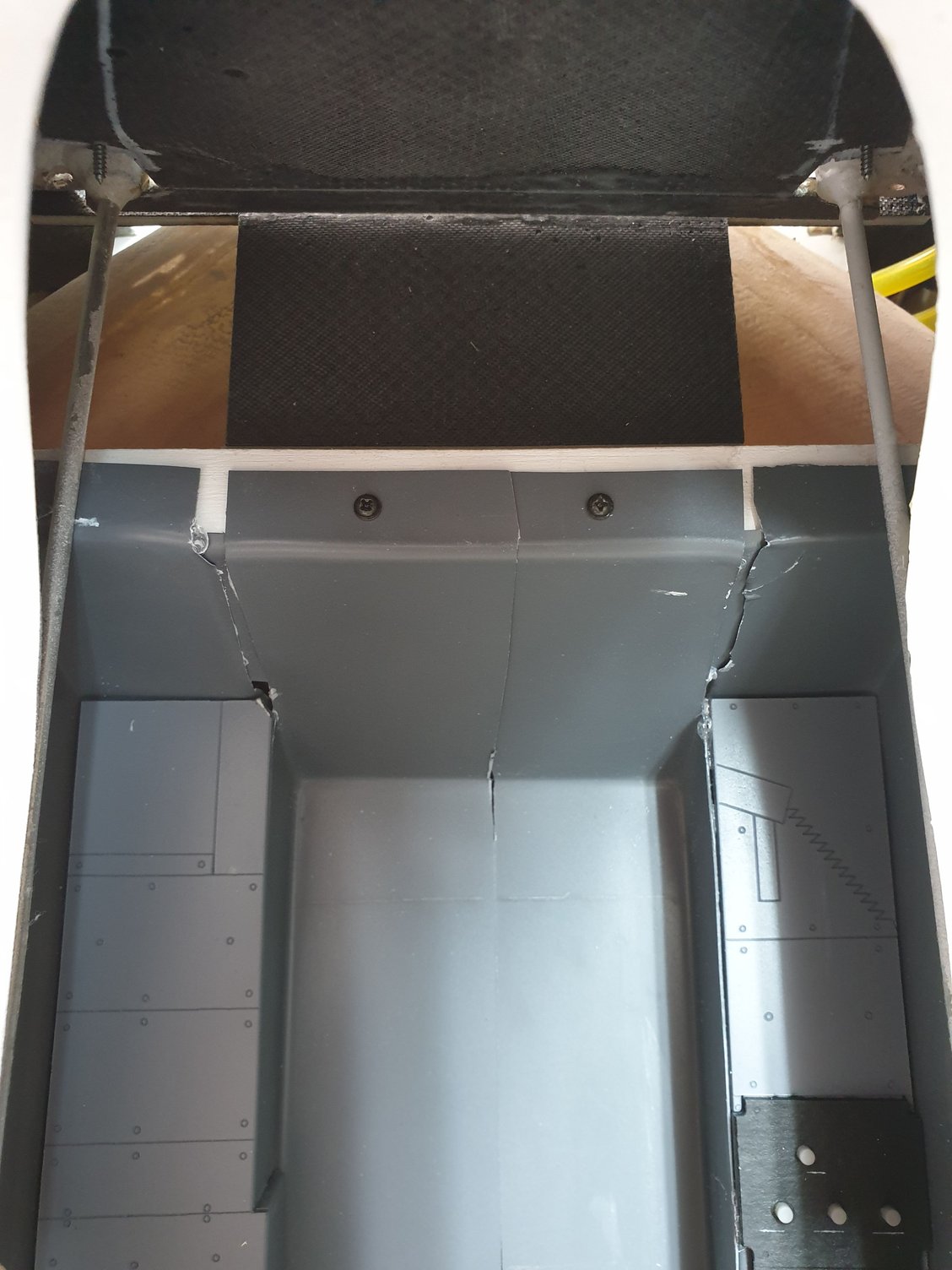

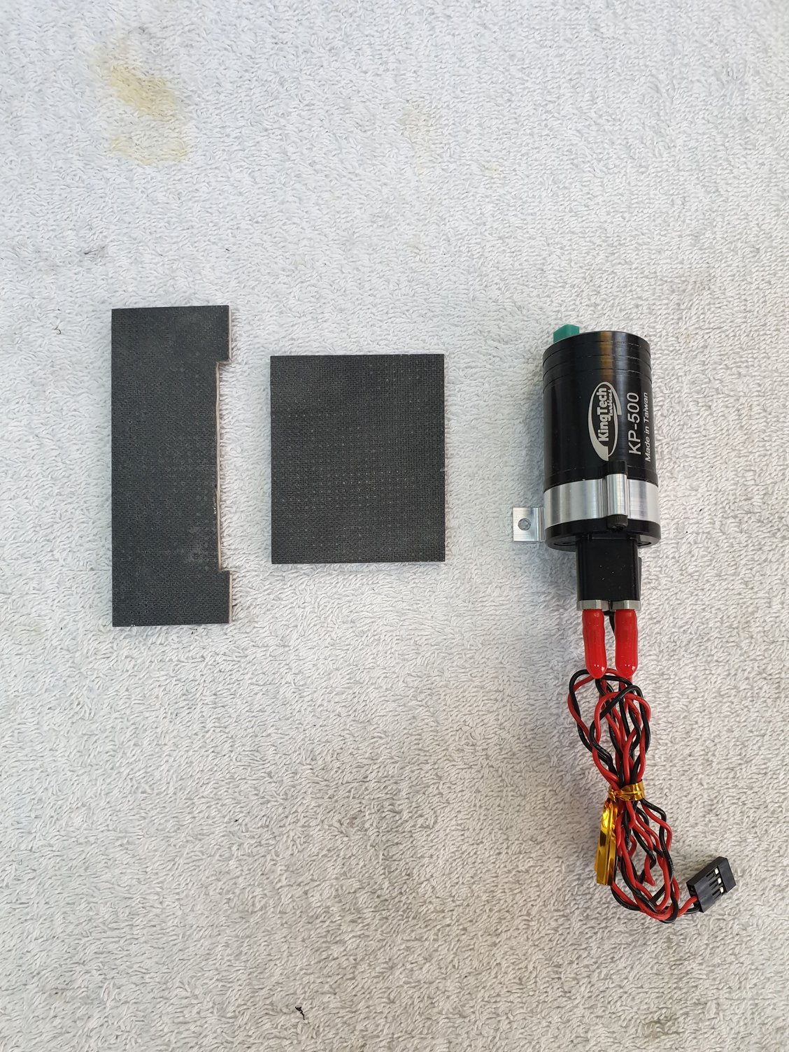

The 2 aluminum duels are placed in 2 hard wood blocks glued to the inner structure. One of the hard wood blocks was not 100% glued to its location. Good thing it happened before flight and it was easy fixed. It also reveled the total good quality of the internal structure.

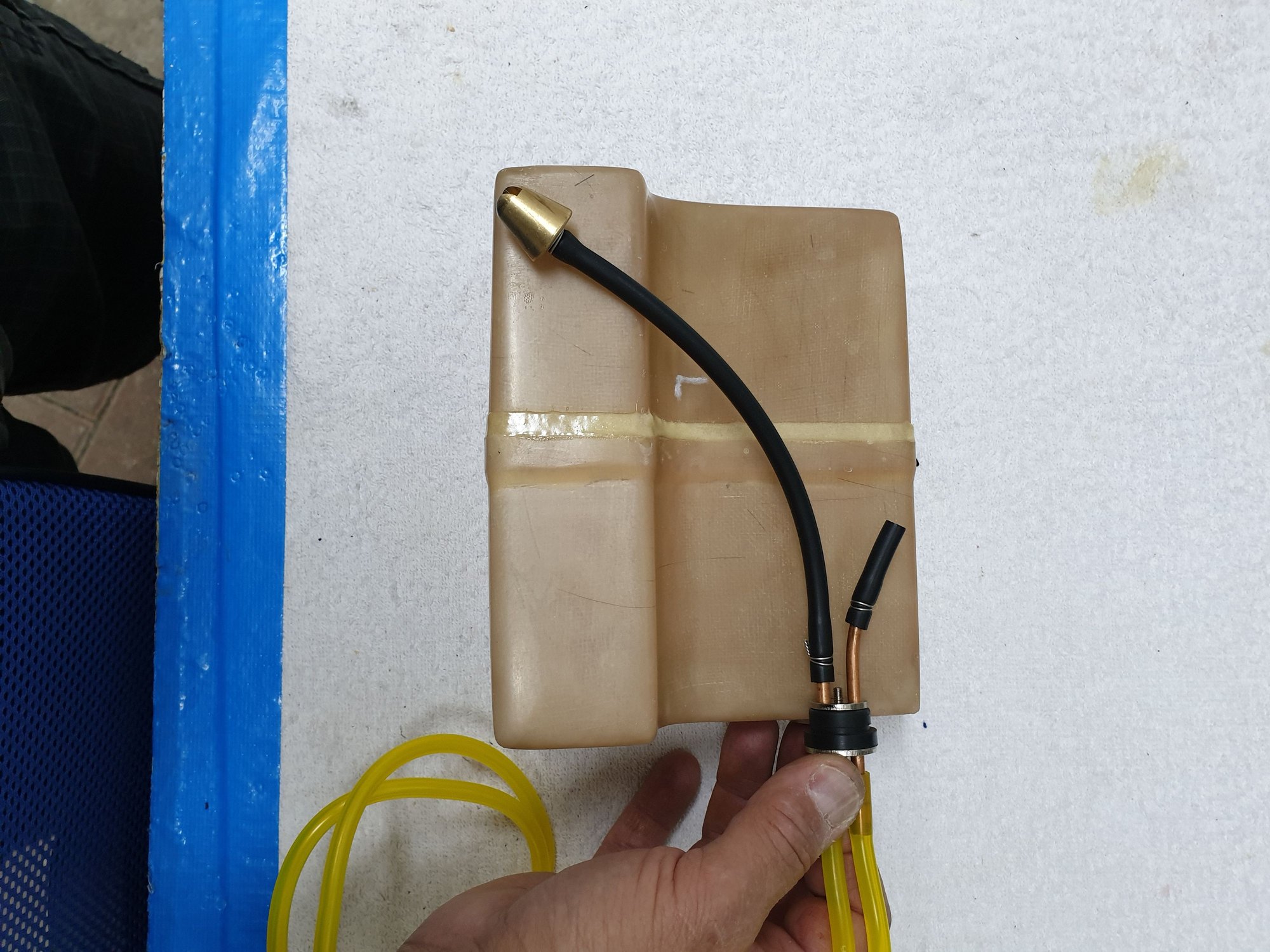

Moving on to the fuel system. the kit arrives with 4 fuel tanks. 2 mains saddle type tanks to be located in center section both side of turbine bay, 1 front main to be placed in the bottom front fuselage and one more to be used as liquid for the smoke system.
All necessary clunks and fuel lines are supplied with the kit. I used the supplied Viton fuel lines inside the tanks and used Tygon lines for the entire system.
at this time i skipped installing a smoke system therefore not used the 4th tank.
This is before applying safety wire to all lines.
With the clunk line that long how is it going to get to the top of the tank? It needs to be shortened to the straight length minus 5mm
Though personally I would alway use a hi flow felt clunk in tanks like that.
Dave

Thanks Dave for the input. You are correct. This picture was taken during line length measurements and before all was ready. The line was shortened and the clunk secured with safety wire.
Avi

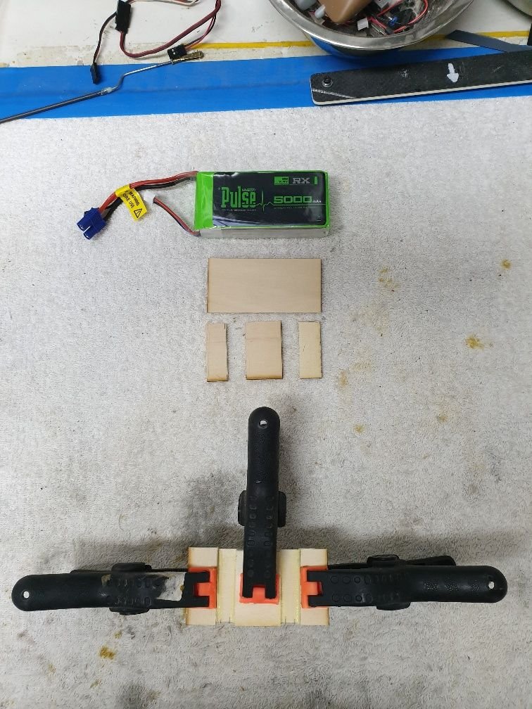

Batteries supports made from 5 mm plywood. One for each battery.
They are glued to the right side of the wheel compartment.
Batteries in location secured with valcro and tie wraps. They are removed for charge. This picture was taken during assembly. Now days the batteries are protected in the tie raps contact areas. The air lines are also routed as needed -NOT as in the picture.

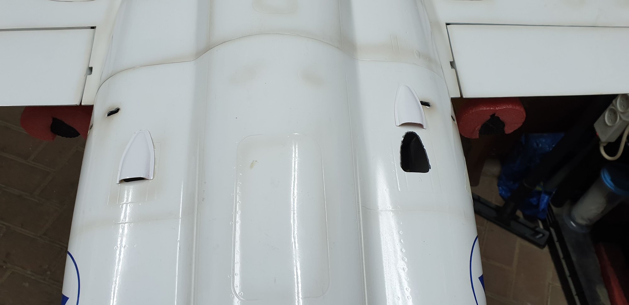

The heat generated from the tail pipe at the rear fuselage must be evacuated especially during taxi and hot days at the tarmac.
I used the full scale venting ports and scoops locations and used a medium kitchen pasta filter. I bought it especially not to harm any pasta diners in the future 😁
Full scale back of the Zukit. Note the different holes vents and scoops for air inlets/outle

Later on during the build i added more vents and scoops. They all contribute to heat disposal and keeps the fuselage warm but not hot.

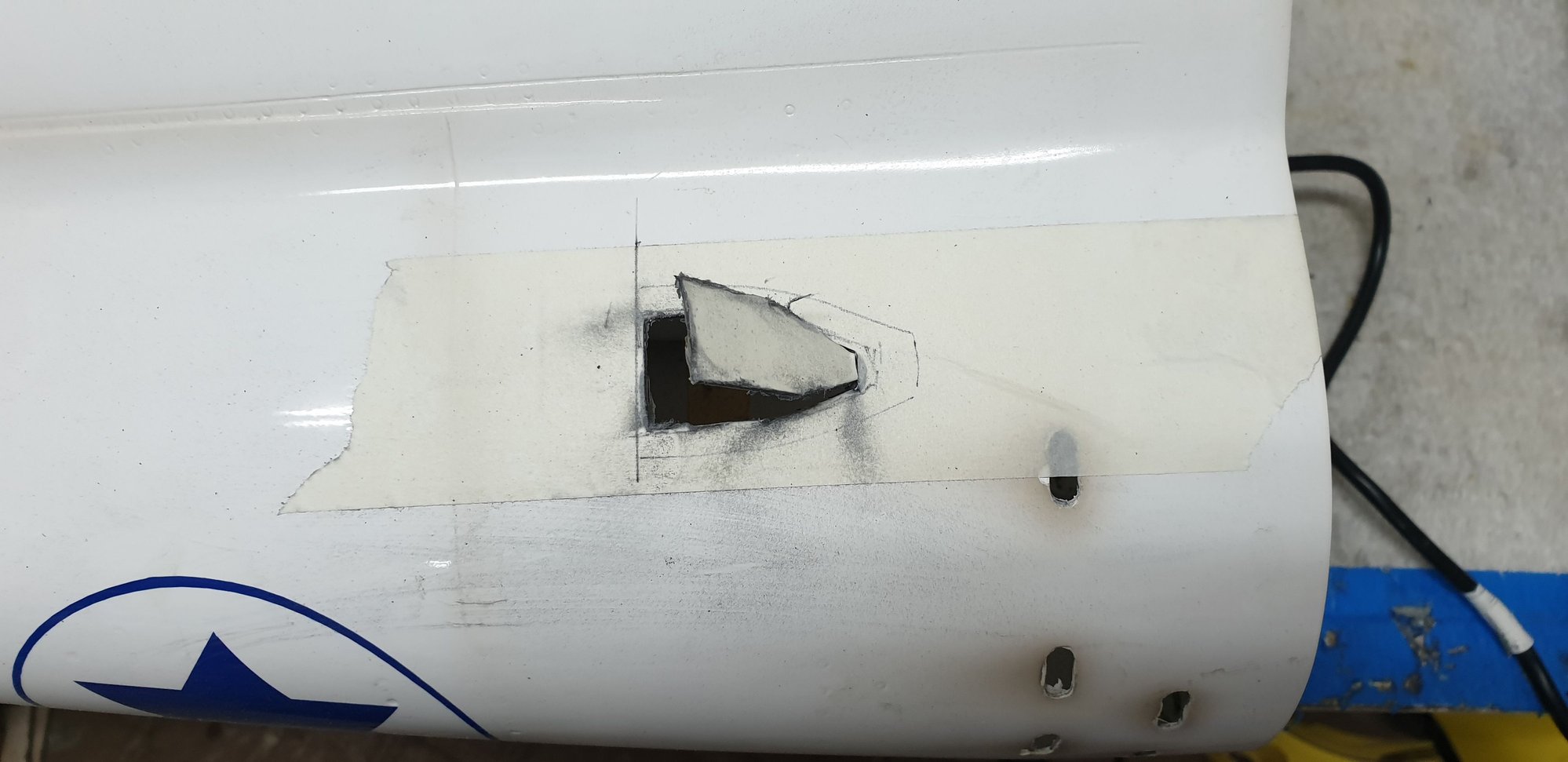

Marking the locations for air scoops. They must be positioned in such way not over the air tanks inside the rear fuselage. This was taken under consideration in positioning the air tanks and lines.
Scoops are supplied in the kit. They are well made and need to be slightly trimmed for good air passage before glue them in place.

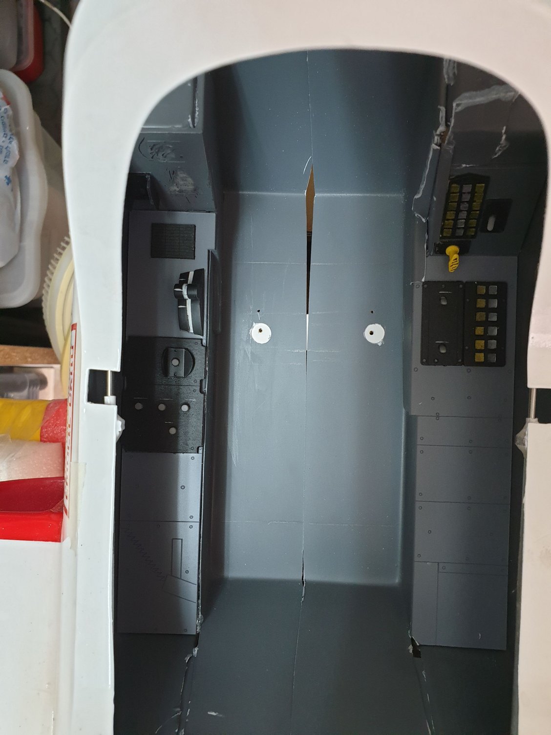

Here is the front cockpit I assembeled to get the general idea of the size and how the hell Ill squeeze it all in in one pice...No chance. It is slightly trrimed and adjusted NOT as it comes in the kit.
I finaly ended with each cockpit actually build from one floor, one seat, 2 side panels and one main instrument panel.
I wanted to be able to get it all out for service in minimum time effort or tools. At the field.

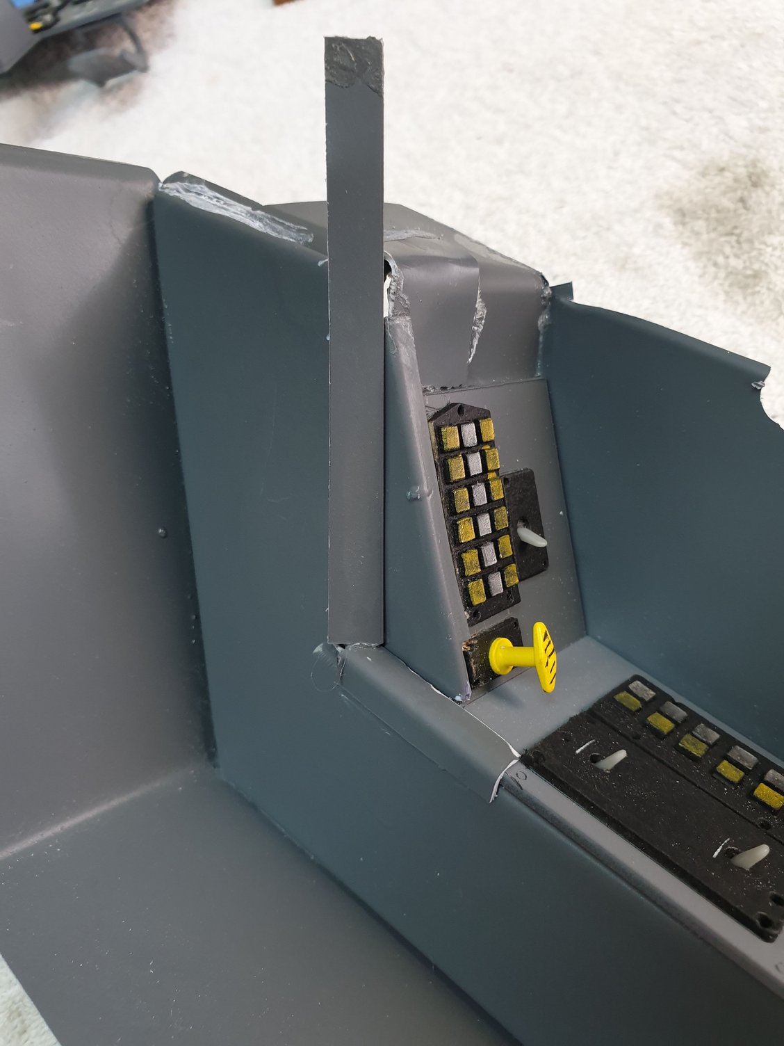

Some more pictures of the cockpits assembly. All was trimmed, cut, assembled and adjusted so it will keep the structure and integrity of the cockpits AND allow them to be quickly removable for service or inspection.
I used leftovers of what was cut to "reassemble" the structure.
Right side panel was adjusted to make space for the front main panel. All side panels and floors got the same treatment.
Leftovers to cover the trimmed material.
Main and side panels together. Note that the floor is cut in half to be able to insert the cockpit in sections.

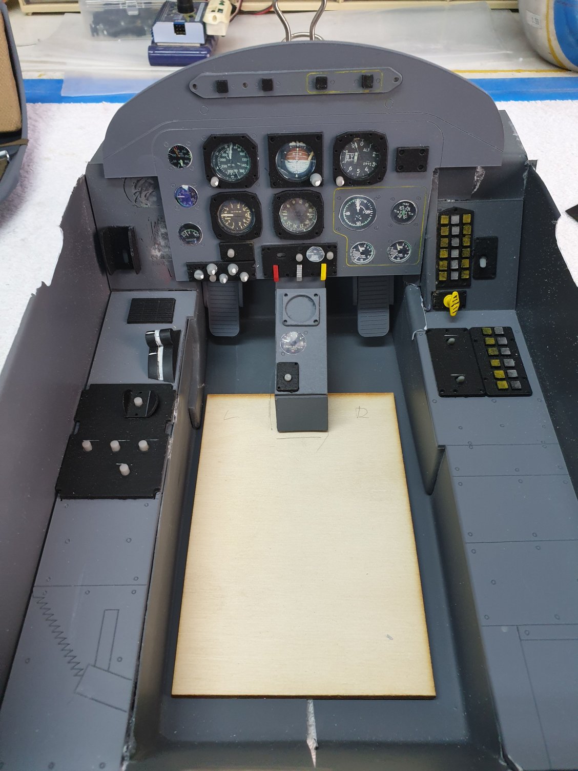

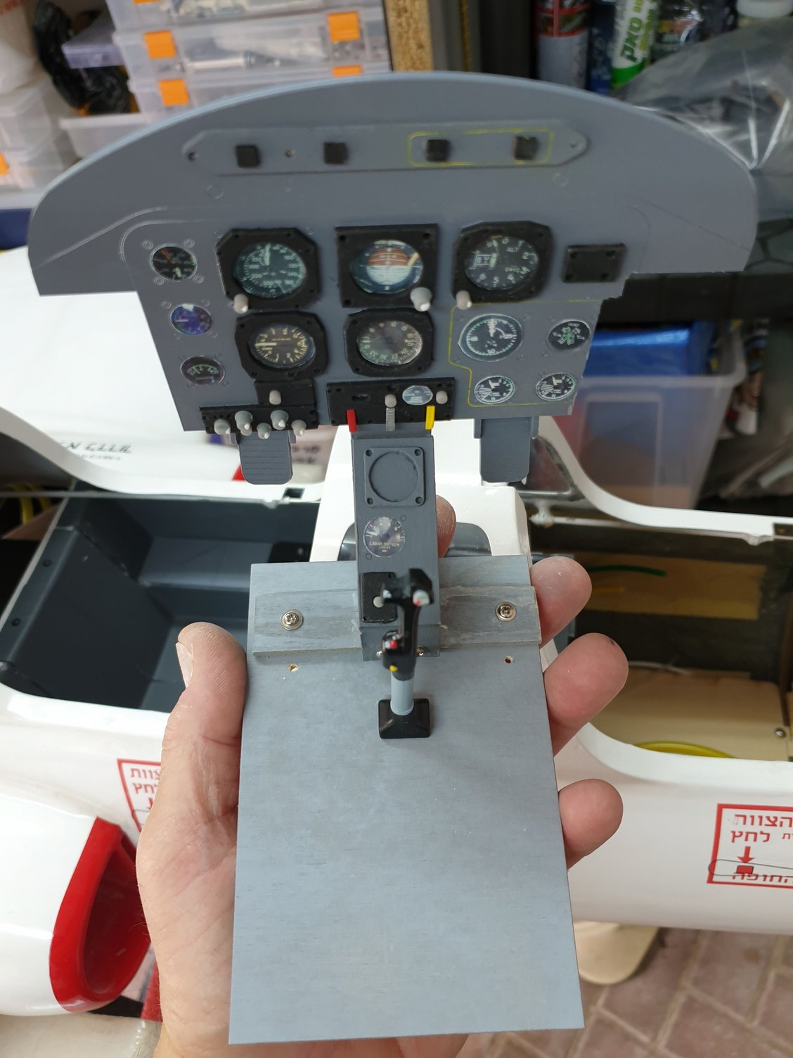

For each cockpit I made a floor from 2 mm plywood. This floor hold in place the seat and front main instrument panel and all is secure to the crossmember
More adjustments and trimming before touch up paint.
Front instrument panel is secured to a bracket. It is important for the "twist and turn" removal and installation.
I used the same method for front and rear cockpits.

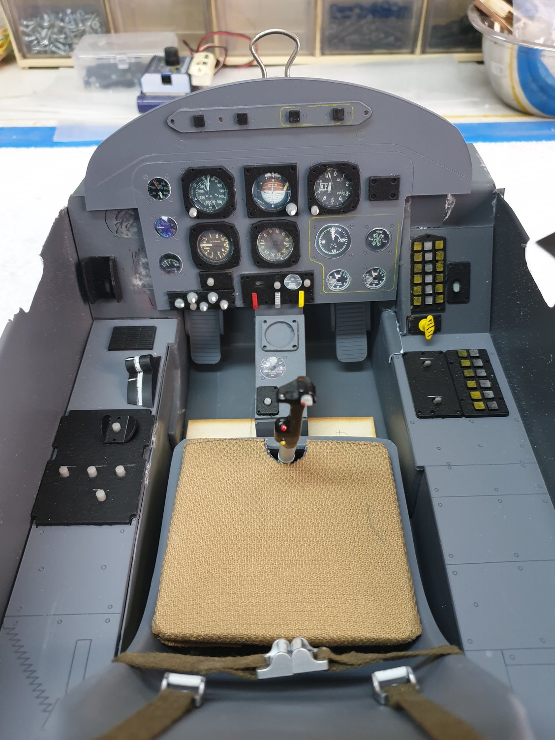

Measuring the rear cockpit floor to its location.
The cockpits are now ready to be installed. Each one has its dashboard panel trimmed to size as well. All in all this part was fun.
