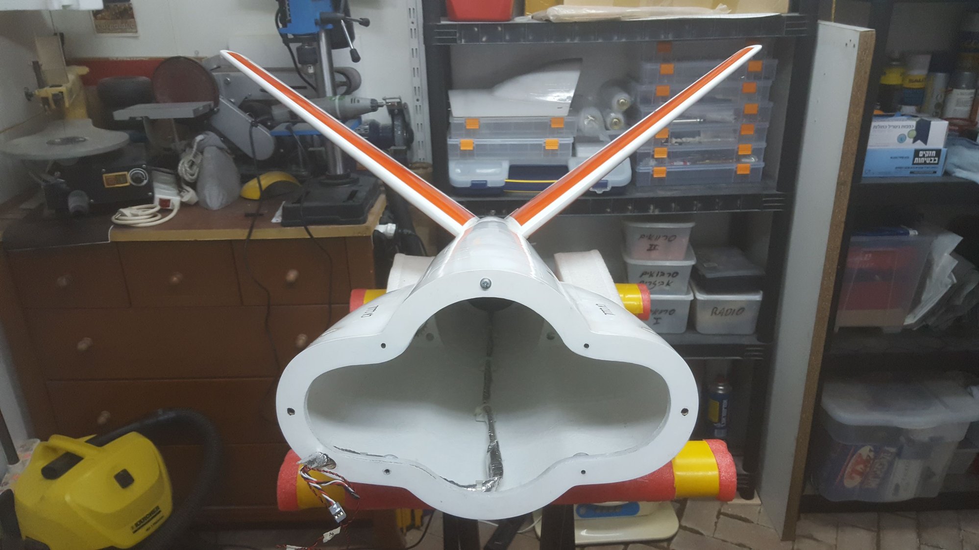

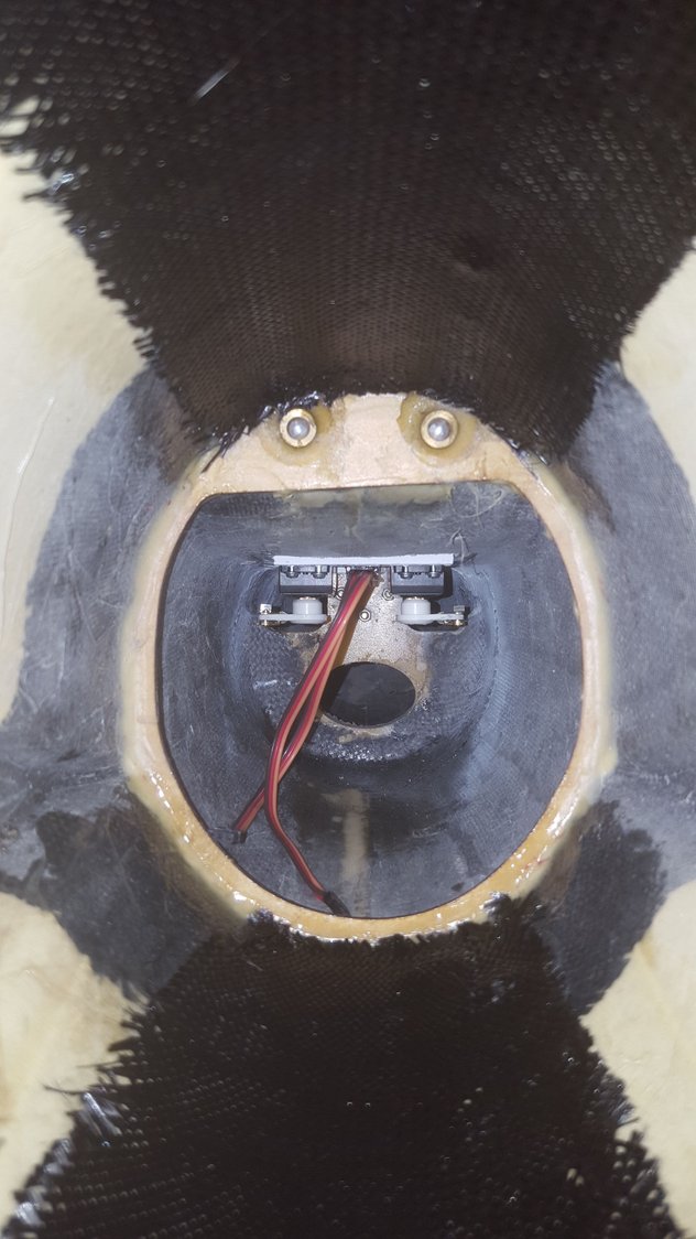

The original rear fuselage is made from fiberglass reinforced with carbon strips. It is strong enough however combined with the narrow jet outlets, engine working and hot external temperatures as we have during summer the area might become soft/mellow
To better cope with hot climate and the tarmac in our summer days I decided to reinforce the rear fuselage with additional carbon. Later it was thermal treated with heat shield. The 180 grams weight increase worth it and the final result is very good.
