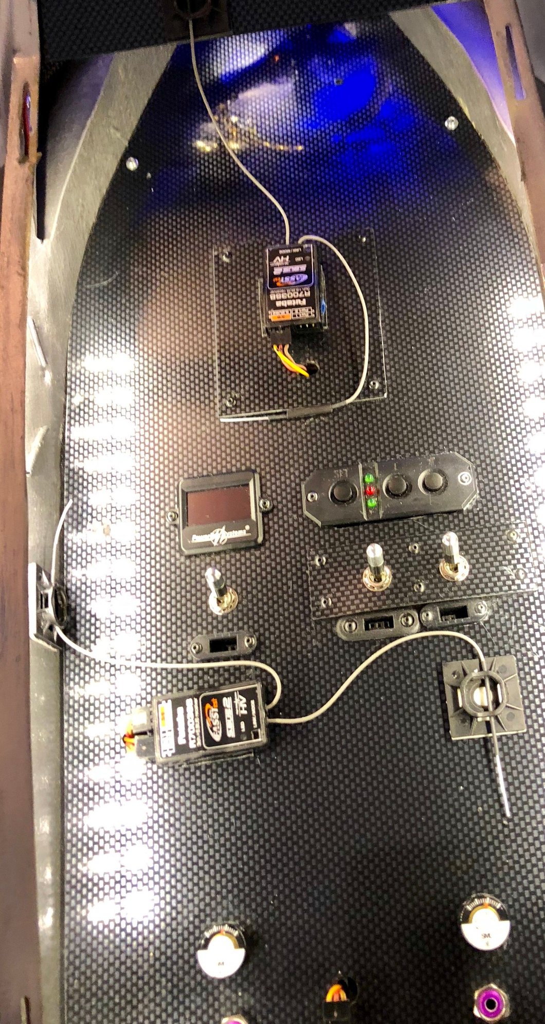

During the current Covid-19 lockdown I have just about got through the list of jobs to do around the house and garden! I decided to have a look at RCU Jets and after 8 years flying nothing but electric ( mostly pattern) the bug may have bitten again.
The one thing that seems to have really moved on is the electronics / receiver setups. It looks like you need a degree in electrical engineering to set up a jet now. The only thing I have left from my jet days are my trusty Futaba 14MZ, no multi channel receivers etc.
What would be the simplest set-up for a basic sport jet like a Boomerang? |I am thinking about an Xicoy 70 or Kingtech 85 turbine, any views or experience of these would be welcome.
Hi John,
Just get a 14 channel futaba rx and one of those powerbox dual input regulator/switch things. I have that setup in my Excalibur. Super simple.

I run a P-100 in my current Sprint. I have seen at least a dozen of them show up at my shows. IMO anything less than 20#s thrust makes the Sprint sluggish. I actually had a P-140 in one for a while before it blew off the stab. :-) That plane is no longer in existence. It was a rather spectacular crash though! :-)
I run powerbox in all but one of my larger aircraft. If you are thinking of a gyro, you may want to take a look the Mercury PBox. It has the gyro built in. However, I am not sure if the Mercury SRS is what you want for a Futaba setup cause I dumped Futaba 7 years ago. The Mercury SRS with three or four remote Rxers works great, especially with current radio systems offering many more options than what was out there just a few years ago.
Also, you may want to run 2S LiPo or LiFe. I run High Voltage (7.4 VDC) in all my jets. LiFe will not provide that w/o going 3S and then you have more complexity with adding high current voltage regulators. (e.g. Max input voltage for PBox is 9.0 VDC.) 2S LiFe is also actually beyond the max voltage for low voltage servos, etc. So 2S LiFe does NOT get you to high voltage and it is too high of voltage for low voltage servos. But some folks do run 2S LiFe on Low voltage servos even thought they are > a half volt higher than a low voltage servo's specs. So I run LiPo, but take them out for charging. The Sprint has a nice compartment for two 2000Mah LiPo Rxer batteries tucked in right above the nose wheel. With that and forward placement of a PBox you do not need to add any nose weight, even with a P-100 sitting on the tail. NiMH batteries are not going to get you to high voltage and high capacity w/o unnecessary weight and then there is battery memory to deal with.
High voltage digital servos are the way to go. For example; Hitecs are programable, which comes in really handy, … say for the flaps when you have only enough channels for Ys on the flaps, etc.. Reversing a programable servo is easy. But, I recommend one channel for each servo. It makes fine tuning and matching control surfaces really easy. I only mention Hitec here because that is what I am familiar with. There are other brands of servos that work just fine. For me reprogramming a Hitec is simple versus using SBus or Xbus, etc., especially in a smaller jet.
When you buy Rxers, think big. I have a couple jets using 14 channels and one using 15. I just want you to understand what the jets out there get into. You certainly can get away with 9 channels if you use Ys and couple control surfaces together. But then you get into issues matching them. A Mercury will give you 20 channels, if you configure it and program it correctly. By the way, there is a learning curve for programming PBox. But once you figure it out, you have great flexibility. But, … if you are not willing to learn programming, you may want to look at simpler options. Then there is component availability. Some brands have not had their radio system components available for months!
You are right when you really have to think about the systems in a turbine. They are a bit complex at times. However, just think one system at a time, do a lot of reading and consider weight as you add components. While a Sprint or similar can handle excess weight, many of the smaller Mini jets can not handle much excess weight and the smaller jets do not have the space for many of the current component options w/o making an unmaintainable mess inside it.
Lastly a Sprint is a good choice for a beginner jet. There are others. It all depends on what is available at the time you want to buy, I guess. But I still have and fly the Sprint. It is fun and simple enough for a first time turbine setup. I just clocked 25 hours on it and had the turbine rebuilt. But then my other jets all have at least 17+hours on them meaning it often sits neglected in the trailer. Lately I have been using it to train new jet guys, etc. as well as just have some no-pucker factor fun. The Sprint is easy to fly and land. The minis are more difficult as they typically have a heavier wing load and they have less robust gear and gear mounts resulting in a much less forgiving plane to land.

I like to KISS it, just like Patric.
My B-XL set up consist of a 14 chl Futaba receiver, 2c 2100mah LIFE batt packs X 2 for the receiver, a 2c 5K LIPO batt pack for the ECU/smoke pump and 2 switches, nothing else, it has been flying with this set up for the last 3 years.

Ok guys, thanks for all the useful input, decisions made so far;
Radio- existing 14MZ/ rx 14 channel 6014, Powerbox sensor switch with 2 x 2100Lipo, electric retracts ( can I run these off the 2x Lipos?)
Model IAD Model Designs Serpent - 77 inch span looks like Kingcat clone CNC built up kit with glassfibre fuselage ( I have plenty of time to build!) suitable 60 -100 turbine.
Turbine - waiting on input, liking the Kingtech 85 or Xicoy 70 - any views.
