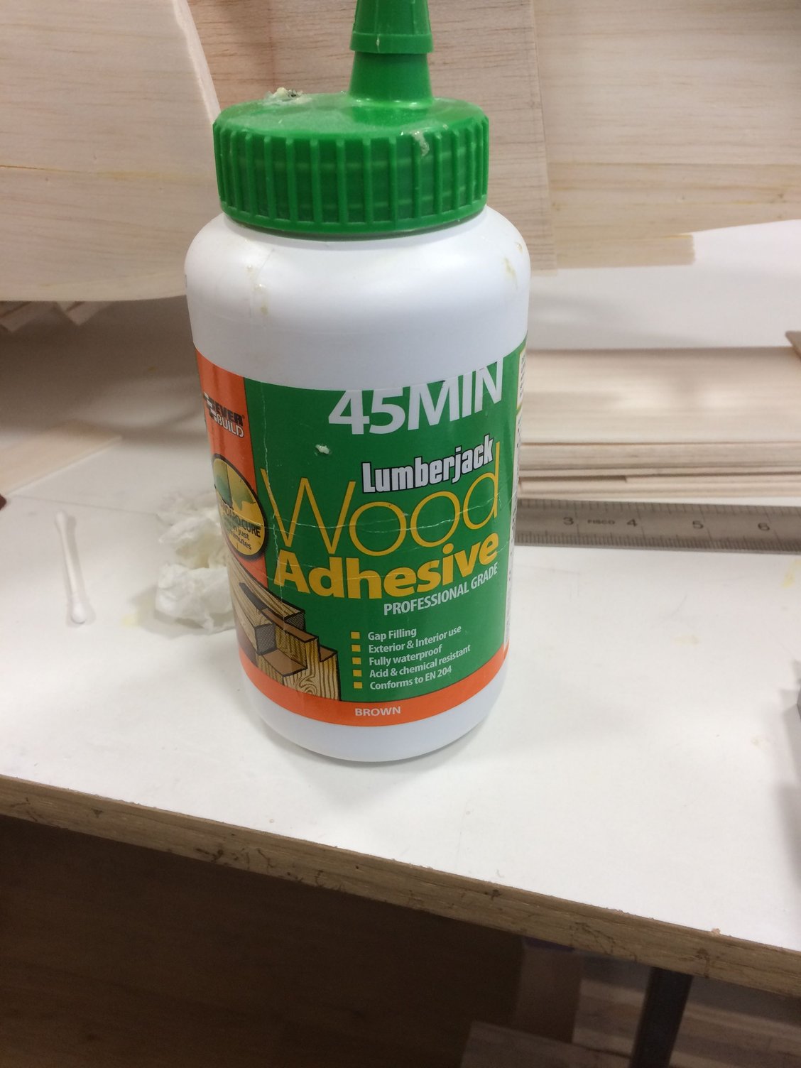

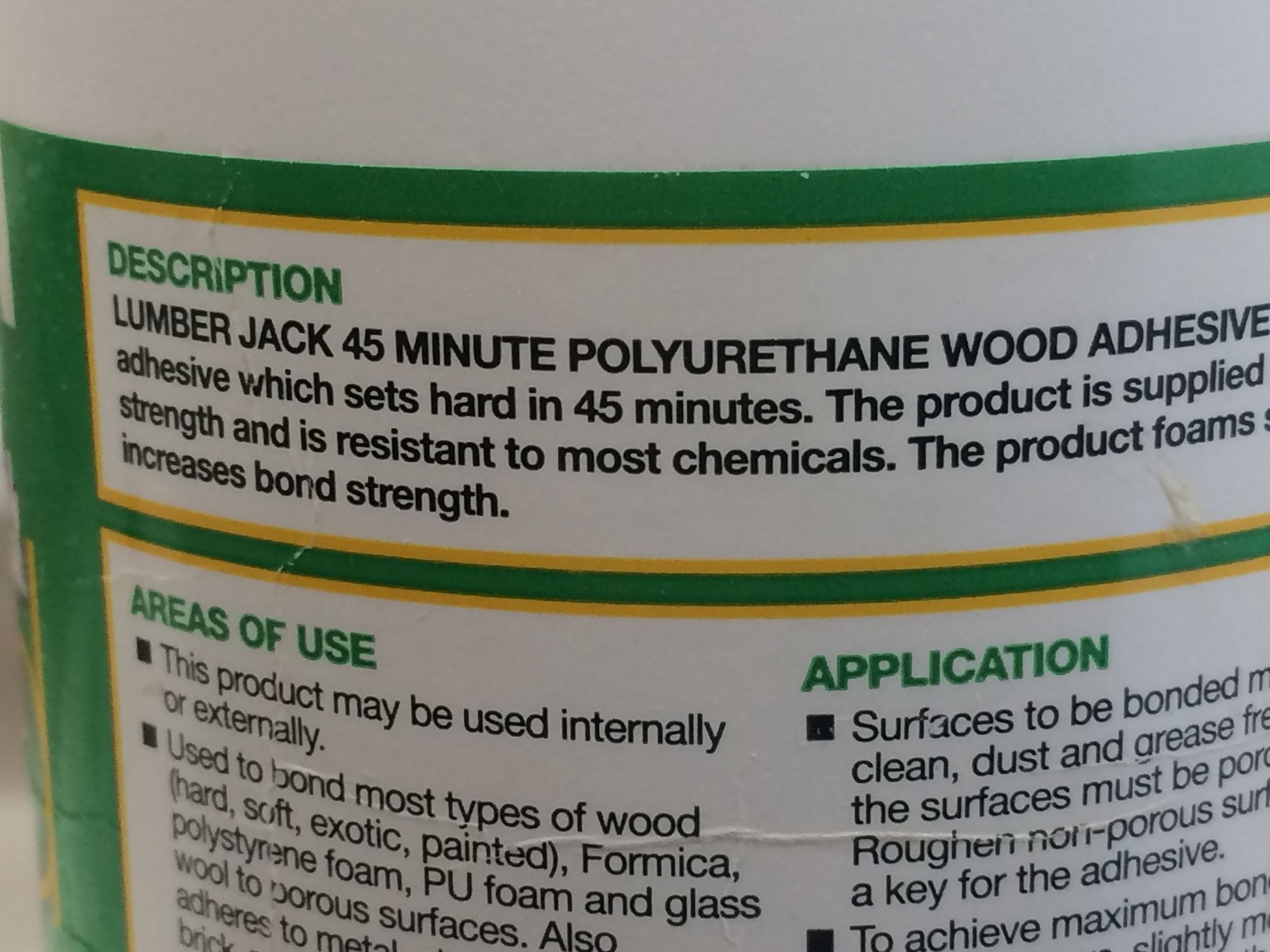

the glue who foaming a bit on rudder picture its Gorilla glue ?

Jc,
It is not Gorilla, however, its a "Polyurethane Adhesive". Compared to Gorilla, it benefits from lower viscosity, means easier to apply, hence less glue to use & lighter :-)),
Another useful place was to sheeting balsa on wings, where I needed to apply this glue on all ribs and spars, etc, then press balsa sheet, which I used magazines for pressing,
