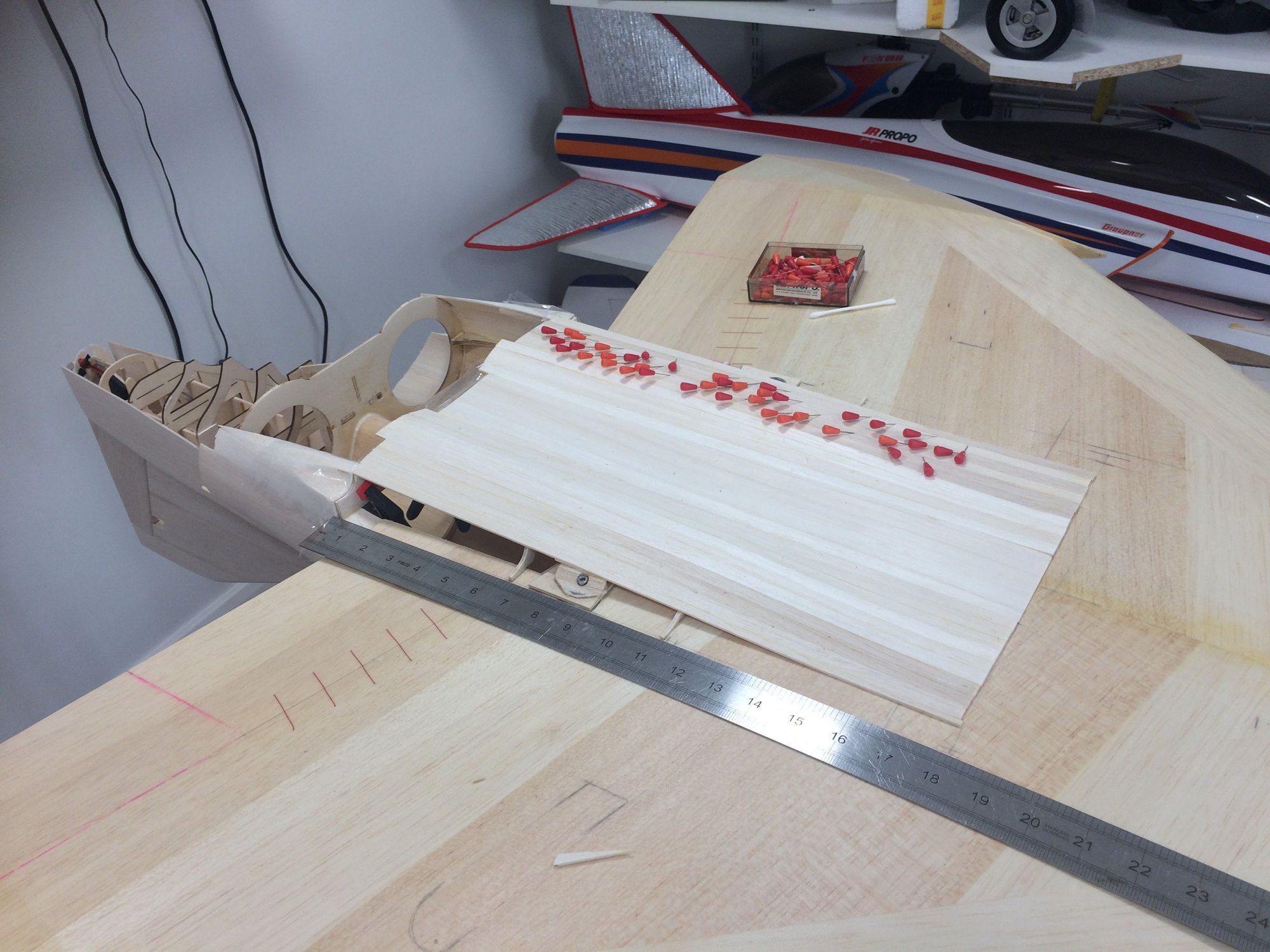

Default Turbine Position,
When I started the project, I wasn't sure if I will locate turbine to the end of Fuselage, means no "Tail Pipe", or to help the CG I move it forward. This is why I made a mount long enough to be able to position turbine eater way.
I conclude to move forward turbines, which means have two turbines about 20cm closer to CG, means I would need to instal two tail pipe. Now that I wont need engine mount in far back position, I cut them and I saved 65 gram, which is almost as same as one of tail pipes :-)),

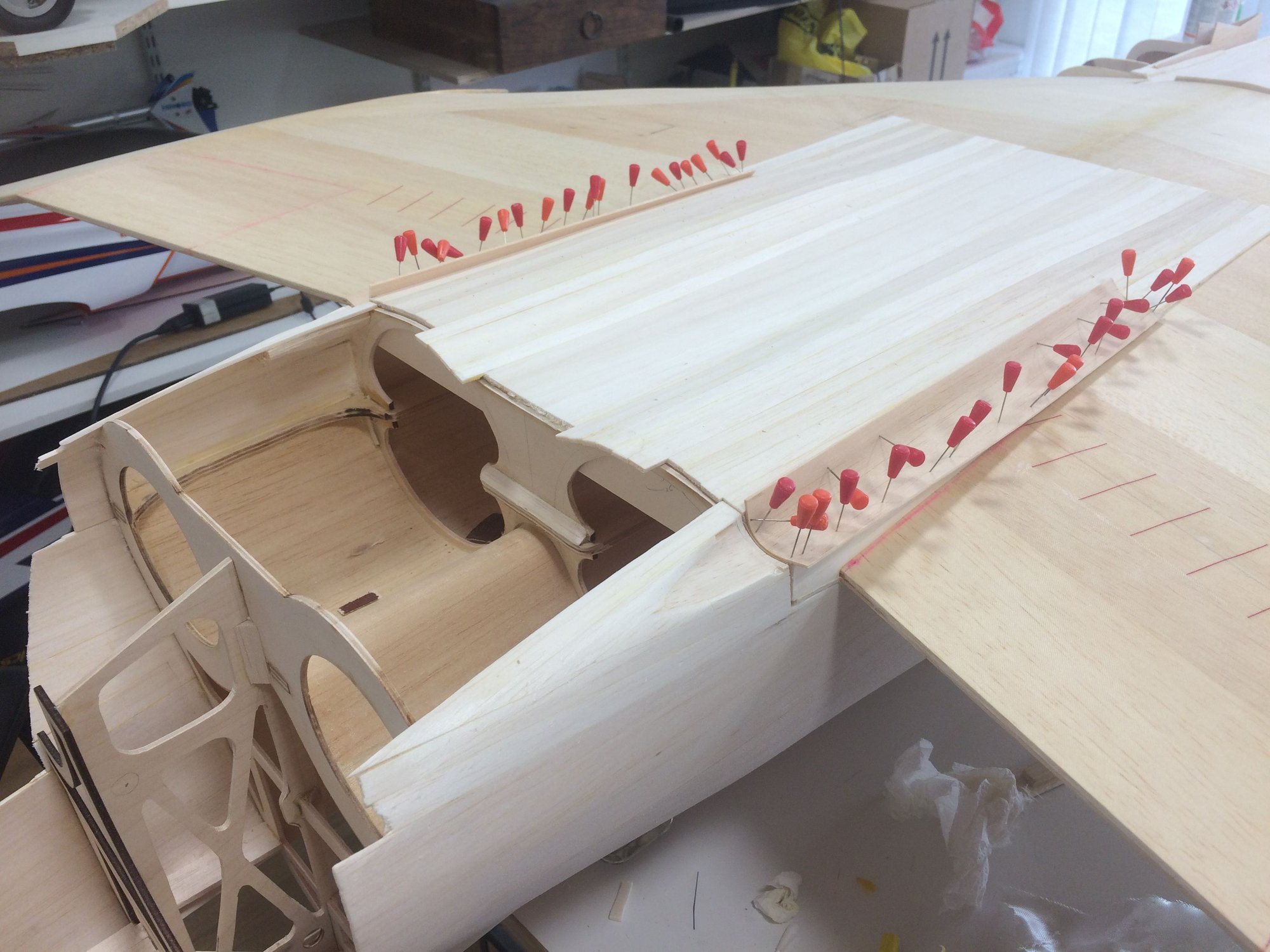

Default Building up belly, top of turbines to middle of wing,
As I have one pice wings, it meant formers have cut from middle to accommodate wing in middle of fuselage. Therefore, I need to build up belly shapes using small lower part of formers by attaching & gluing them below the wing:

Will you be adding braces, to replace the former sections you removed, to maintain fuselage stiffness?
Lovely timberwork.
Fortunately I'm on the other side of a scratch build, mine's in primer & ready to test fly.

No, I'm not adding any braces, once I finish, I'll use a 25gram glass for all fuselage,

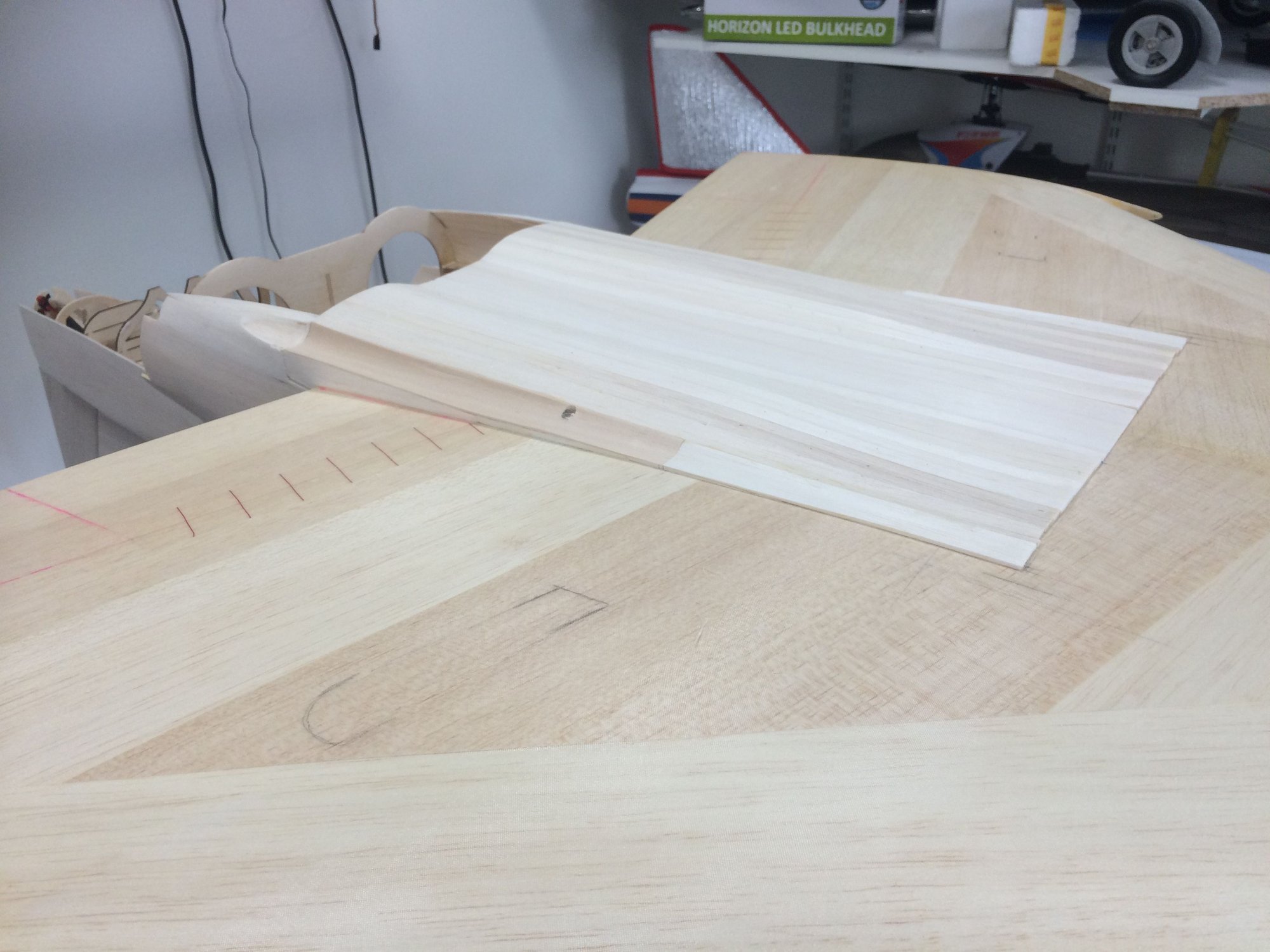

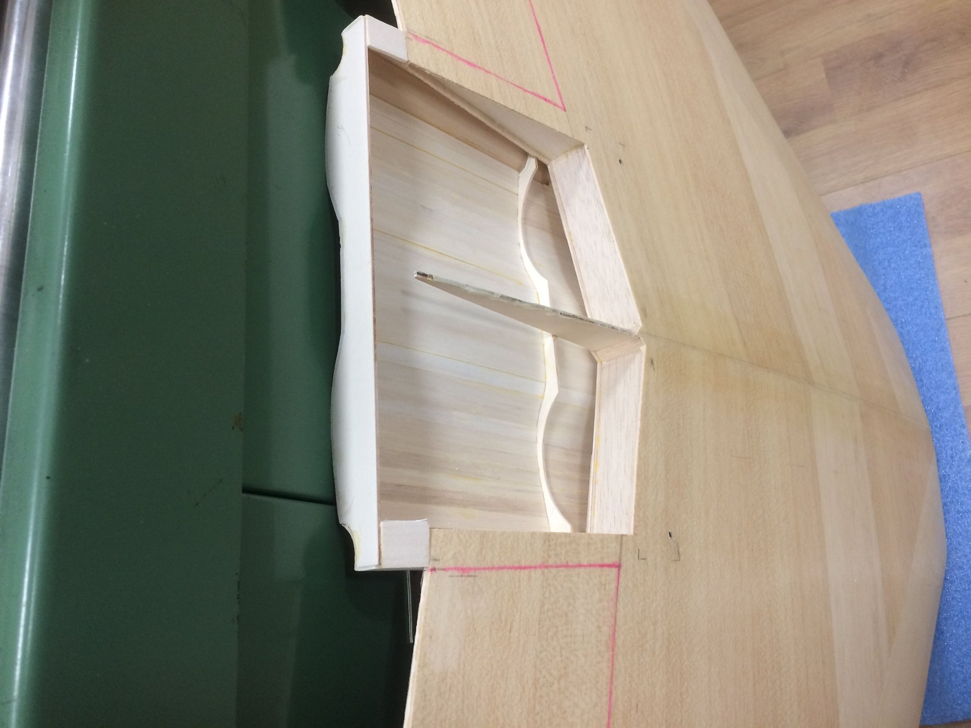

Default In take & Belly
Hello Again,
More rain, more time for sanding balsa :-)),
Taking off from grass, means more grass cuts (sometimes wet) into the in takes, so I decided to do planking for inside the formers as per photos.
Also, having one pice wings, part of Belly needs to build up and glued to bottom of the wing, so this part is finished too.
I used 25gram fibreglass for wings as well as fuselage, however, Dave (Wilshere), advised me to have two layers of fibre glass on belly, so I did so. So, if one day landing gears decided not opening and cause a belly landing, belly can handle it :-))
