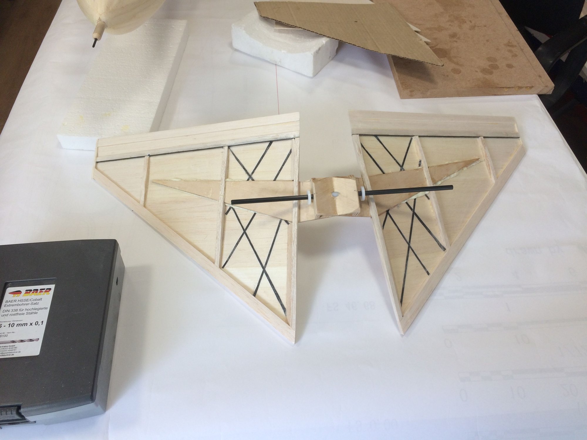

Default Elevator Mechanism
Hello there,
Below key points about Elevator Mechanism:
  • A multiple layer of plywoods is the mount, which has installed on tail formers before,
  • 4mm birch plywood is cut in x shape & reinforced
  • 6mm carbon rod as shaft, going trough a teflon wich is fixed on x shape plywood,
  • two 3mm teflon washer has filled the gap between mount& x shape plywood,
  • all 3mm ball links,
  • rest as can be seen in photos :-)),

Default Elevator,
Hello guys,
Following elevator Mechanism, I build up elevator on top of plywood structure. However, on half way I thought 4mm plywood is little week, so I reinforced plywoods with 2 pieces of 4mm Carbon rod and 75gram carbon cloth,
By finishing elevator, all up weight is 3300 grams, including all 7 servos and linkages. Withouts servos, fuselage and wing together is 2950 grams (6.5 lbs) , which is before primer and paint.
