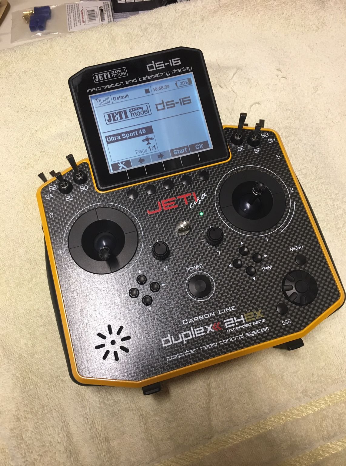

I like the yellow too, this is the day I got it, the date on this pic was June 6 2017 so apparently I’ve been flying Jeti over 3 years now. Convert from flying JR for well over 20 years before that. I’ll probably upgrade when the DS16 V2 comes out, unless I run across a killer deal on a 24.
