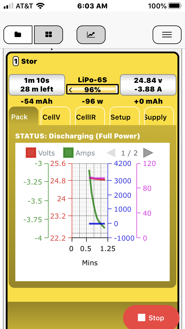

My charge case features a FMA Power Lab 8, Bump Controller (allows pre sets) and 24 volt power supply.
It will handle all battery chemistries.
I also have a 12 volt output for other devices.
Bumper controller in the lower left corner. RFID tag placed on battery is programmed to preset charger settings by ďbumpingĒ The tag on the bump zone. It keeps a history of charge cycles.
Bumper controller screen allows manual input
Phone app allow you to monitor and control charger from your phone.
