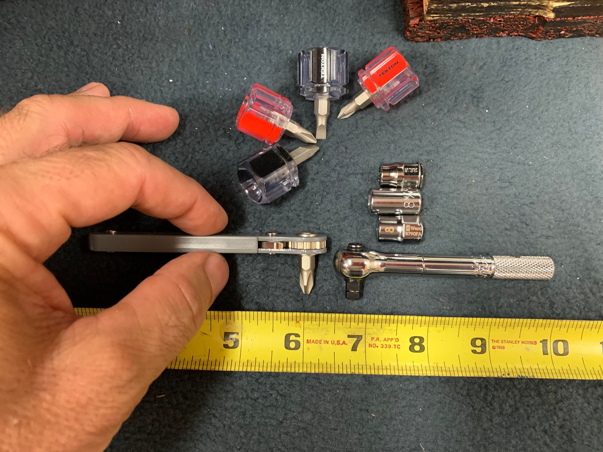

A little tool talk.
I used hex head sheet metal screws to hold the engine to the plywood rails for mounting. #8 I think. I always use wood or sheet metal screws as otherwise you would have to get a nut and bolt in there and that is harder to do. As you recall I bought an angled dental drill for $150 so I could drill the pilot holes in the confined space back in the fuselage. I needed a small 1/4” drive ratchet with low profile socket to sink the sheet metal screws. A “normal” 1/4 ratchet and socket would not fit and the ratchet made it nearly impossible to get the screw started. It would turn in some then turn out as the ratched resistance to release in the opposite direction was too high. Solution, the Roller Ratchet.
https://omegatec.com/rr40s-sp-revers...r-ratchet.aspx
You can get this small handled version of a 1/4 drive ratchet but more important is that the reverse resistance is about zero and the lock is toothless. There is around zero degrees of movement needed to lock from the back direction so you can get full function with the smallest throw. Small spindles with other tool ends are available but expensive. However, if you need this function it cannot be bettered.
https://omegatec.com/rrqc-hx3-16-rol...t-spindle.aspx
Below is a Craftman 8mm standard socket flanked by a Snap-On and Wera “short” standard socket. The Roller Ratchet is below these. Note that it has the 1/4” drive spindle but this can be removed and other tool tips that are very short can replace this. Flat, shortened ratchets cannot do nearly as well in the tightest as spaces.
