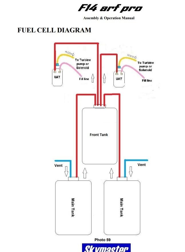

Back to work after a while. Preparing the fuel system, and I have a question re the fuel lines order.
The original design suggests connecting the UATs L+R to the Front, and the Front to the Mains L+R. I see two issues here:
1. While refueling, first one to be full is the front, and then fuel flows to both mains.
Assuming it will never be exactly the same flow rate, as the first one of the mains gets full, and fuel gets out from the vent, the other one will never get full.
2. While engines are running, fuel flows from the mains to the front.
Again, assuming it will never be exactly the same flow rate, as the first one of the mains gets empty, it is easier to sip air so remainder fuel in the other main will become unusable.
This is my understanding, correct me if I'm wrong.
I thought about changing the lines as in the second chart, connecting the UATs to the Mains, and then to the front.
That way:
1. While refueling, both mains will get full before the fuel will go to the front, and only after the front is full, the overflow will go to the vents.
2. While engines are running, the front tank will get empty first, and then each engine can use all the fuel in the mains.
WDYT?

I think your understanding regarding sipping air and unuseable fuel is incorrect. My buddy had 200 flights on his configured that way and had no issues. I decided to go against the SM recommended method and have your second option .....my reasoning for that was two fold. First off by having both side tanks draw from the forward tank first, itís burning fuel towards the ideal CG POINT for landing (not a huge consideration but anyway)....Secondly, it allows one to see how much fuel is remaining after a flight as the forward tank is not visible....
fueling.....I still havenít flown mine as my paved runway is still not available to use....but for fueling the sequence is: fill the first side tank....then fill the other and keep going till it over flows, which occurs after the forward tank is full. Thatís how we set it up but there are even more exotic variations one can go with. Good luck

Don't over think it, I have the first picture setup and never had a saddle tank empty before the other. I made sure each line and clunk lines are cut to the same length for equal pressures
The main reason for not using the second setup is the lack of a true clunk movement in the saddle tanks which could lead to a possible clunk out of fuel condition. The CG shift is not an issue, all the gear goes forward when up and shifts aft when lowered for landing. Just my two cents, I have had my F-14 since 2016 and not issues in this department. The only issues I have had actually happened this past week at KY Jets, the gyro I finally added almost cost me the jet( user error) Then when I taxied in the wings would not sweep back, I have the old controller version and I guess it burned up. I had already bought the new versions that plug in like a normal servo just had not installed them yet, it requires rebalance since I get to dump the 3 cell 11.1V ion battery in the nose.

Thank you Keith, I will go with the original, and finally will attach the nose section to the main fuselage.

No wrong answer really I I have seen people do the three tanks in series and parallel without issue. The above is just the logic I used and it keeps pump pressures down as low as possible.

I did the same in other jets like the Panther, connecting the three tanks in series. It works great. The F-14 is my first twin turbines jet, so not sure. I think option 2 is good, but the lines becomes too long.
As my expert friend Lior said, they (SM) should have provided the front tank divided to 2 separate tanks, thus each turbine gets it's own fuel system.
Oh well, we'll go with what we have....

just make sure all of the lines for the two rear tanks are the same length, inside and out to hopefully have them draw down at the same rate.

Will do. I hate the idea of getting back there once it is all assembled. No access at all to all these fuel lines. Maybe even doing a full cycle of fueling and draining before final assembly.

Unfortunately I don't seem to have any pictures of my own work. I got my inspiration from the work of Richard Muller, who posted pics of a similar setup here on RCU. His was an F18 maybe, can't really remember.
Anyways, the process is simple:
1) cut the tank parallel to the direction of the clunk lines, in the very middle
2) laminate on one side with glass fiber and a little bit of carbon reinforcement (I used a few cross strands of carbon tow
3) cut a few 5mm or so holes in the 4 corners of the newly laminated baffle in order for fuel to easily transfer during all flight attitudes, but slow enough to not empty right away during a knife edge pass
4) reattach the other half with a nice bead of hysol, to be covered right away with a band of fiberglass before the hysol sets
5) laminate on the band of fiberglass to reinforce it a little
6) pressure test 1 bar under water to check for leaks and repair any problem area by scuffing and applying a little hysol
At this point you need to install the 2 clunks and check movement is unhindered and clunks don't get stuck in the holes you made (they should never even reach them)
