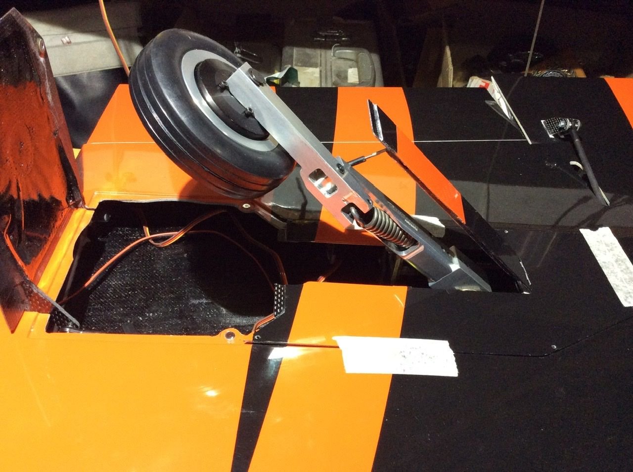

Mounting the retract units it’s important the two are the same distance from the gear door hinge positions so both sides match. I set my units to suit the wing with the shortest distance ( due to the carbon rib build up) that worked out to 225mm (8 7/8”) from the door shut to retract yoke.
Playing with the leg door set up this is the simplest yet. CARF have really thought about this, the linkage comes pre done. I used a loop of masking tape to push the pivot tube into the door and added some spots of Slo Zap to the tube, closed the door, let it set...and it just worked 😄

Back on the Bolt tonight, a weekend away at our Deenethorpe Jet meeting and work yesterday got in the way a bit, but I have spent tonight setting the pushrod lengths using the Powerbox on a installation plate. It has the PB, Rx’s and batteries all fixed with Velcro so multiple cycles will have occurred before I test fly the model. You can set the gyro orientation and direction while on the plate...much easier than man handling the whole aircraft.
It’s really important the flaps are matched mechanically and at full flap the linkage is dead in line.
I have also fitted the carbon sleeve to the gear door rod and that has no load either when closed.

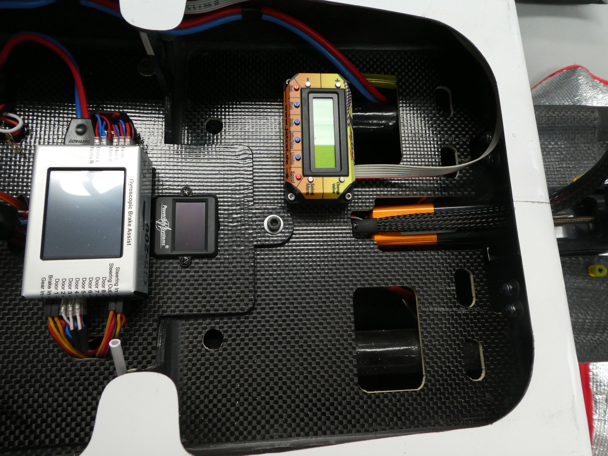

After much debate I decided to use a Powerbox Two-One cake set for the retracts and brakes and my usual std servo lead plug and socket removing a single point of failure and probably a few grams lighter.

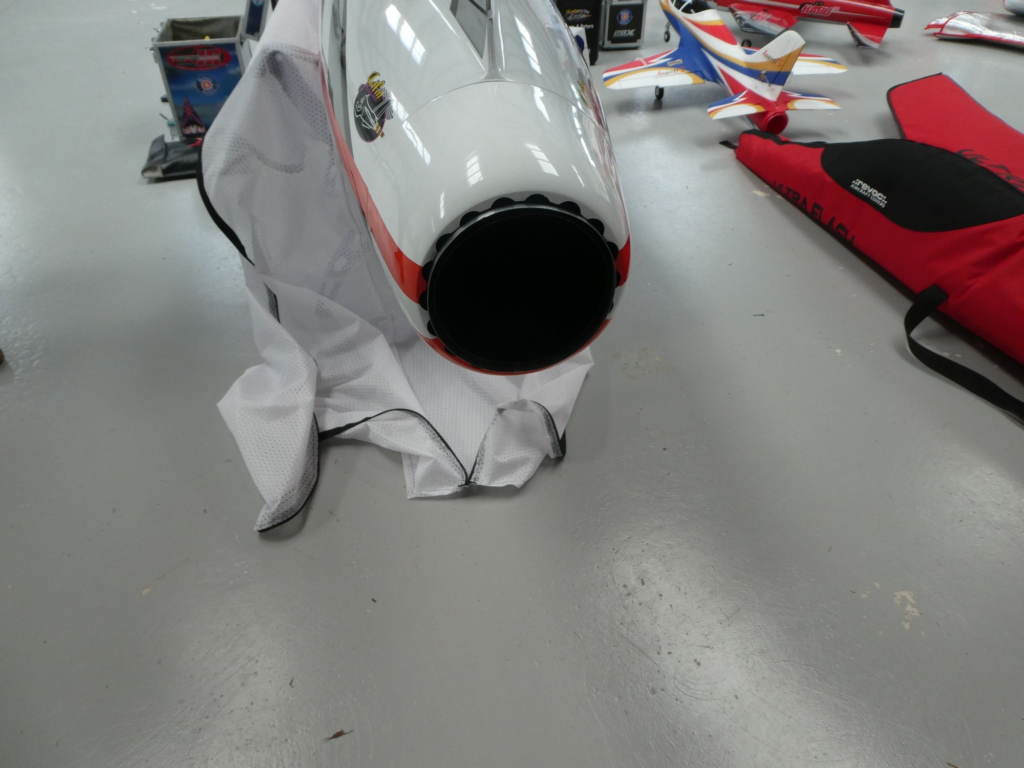

Started on the fuselage properly now. The turbine installation is easy, especially happy the bye-pass is big enough to take the lead without a hole.
Sometime ago I found this card tube matched the P-220Rxi tailcone exactly, so I use it to centre the turbine as the added length gives something to reference. You can also get the turbine out through the hatch opening even though it’s narrow. This is just sat with no fixings.
If you zoom in on the rear shot you can see the set square between the two wires hanging in the far bench. I used this to check alignment.

Another 15 hour day in the office trying to get the Bolt! finished around work for this coming weekend. Wires are run from the tail and I have started working on leads for the wing connections.
The formers are all carbon so where the leads have to come through they need protection. I’m not a big fan or the braiding but have used lengths through the centre formers. To tidy the ends I added heat shrink shrunk over a screwdriver blade the right diameter. This way no heat is needed in the fuselage.
The tailpipe is neat in that it attaches to the bye pass with three springs, so removal is a breeze. The holes are even pre drilled and the pipe fits the carbon outlet.

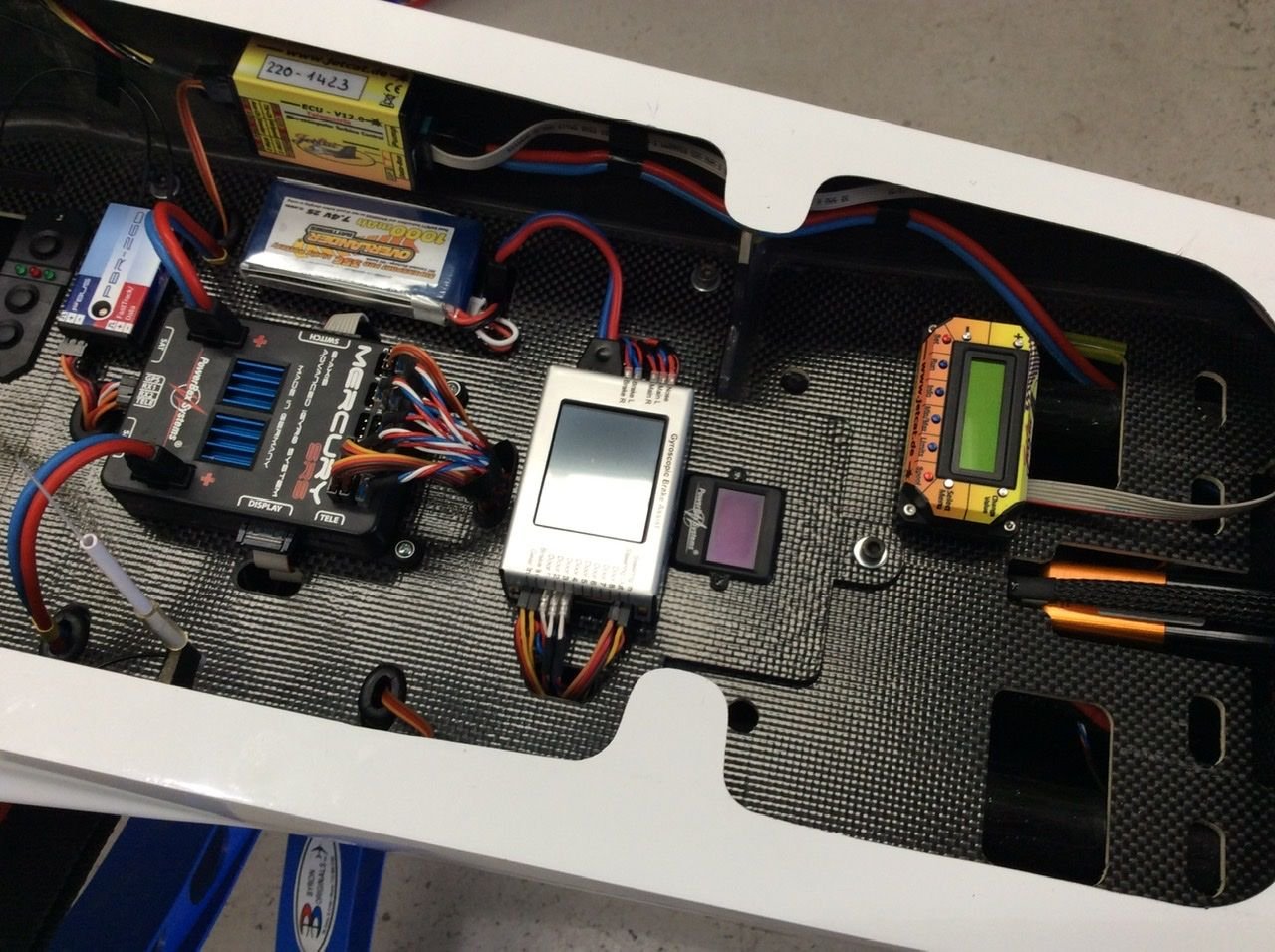

Before final positioning of equipment I decided to do a balance check, no chance of a miss reading sensor here! 100kg nylon trace, triple knot each end, trap between wings and lift...

Jumping forward after several very late nights it’s just about there.
Final weight with MAP 6oz Bubble trap full and landing fuel in the tanks is 18568g (18.5kg) I spent a whole evening staring at the install working out where to put the Rx aerials I ended up with a vertical unit ( removable for transport without the top hatch on) and one in the RH inlet and the other down at an angle where I noticed with a bright light there was standard foam/glass skin.

Dave, what are your thoughts on the weight now that you have it built? P-180 would probably be OK for this sized jet as well, yes? Install looks great, thanks for sharing your build!

Weight is good, I guess if I took all the fuel out it’s close to 18kg. Yes, it would fly with a P-180, only thing might lack is initial acceleration as the tail pipe is sized for the larger motors and it’s very specific for the design.

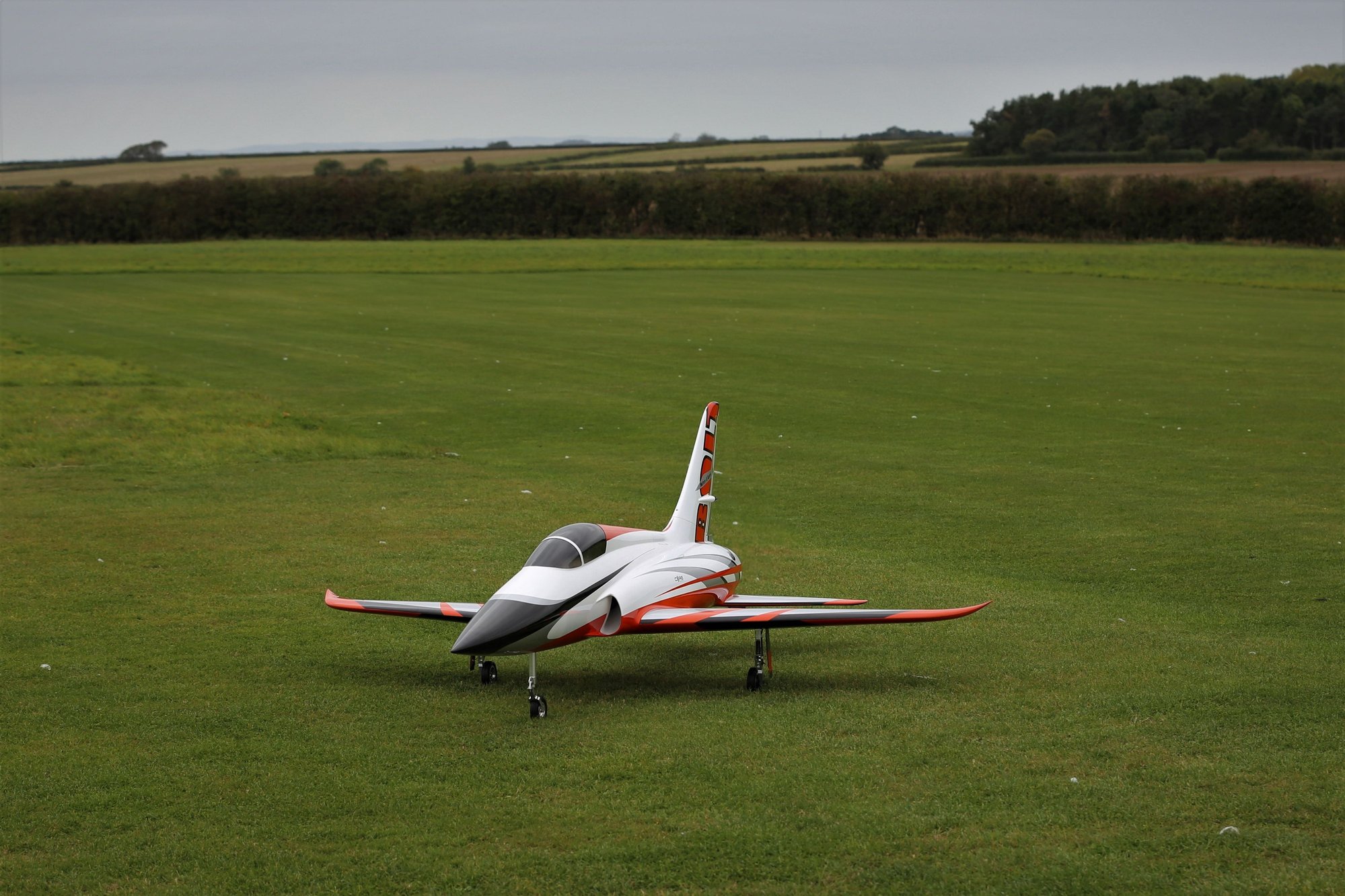

Dave W managed to test fly his CARF Bolt at Buckminster Lodge today, the conditions were not great (Note the Wind Sock in the photograph) however the model had impeccable manners, it was flown mainly on half throttle to check the systems and trim.
When given the beans it is very fast, and very smooth too.

Thanks AP. Crazy really, but the Bolt! coped with it perfectly. Photos are great to look at, I can see the rudder held in for the cross wind! Also I need to check nose gear door linkage/ servo mount.
