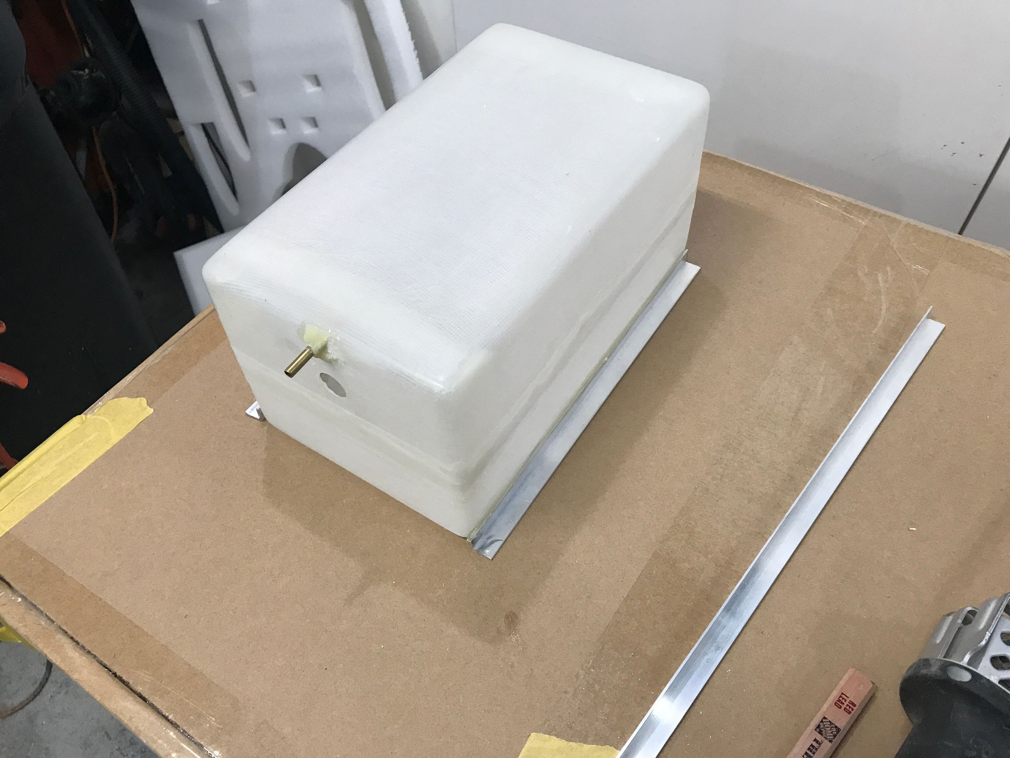

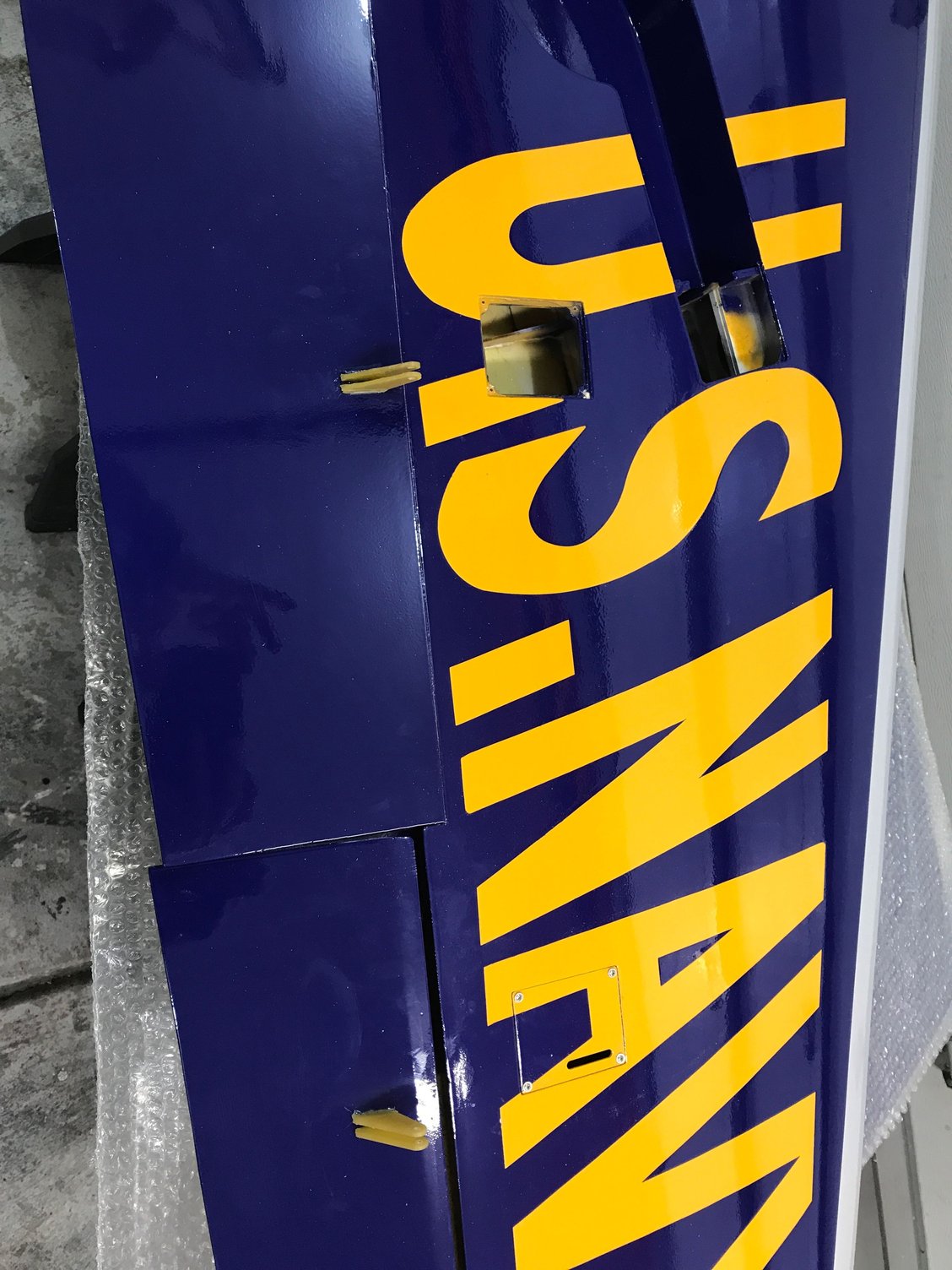

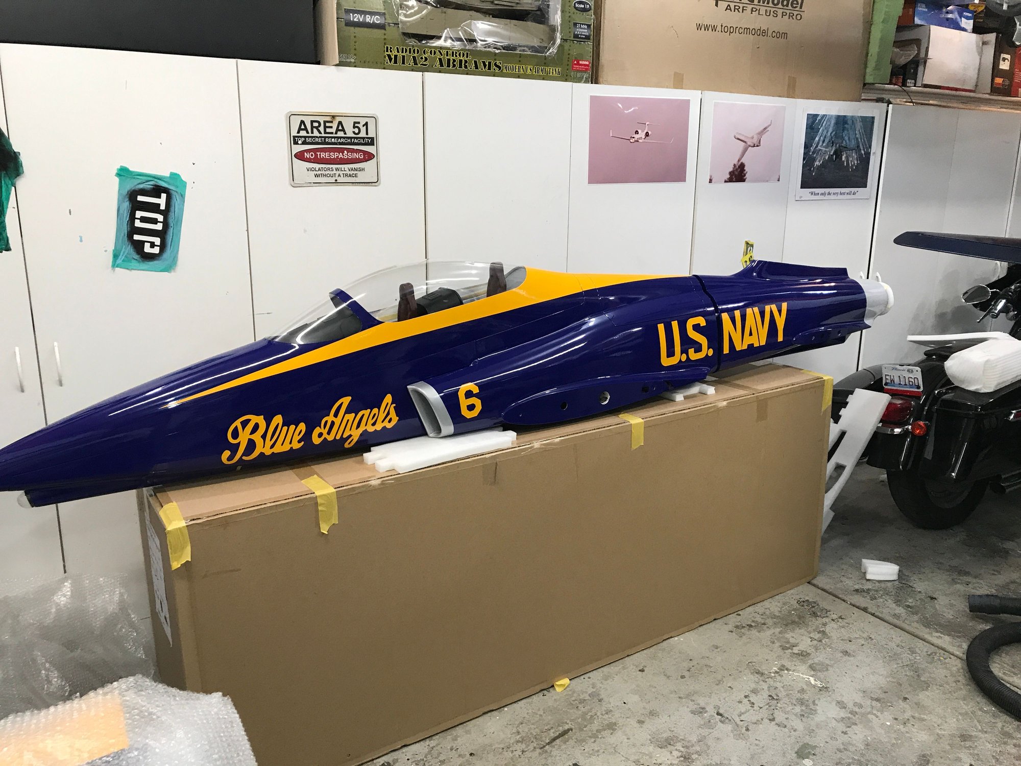

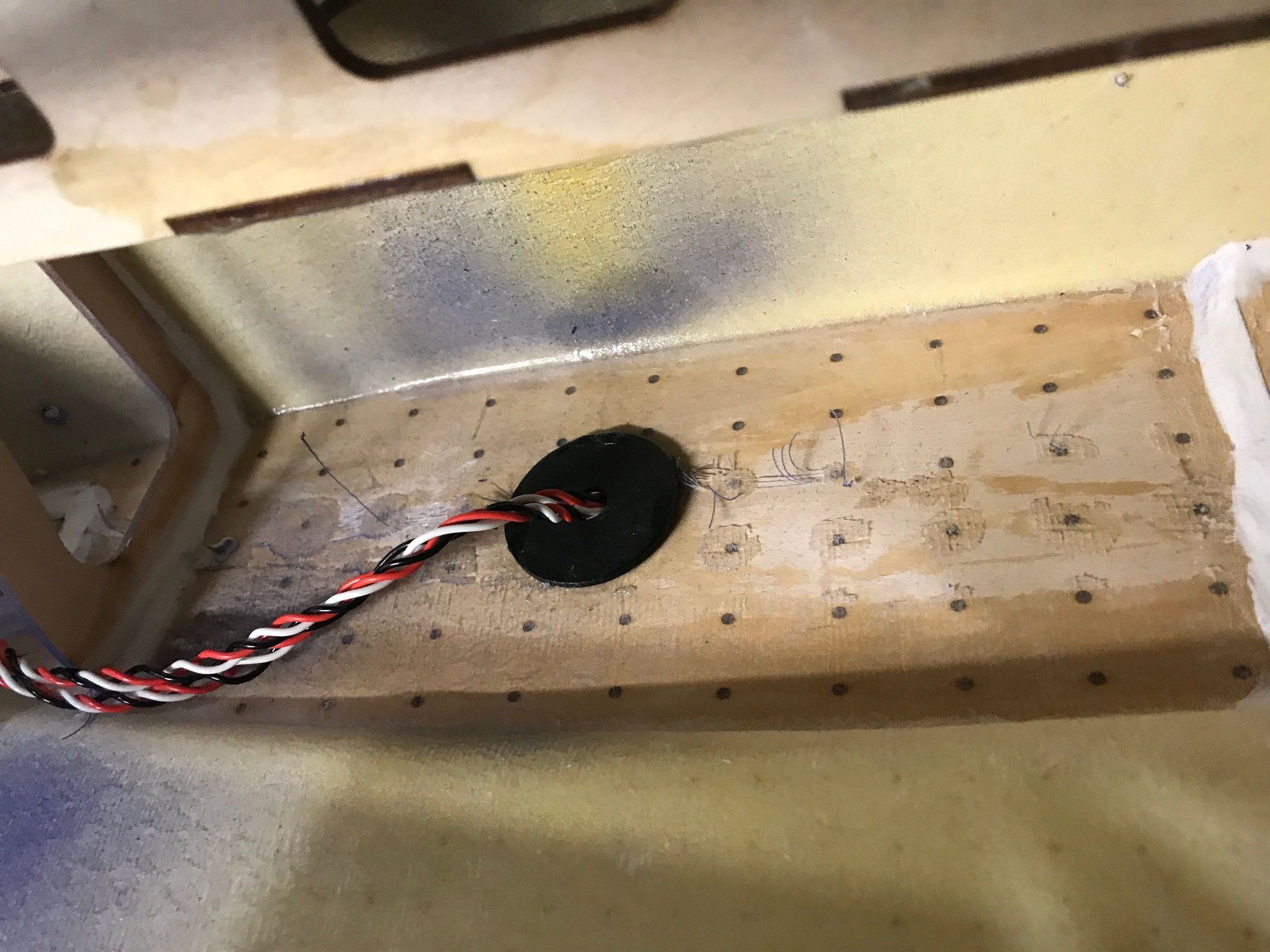

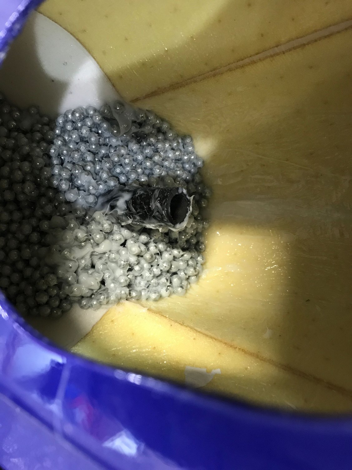

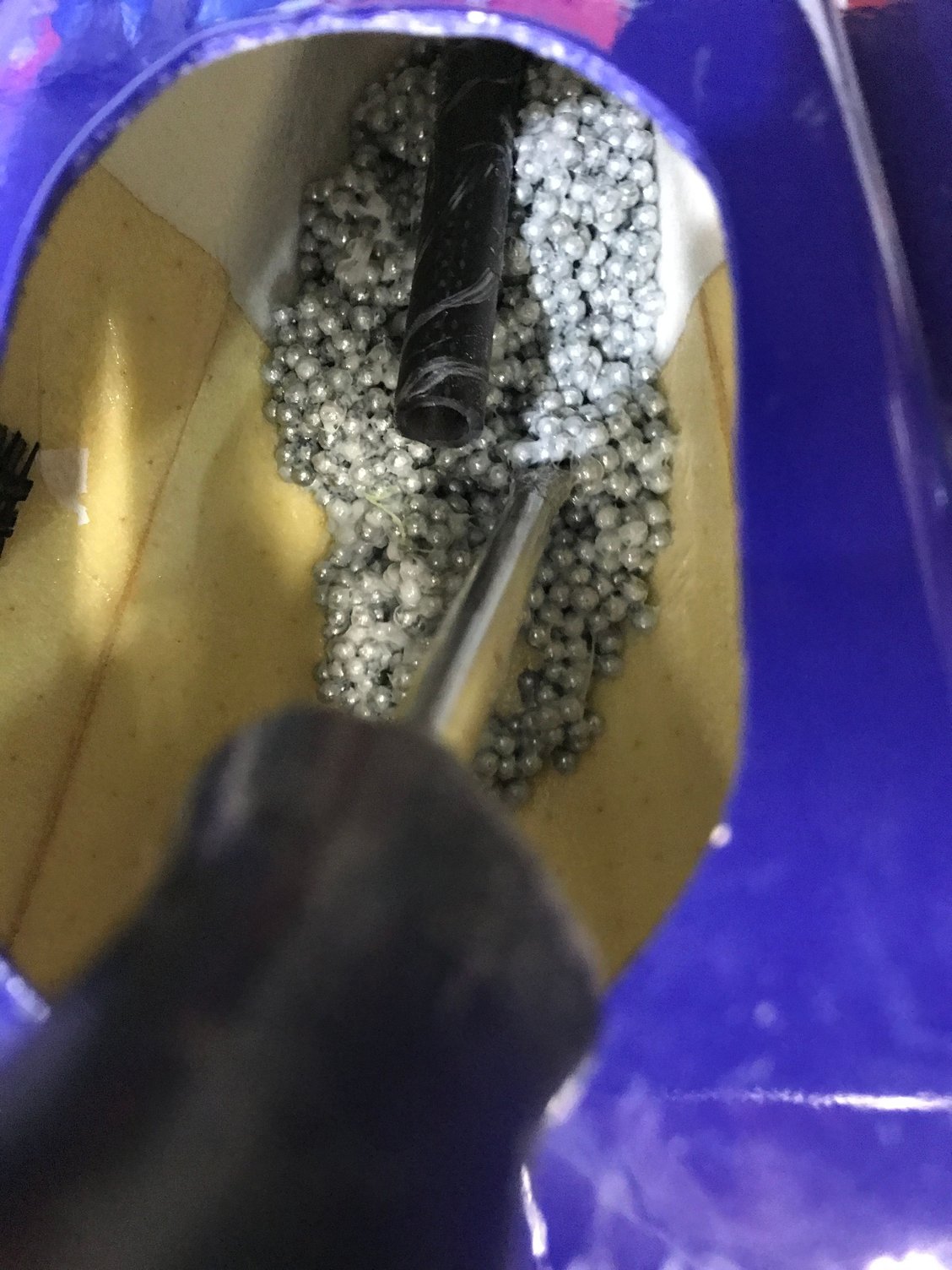

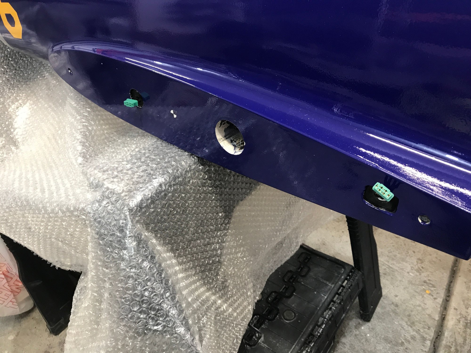

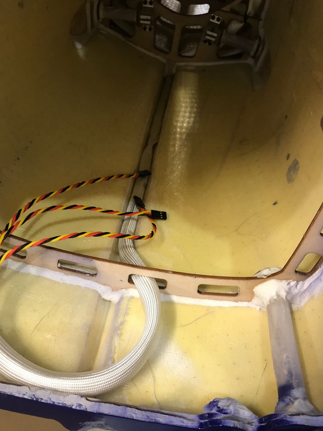

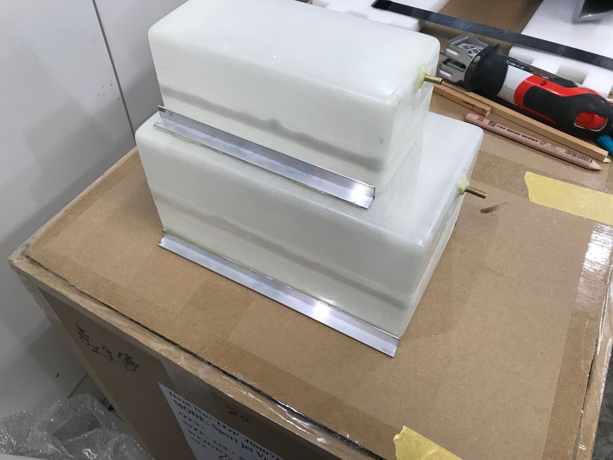

So after building the first one and seen it fly by my friend I decided to get one for me and I decided to get the blue angels color just look like something that resembles something like scale colors and I always like the blue angels jets. There someone improvements compared to the first one, single fuel tank,extra smoke tank better looking retracts and overall finish things fit slightly better, Iím changing the cheese aluminum tubes for rudder and elevators to carbonfiber thick wall tubes and they weigh much less maybe if Iím going to find a 4cm x 130cm main carbonfiber tube I might replace it for weight advantage, so Iím using the 1230 savox servos and usual building materials will post pictures from the buil

Old 09-29-2020, 06:25 AM
ravill
My Feedback: (11)
ravill's Avatar
Join Date: Jan 2003
Location: Granite Bay, Ca
Posts: 5,683
Received 76 Likes on 63 Posts
Looks great! How about some assembled pics!

What is the bump under the nose on it? I was considering one.

Just a design and have the light space there will post pictures

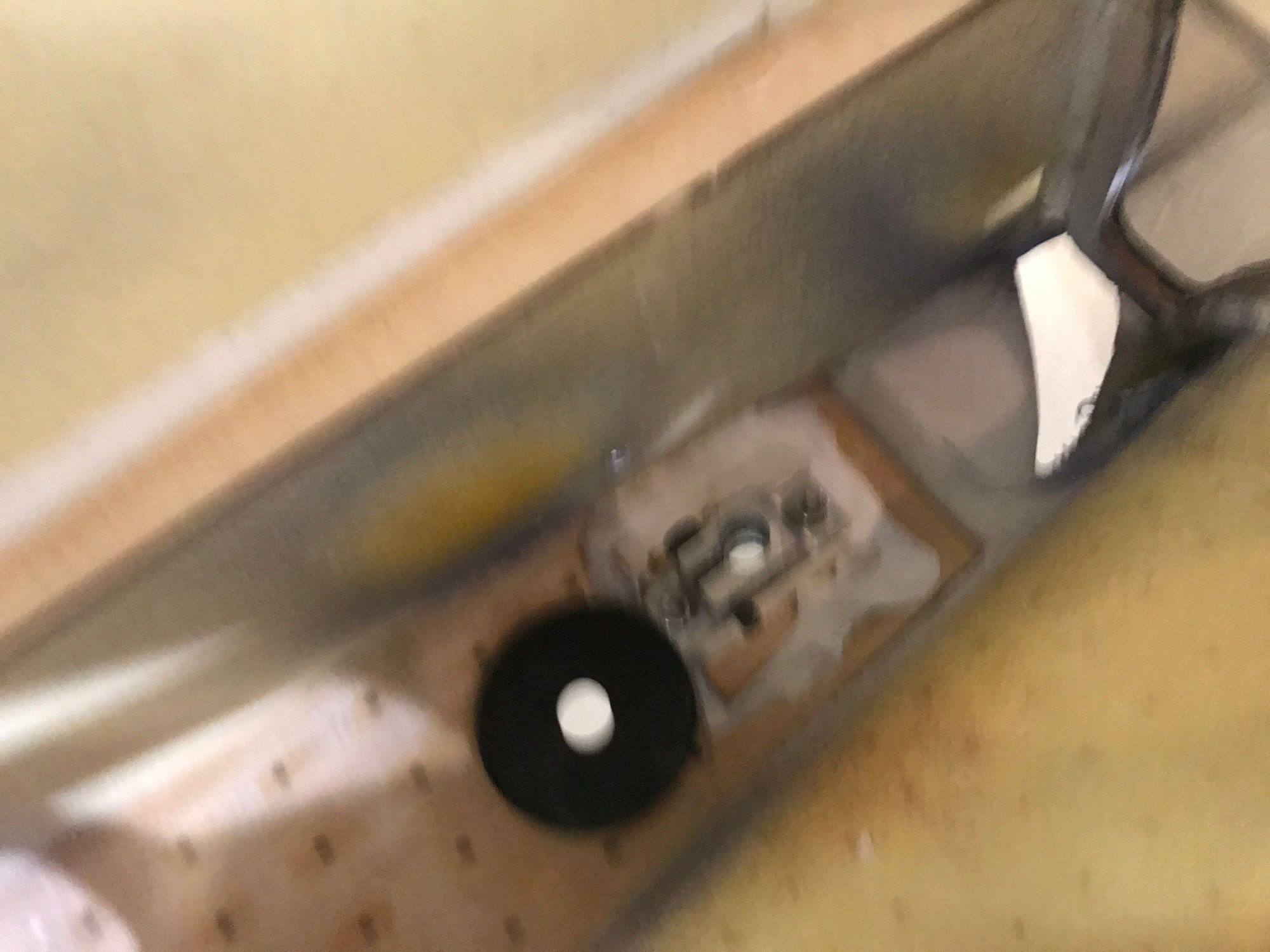

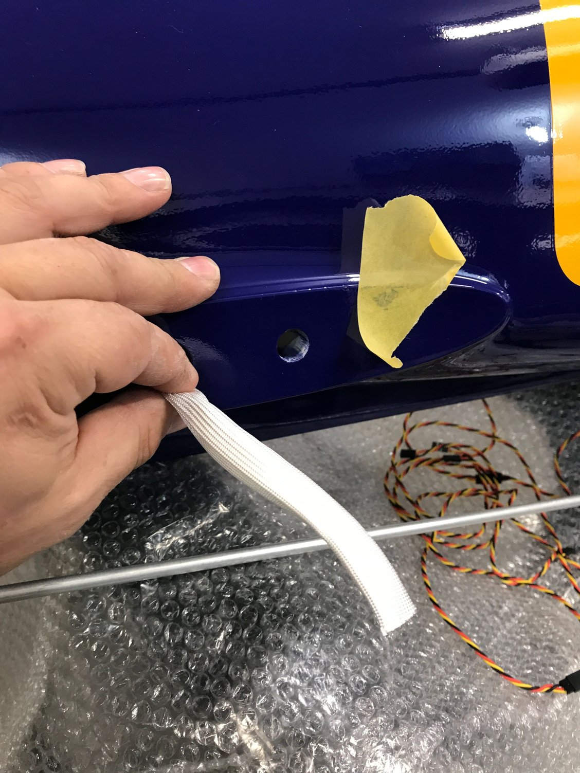

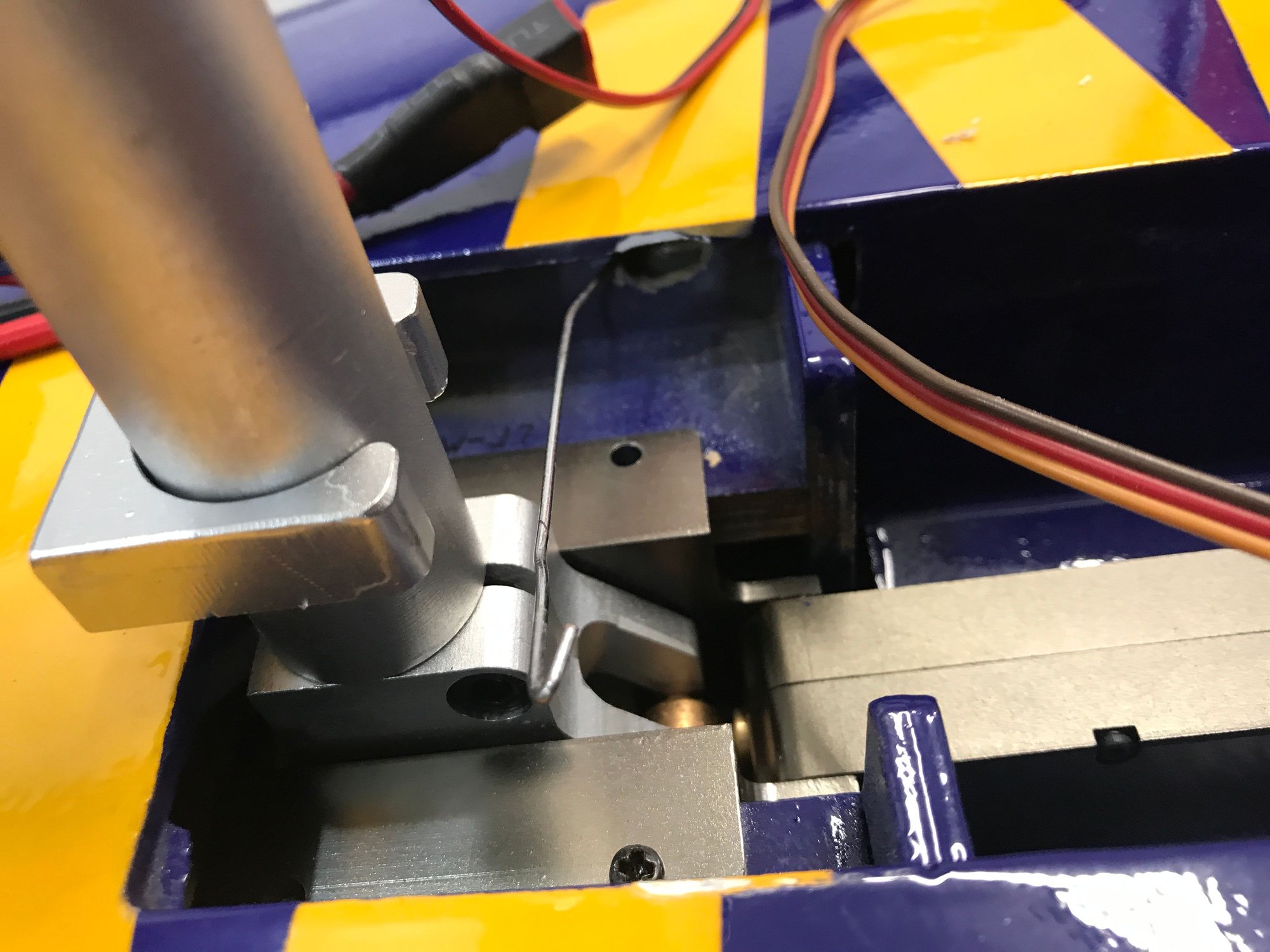

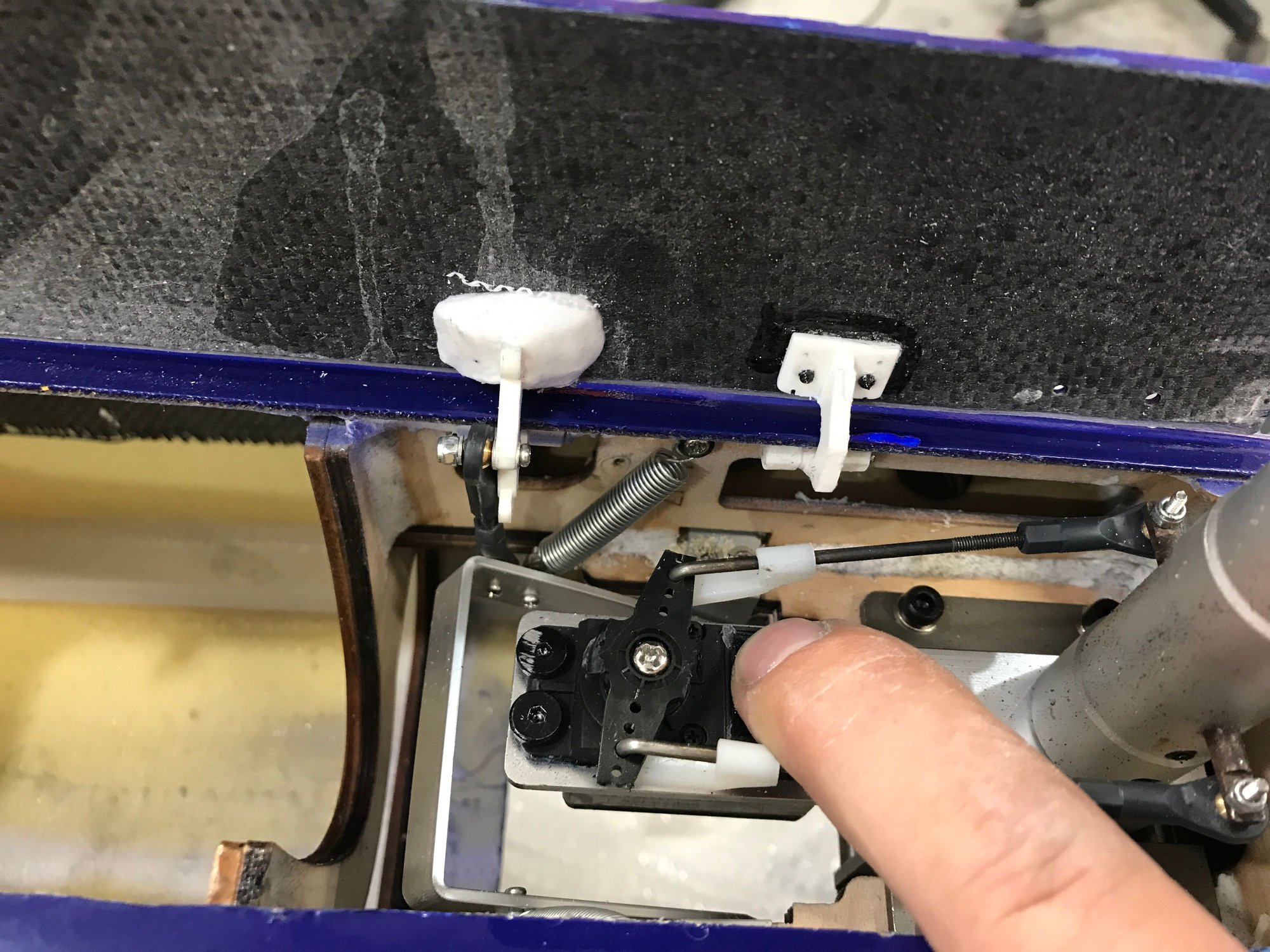

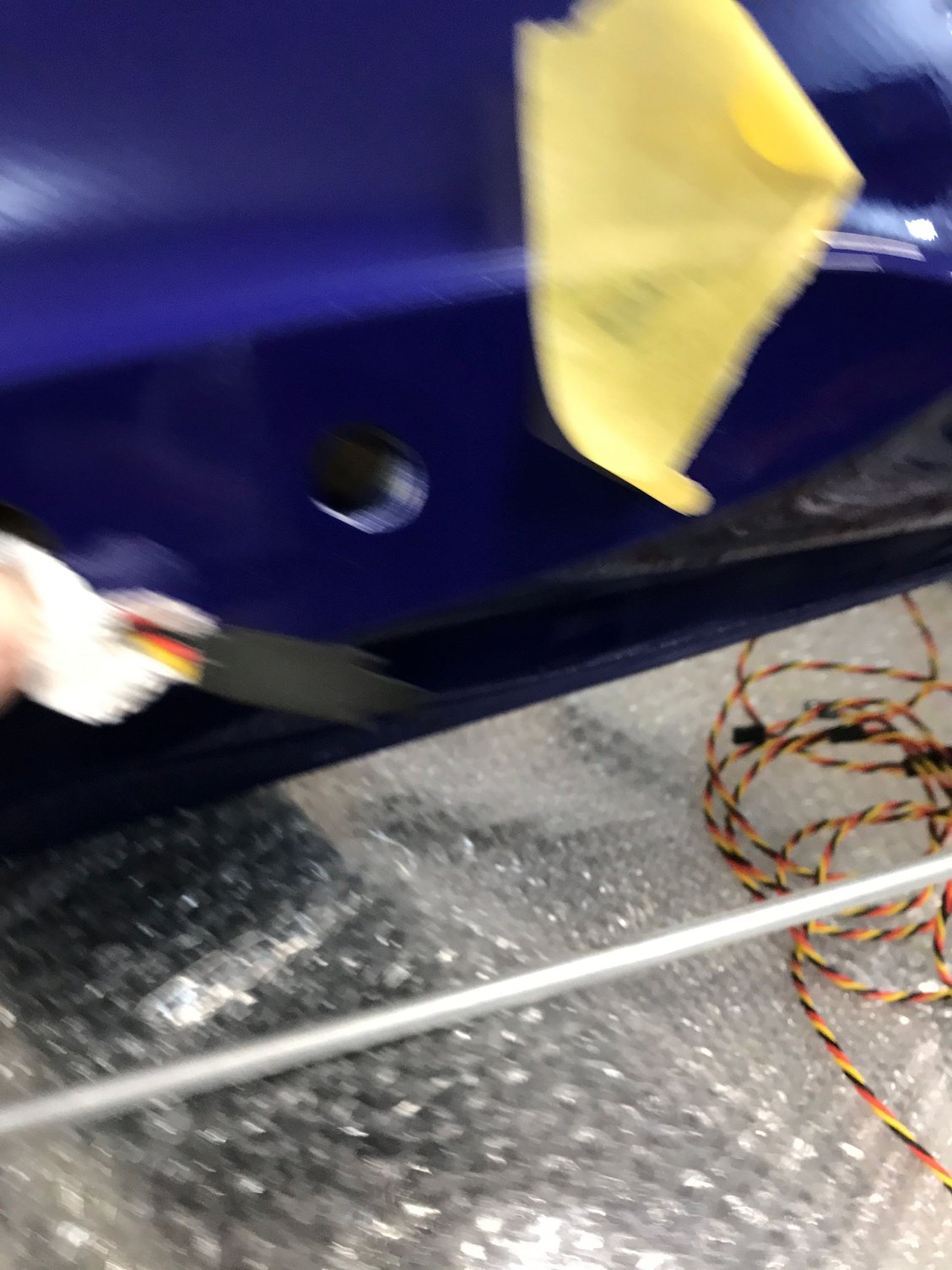

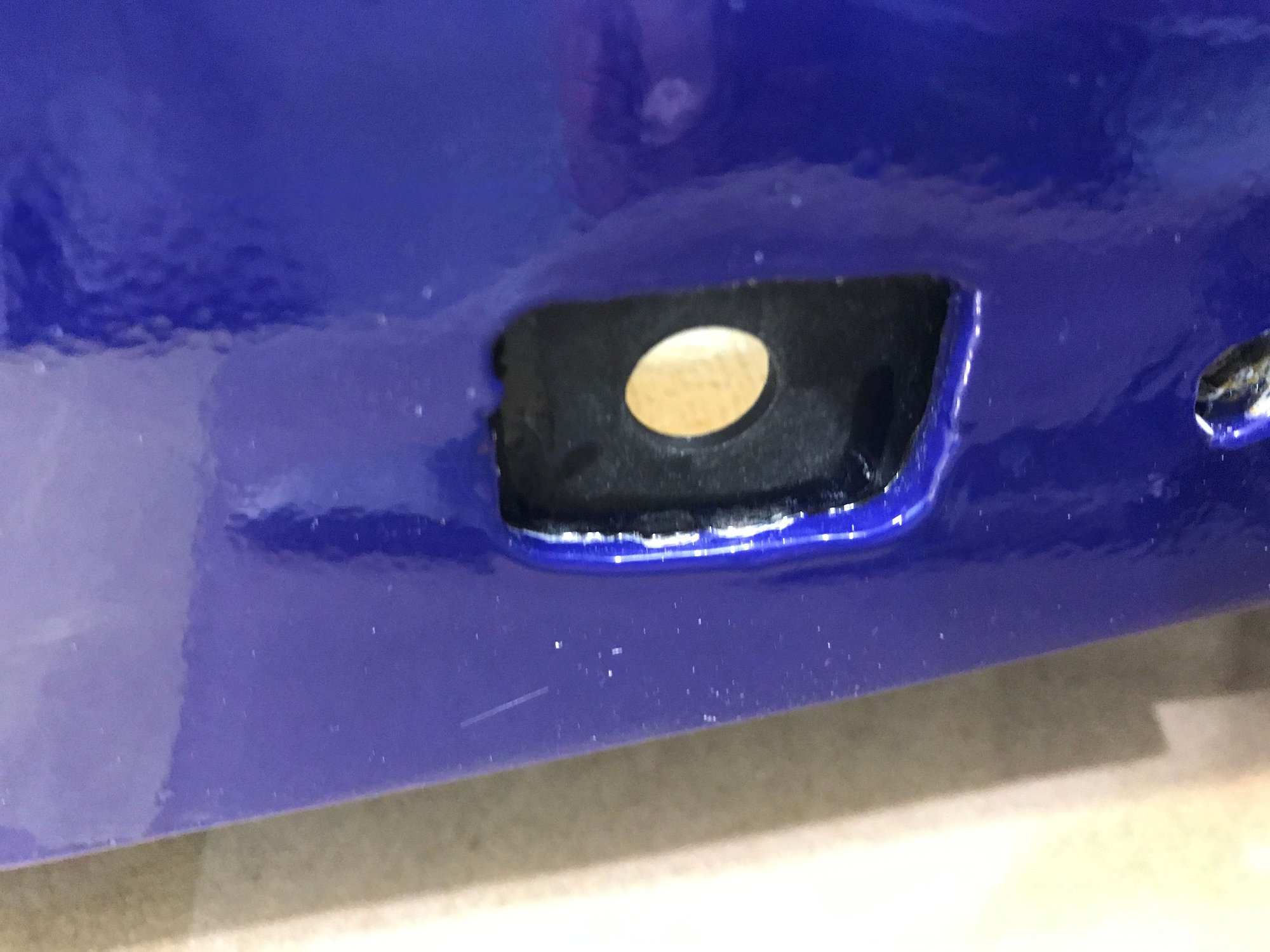

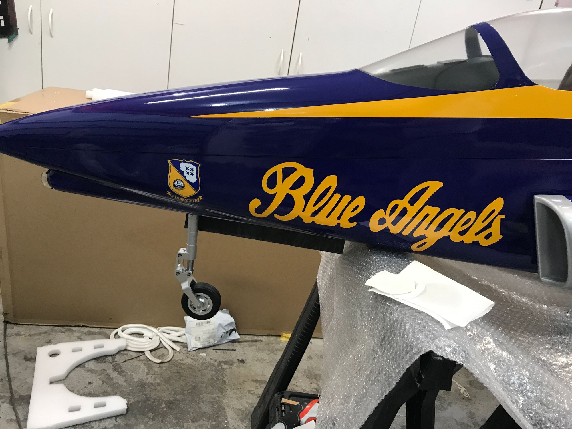

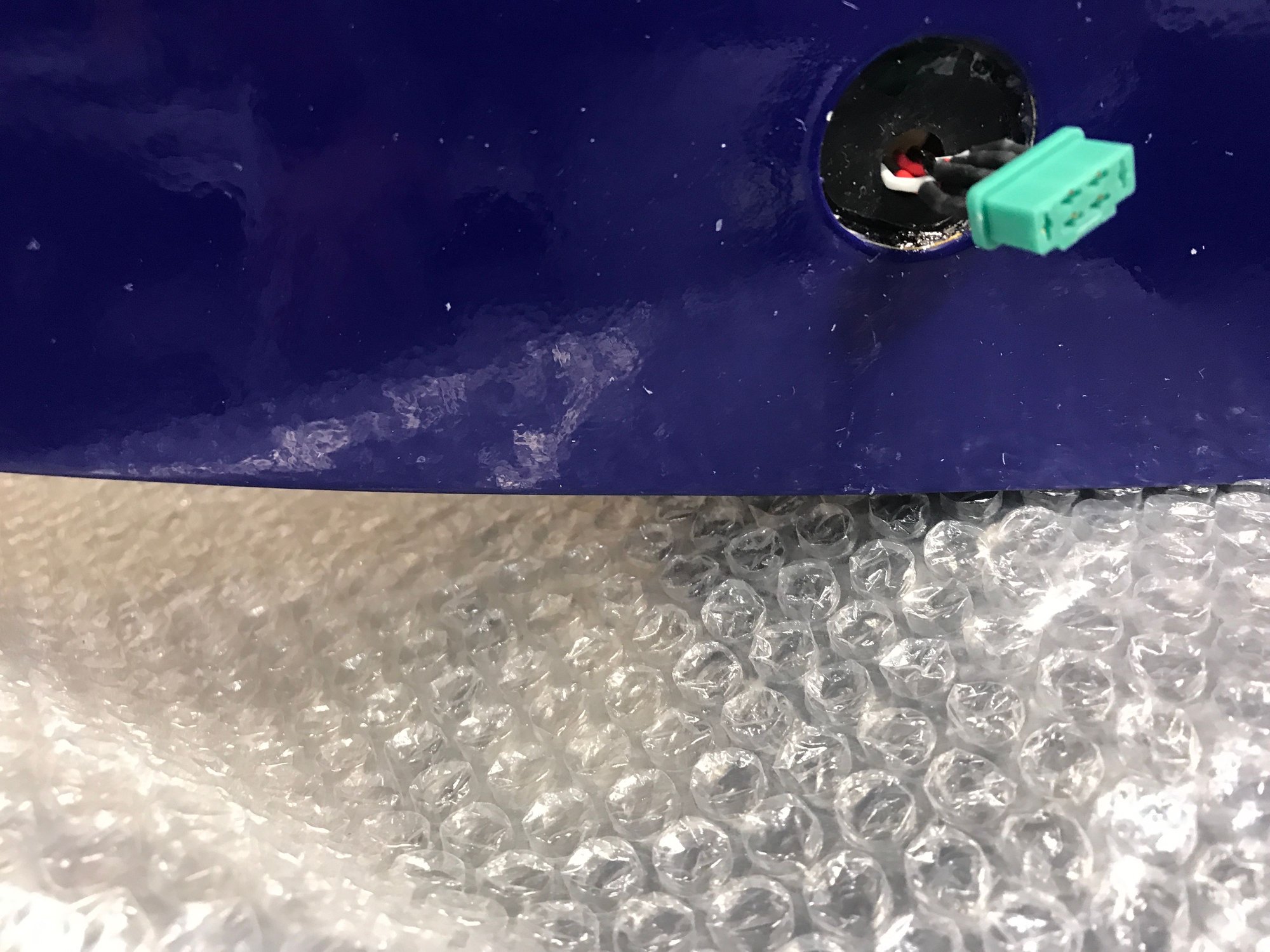

So this is the under nose detail, the landing light ,
and the rudder linkage, use drill gun and some good player to hold the vinyl ball link

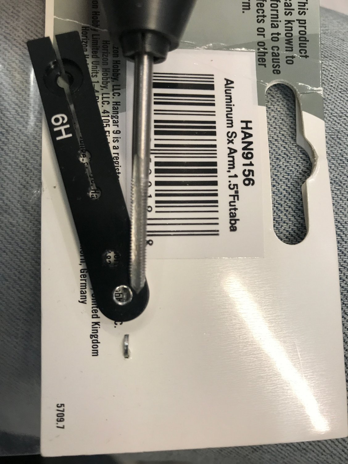

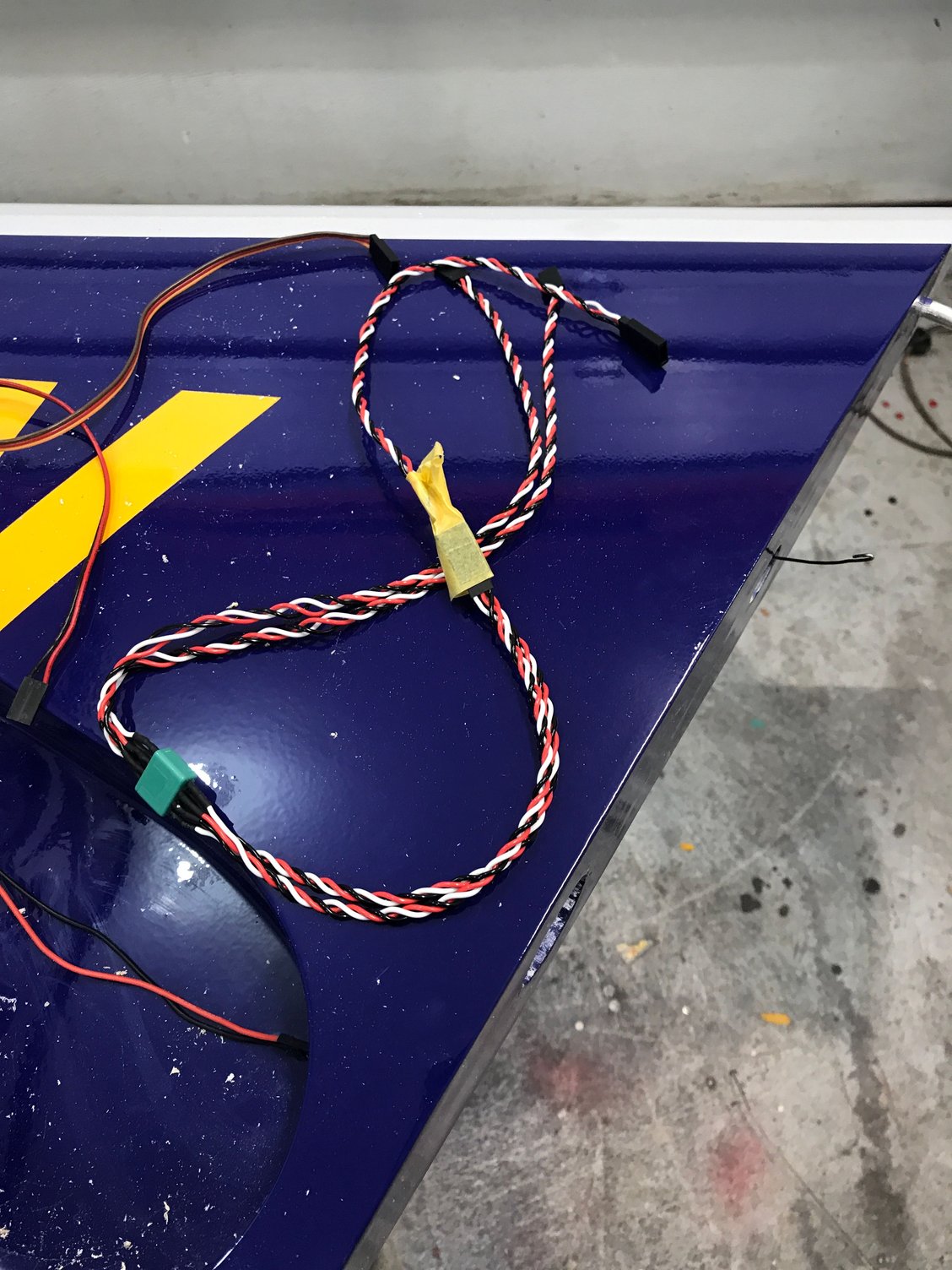

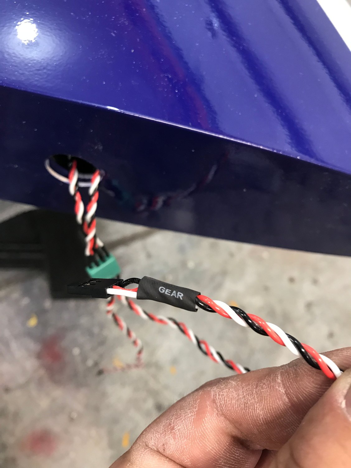

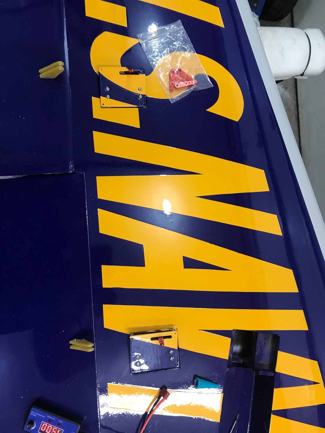

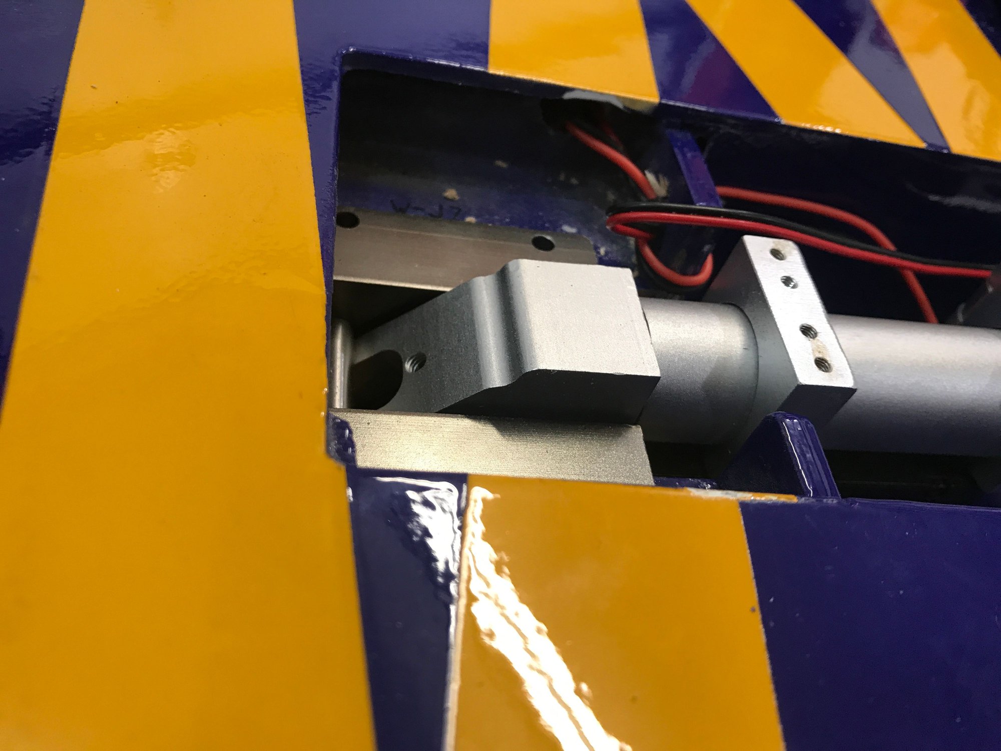

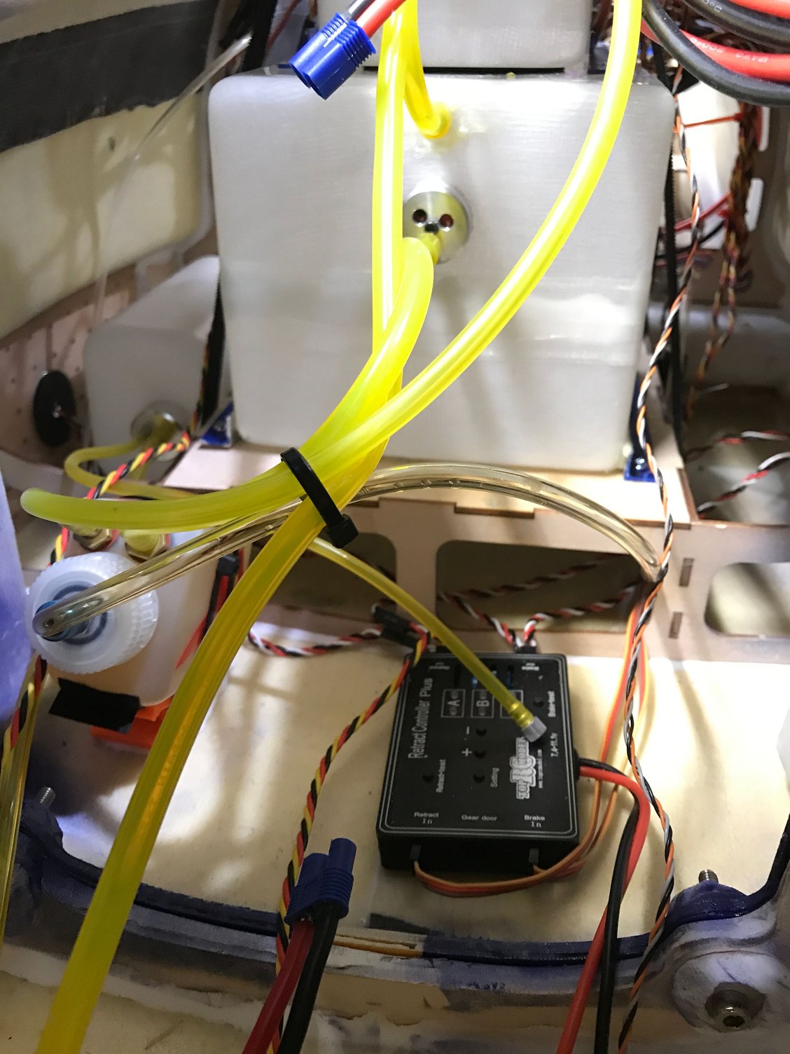

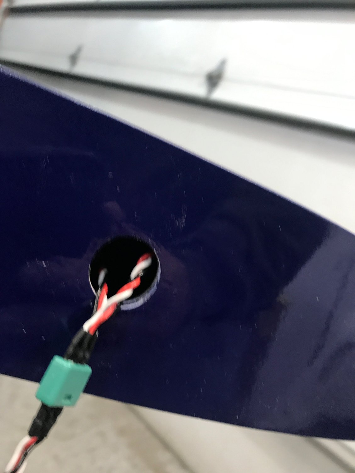

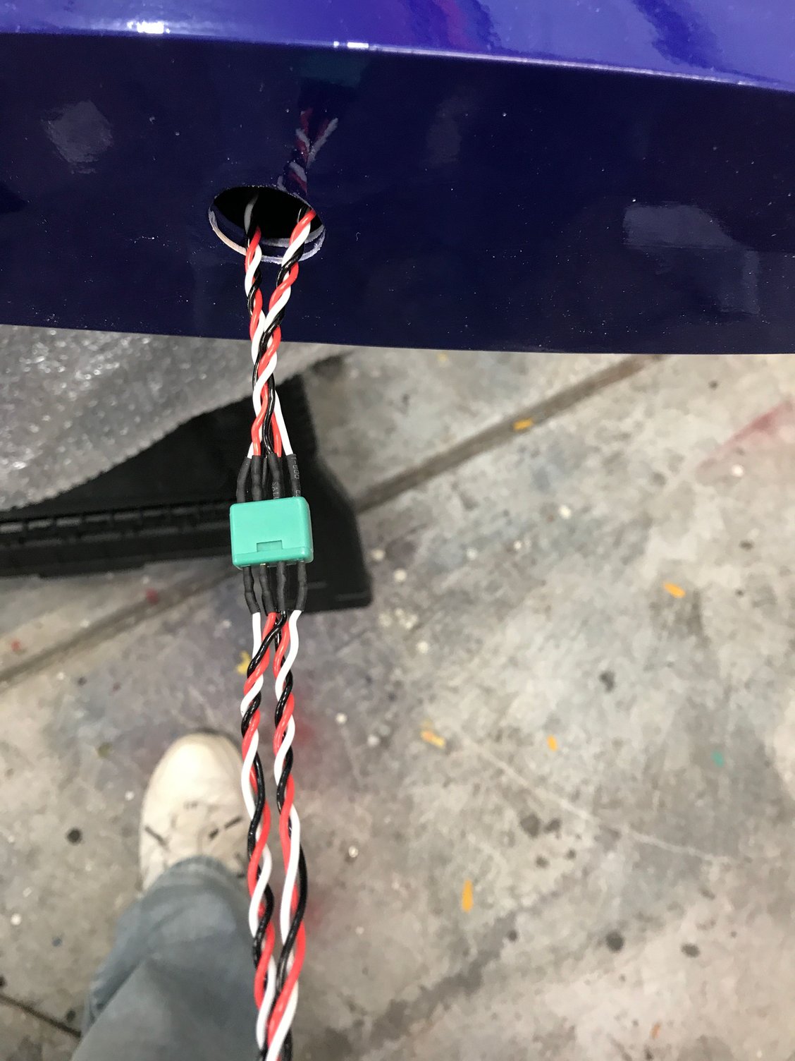

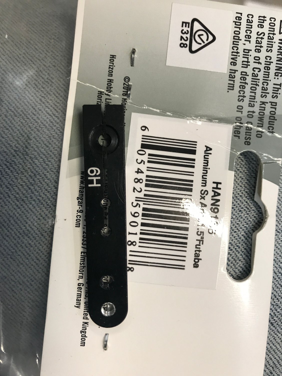

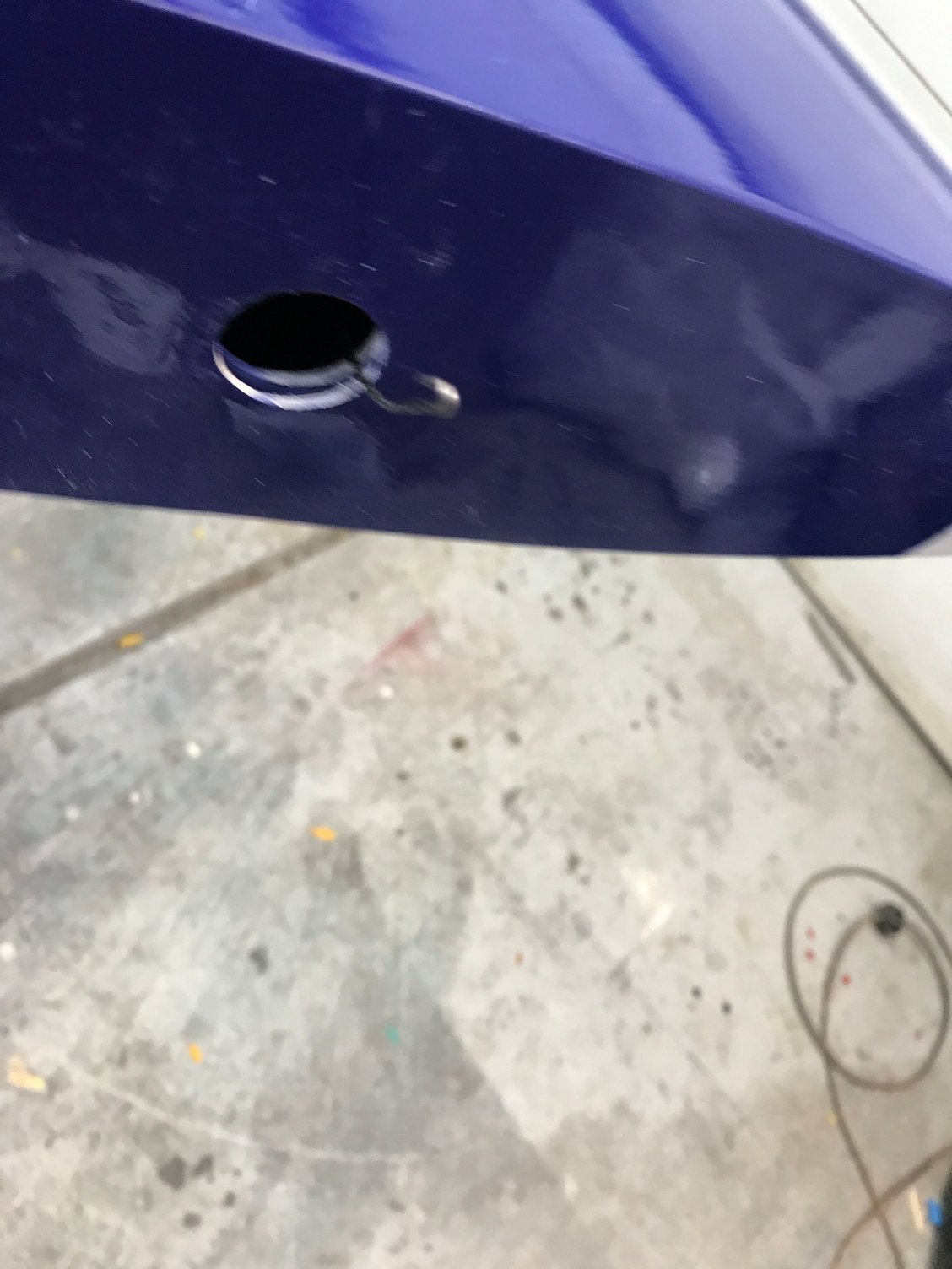

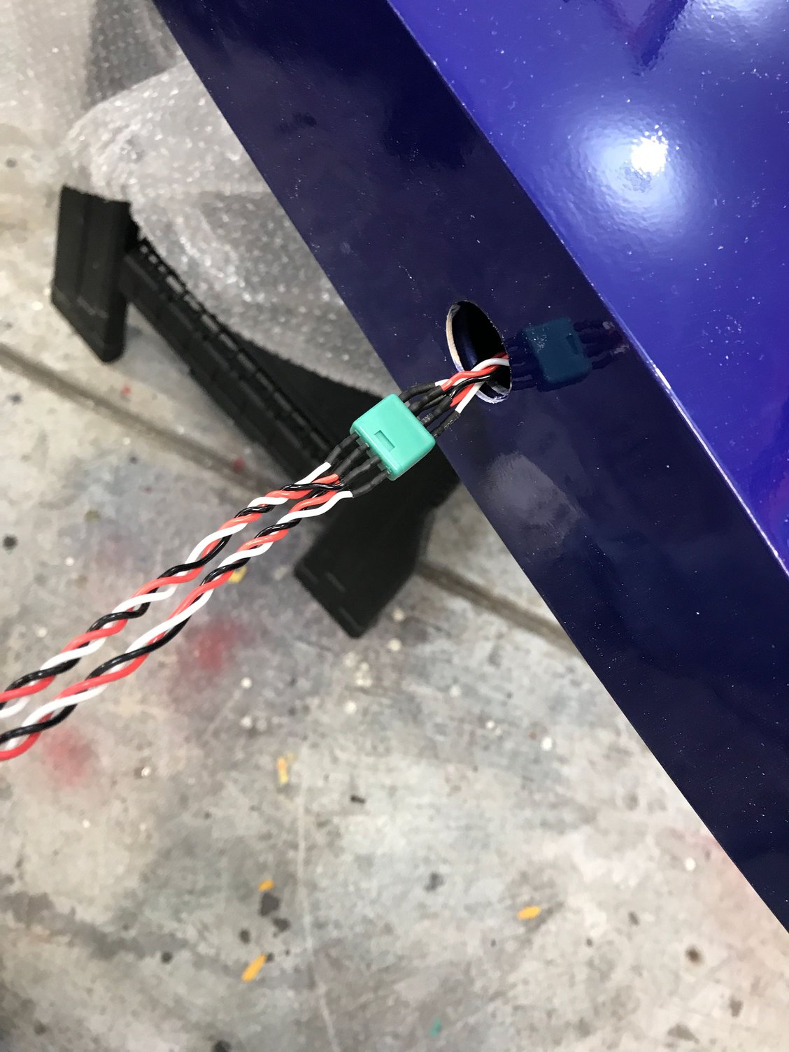

Iím working on it as fast as possible, so most likely yes, maybe the final stuff right there for final assembly and radio setup, so I find some right servo arms for the elevators the servos sitting deep in so the arms should be much longer about 1.3/4Ē for normal unlimited throws, got them from hangar 9 ,, they needed to be topped to 3mm for the ball links ,no problems to do this ,and i was looking to find the best way to do the cables for retracts and wing servos, so the retracts needed to have extra holes for cables and they will go to the front of the wings and the surface servos cables to the back of the main wing tube .and I glued the fuel tanks aluminum mount brackets.

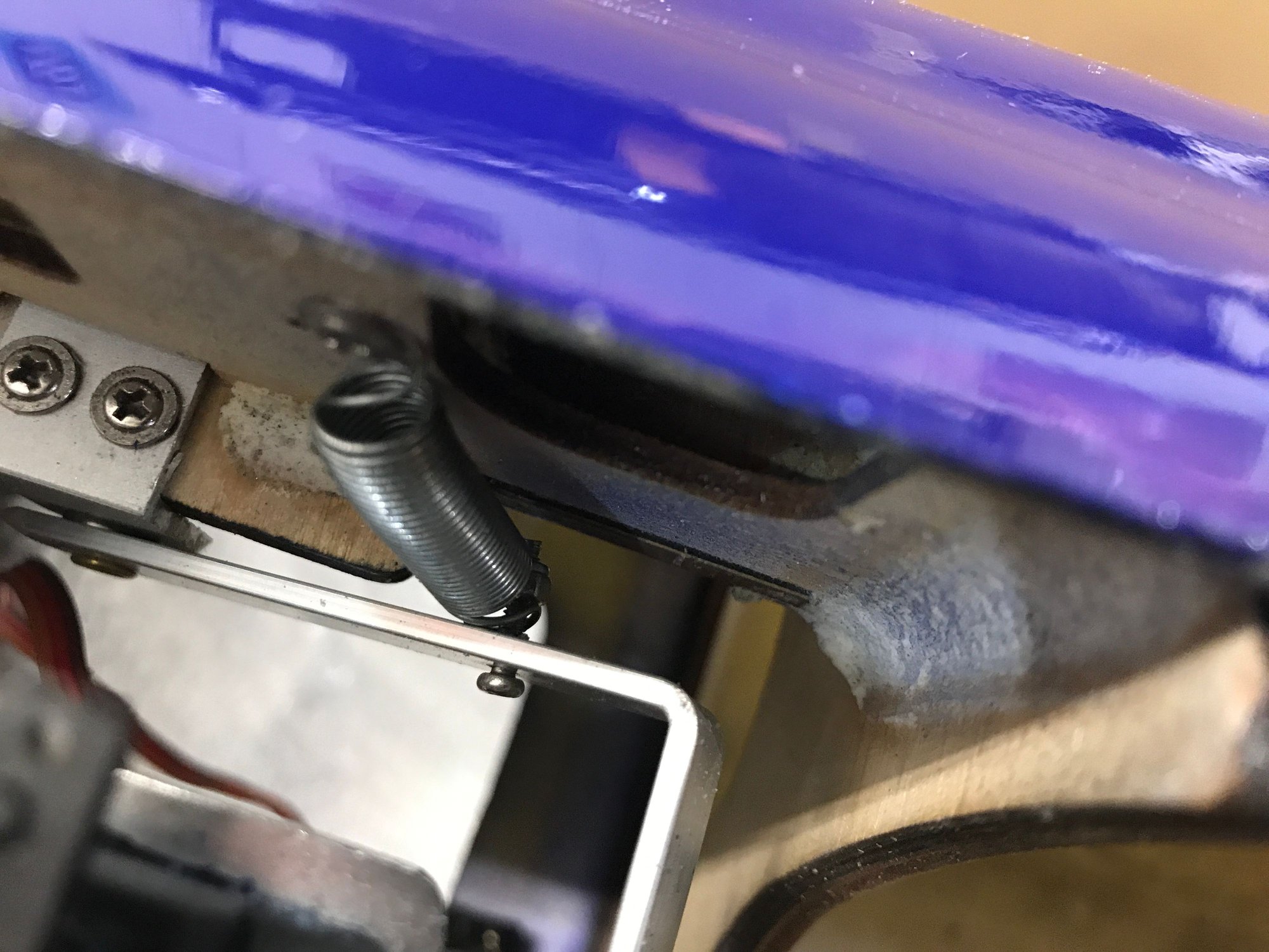

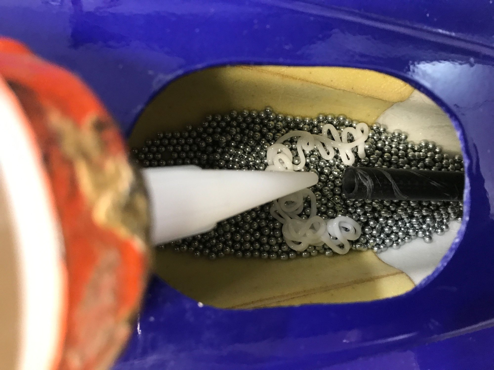

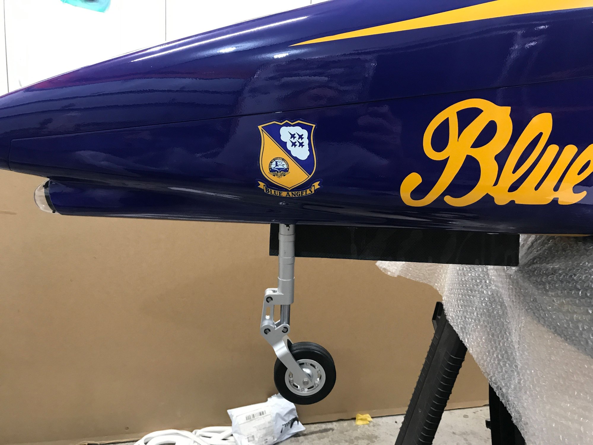

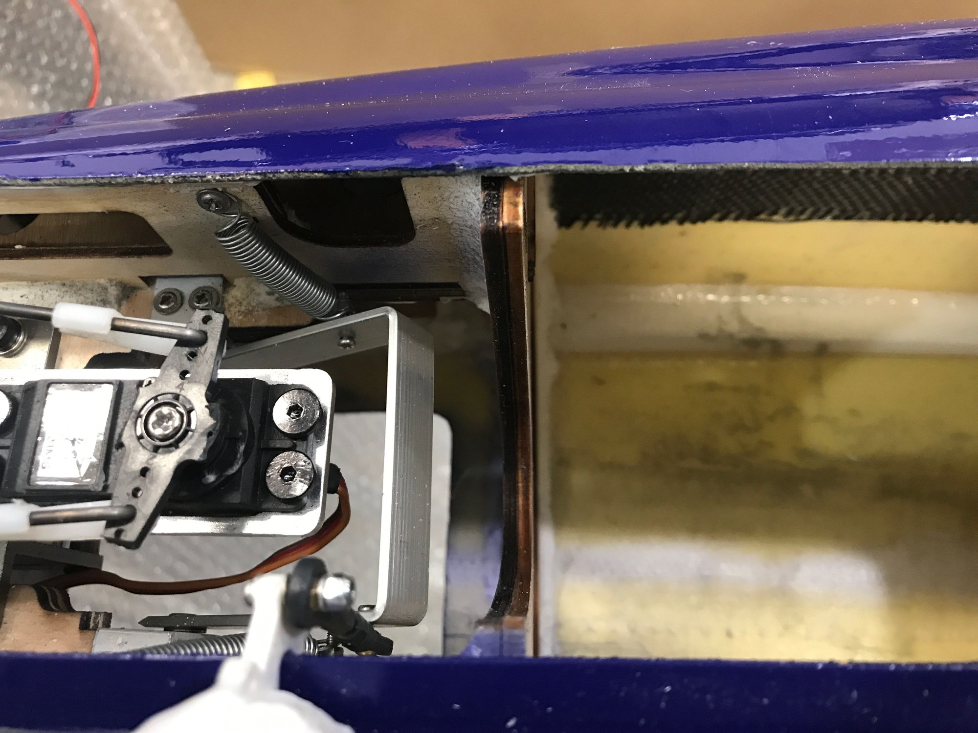

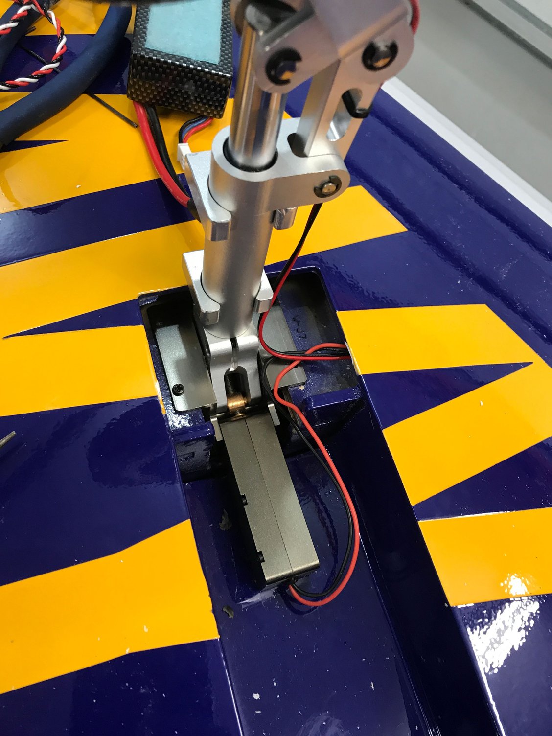

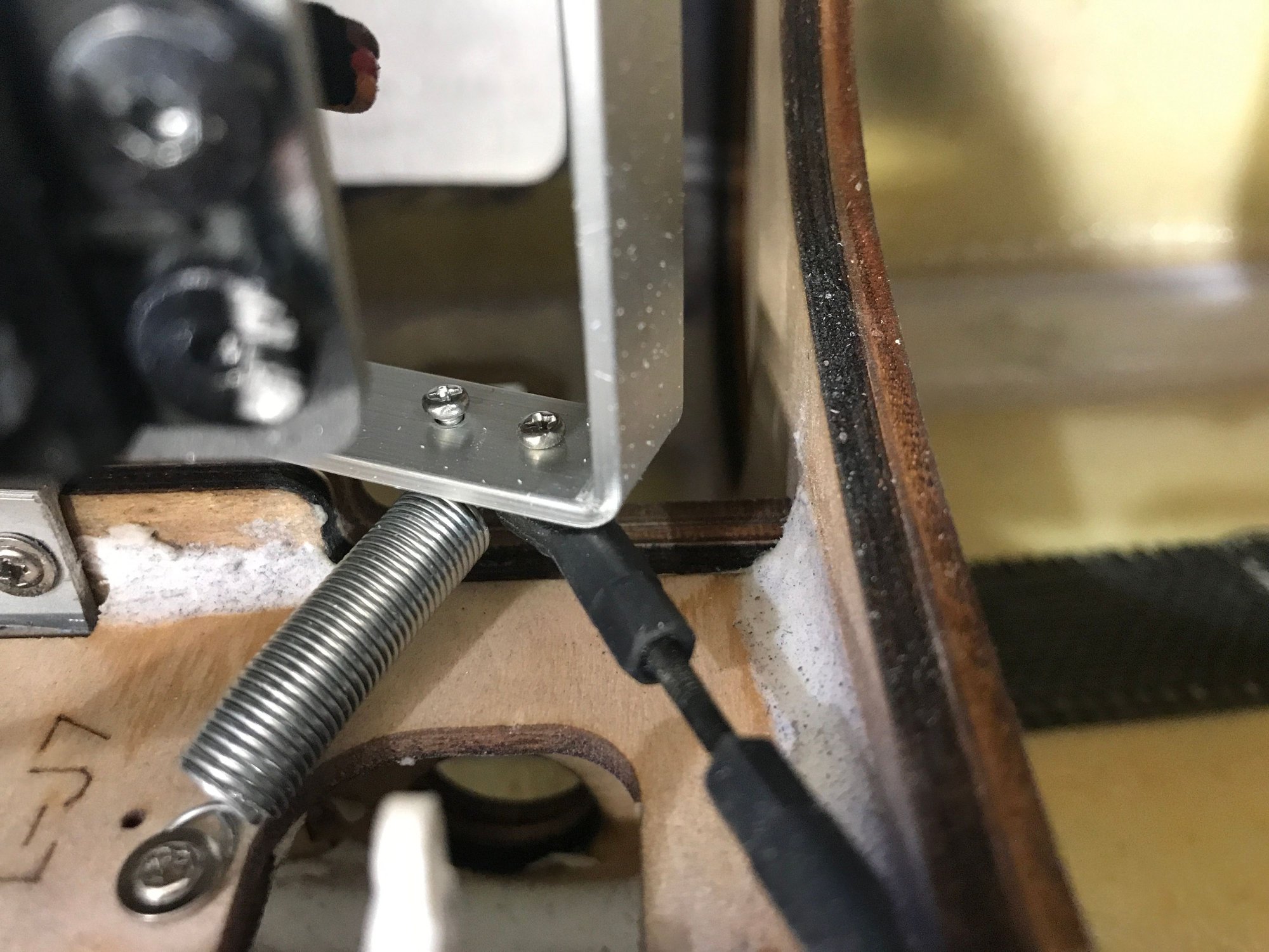

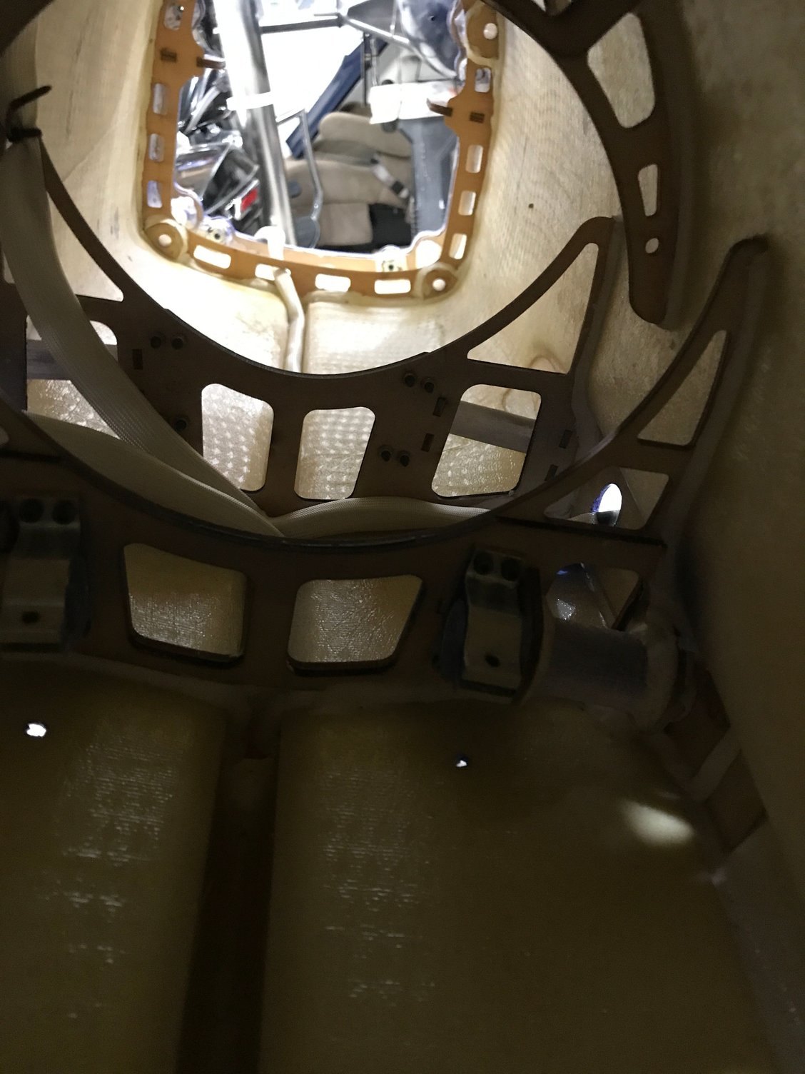

So today some assembly and working on the nightmare nose gear door maybe will be easier to install a servo or something else to open and close the gear door, the stock springs are total junk they donít hold the action and they go straight after some work so needed to go to friendly ACE store and find something much better and this front retract assembly with the gear door took me a long time, please install third gear door hinge to support the not so stiff door, o and I installed some cool stuff designed by myself the rubber washers to stop the cables connectors to fall in to the fuselage very easy to do just glue them from inside with ca ,they actually work well, and I tinted the glass with some 3D golden green specially maybe tint looks much better in sun light.

Changing all the aluminum tubes to carbonfiber, for strength and weight purposes maybe less weight at the front the weight different is about the rudder servo about 1/5 lbs total

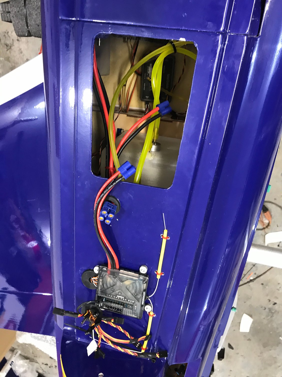

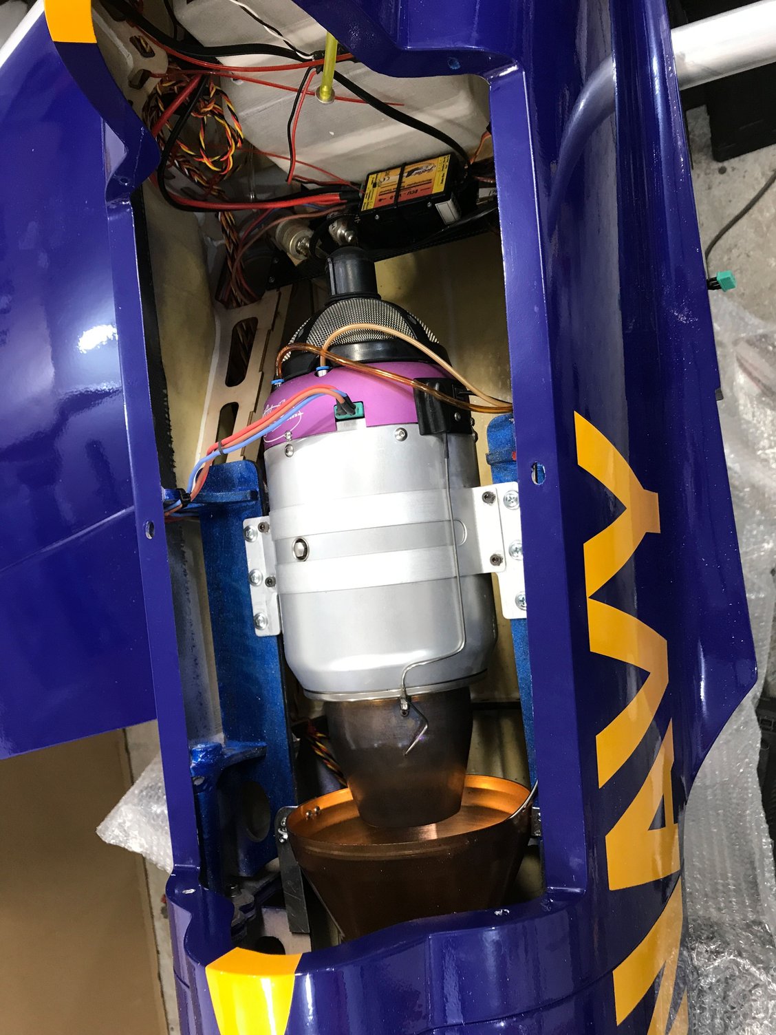

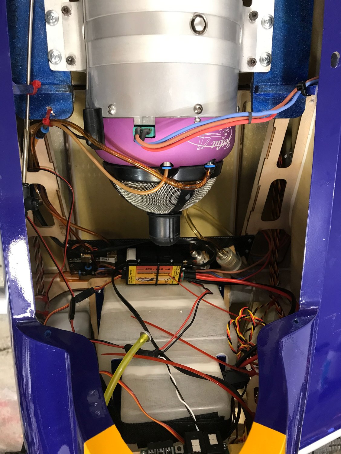

Ok so the jet is almost 100% finished, just needs radio programming and corrections to the cg and need to check the turbine before living to the jet fall classics to make sure that the turbine actually works with the long power cables to the battery last time I have problems with not supplying the right amount of power to the turbine ecu because the cables have been too long and only 14 gage, so letís see what happens.

Just the pilot install for the blue angels voyager

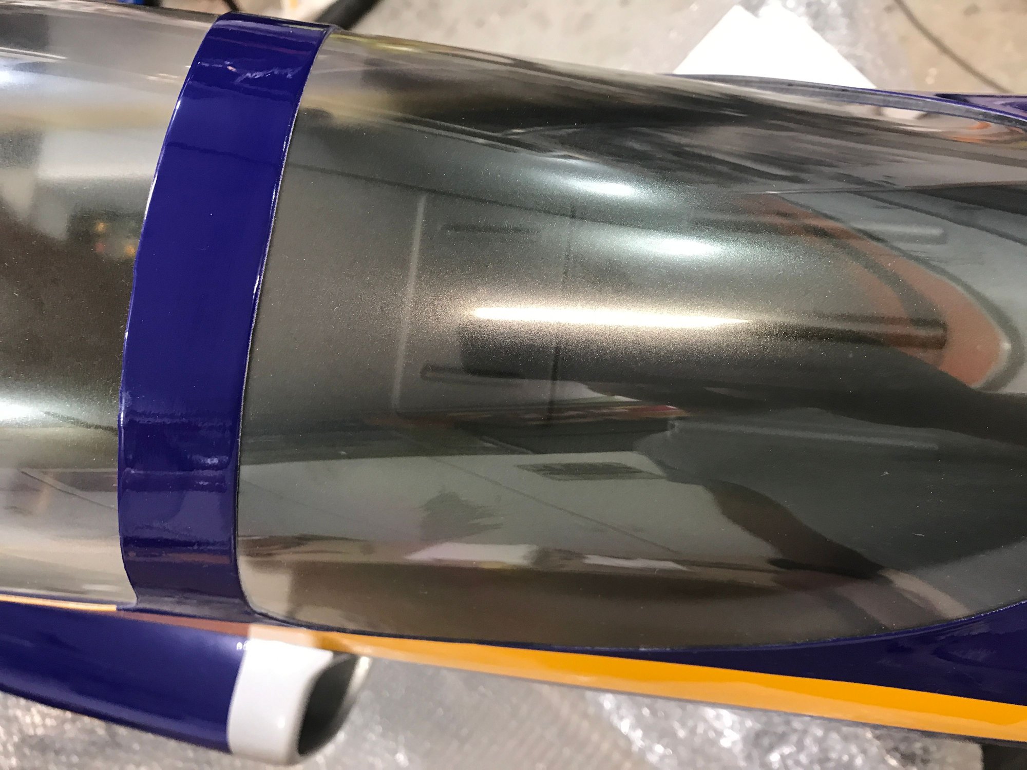

Just a finishing touch, I think that the pilots itís a must for glass cockpit, but I still think that they should be a option with just painted frame and no clear canopy, probably less expensive and easier to manage, with the clear canopy you need to be extra carful to not scratch and heat the vacuum molded interior ,they are very sensitive to sunlight and heat.
It's al look-a-like feature taken from a F4 Phantom which houses InfraRed Search&Track sensors

Iím not sure why that thing is under the nose, but I installed there landing light , not sure if this is just added to make it look different than other sport jets.
