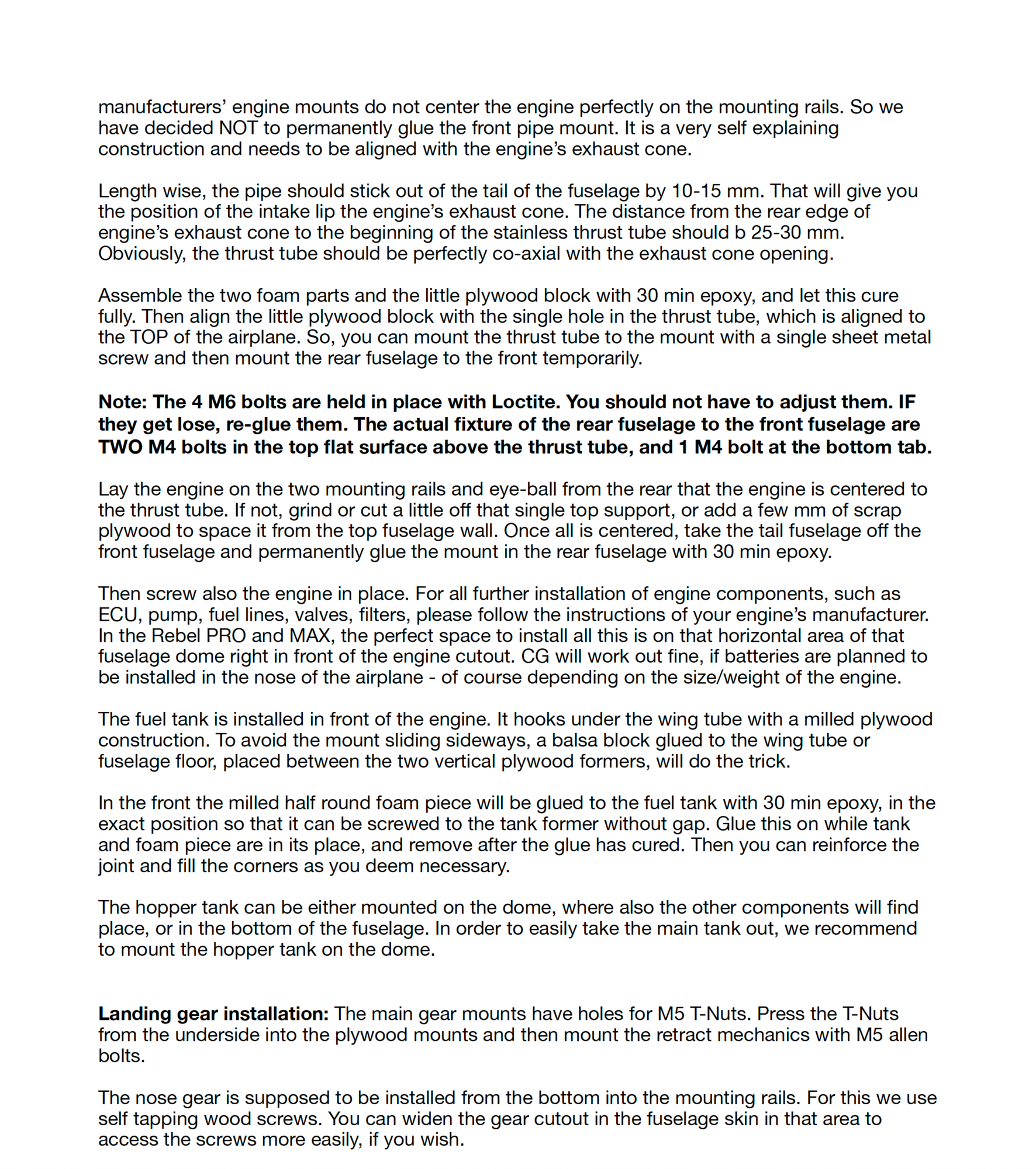

So I learned some stuff. The RB45 controller has 2 versions, and only one is for the er50. The one setup for er50 has more time built in to fully allow the retract to fully cycle, the other rb45 will short cycle the gear up and down.
Got a hold of greg alderman who is the guy for these things. He can replace the power board on these. I also ordered one from europe.
100% my fault. I was thinking about the cheaper eletronic retracts I have where they are controlled by PWM and 3 wires. SO for servos and these types of gear, I make a multi connector for the wing that all items in the wing share a common ground. This means a standard MPX connector can connect 5 devices all with a common ground.
Get where Im going here? I put the brake and the retract on a common ground. However this is a two wire system, and the controller will reverse the voltage so in reality, there is no ground.
I only had the brakes hooked up a bit during testing, probably why the unit was getting hot from day 1. Later I disconnected the brakes and was testing the gear to route the wiring correctly for the brakes, several cycles.
On my final day before flight I hooked the brakes up. I believe what happed is I had the brakes actuated, and then did a retract cycle and it was opposite polarity of the brakes and BOOM. Nice little arc welder.
NO damage anywhere on the jet thank god, and the unit still functions, even the front continues to function, but the mains wont move and god I hope they are ok.
In retrospect this all makes 100% sense, and I am not the first one to do this.
So Im on the hunt for a 4 pin connector, I may opt for just using a multiplex.
Great service from both carf and greg.
1 week delay on maiden. No biggie

Here are the CARF Manual specs for Rebel Max -Pro jets.
I set my engine distance at 27 mm, average distance.
sewbusy (09-27-2022)
