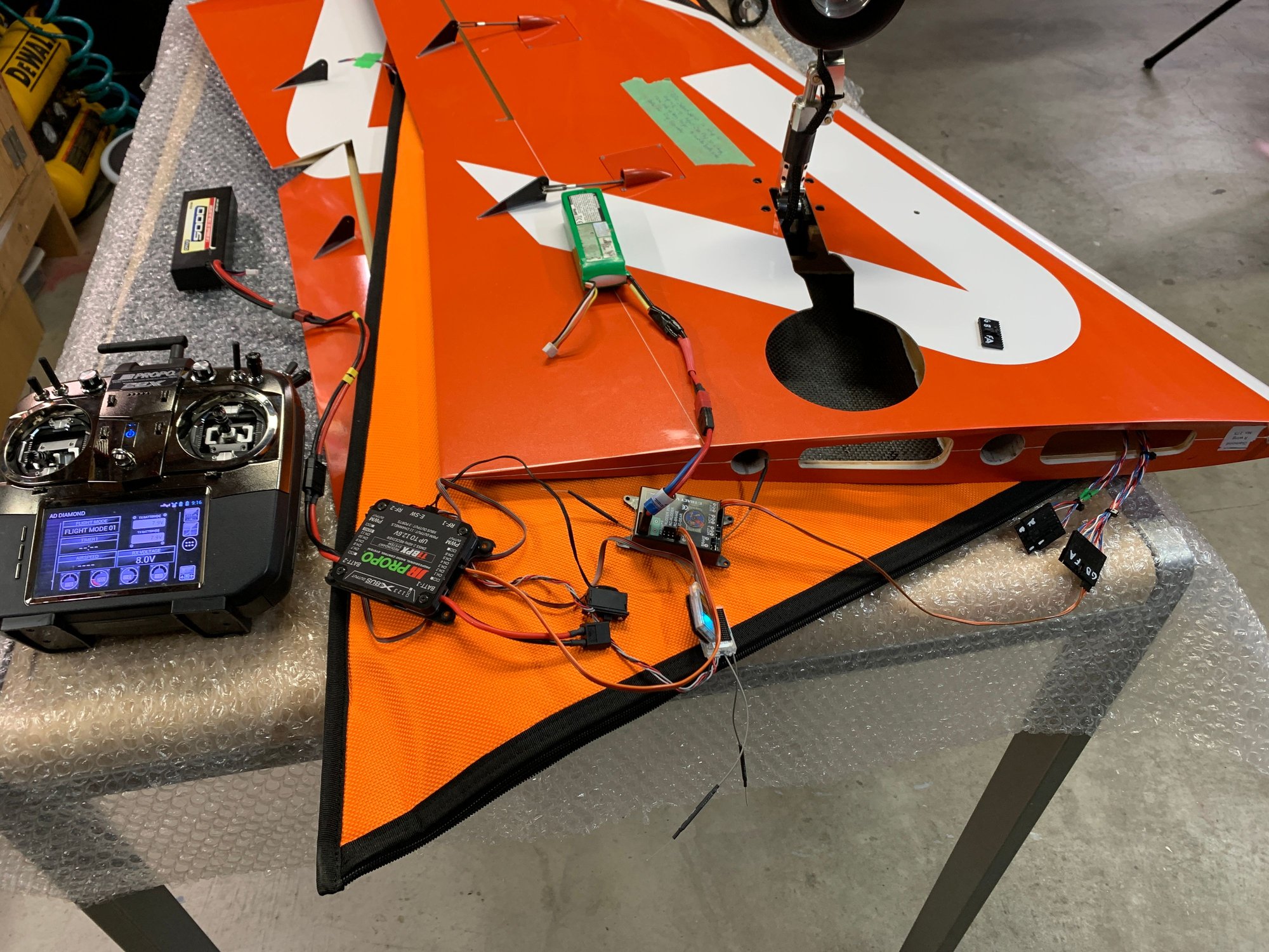

Wing connectors complete. I like to use the pin/female side of the connector on the wing so you can easily attached your receiver with a male connection and operate the different surfaces off the plane.

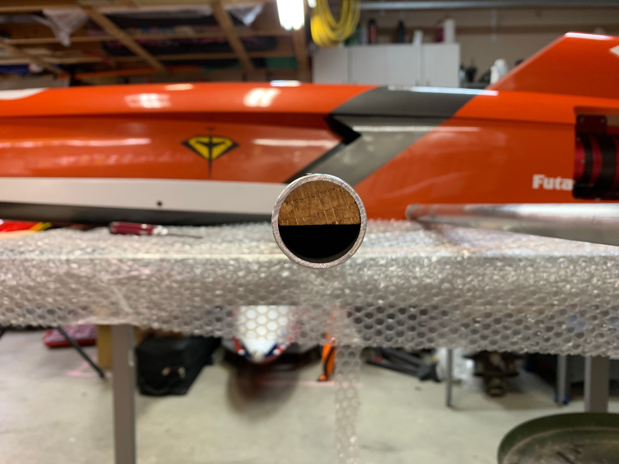

Wing fastening is next. Installed wing tubes into airframe so equal distance on both sides of airframe. Marked tube with marker at fuselage.
dowels inserted into main wing tube. Did one wing at a time. Install wing. Drill hole through tube. Remove wing. Install dowel, blind nut, glue on dowel and main wing bolt.
Wait till it all cures and trial fit wing. Used 4mm bolts in this area.

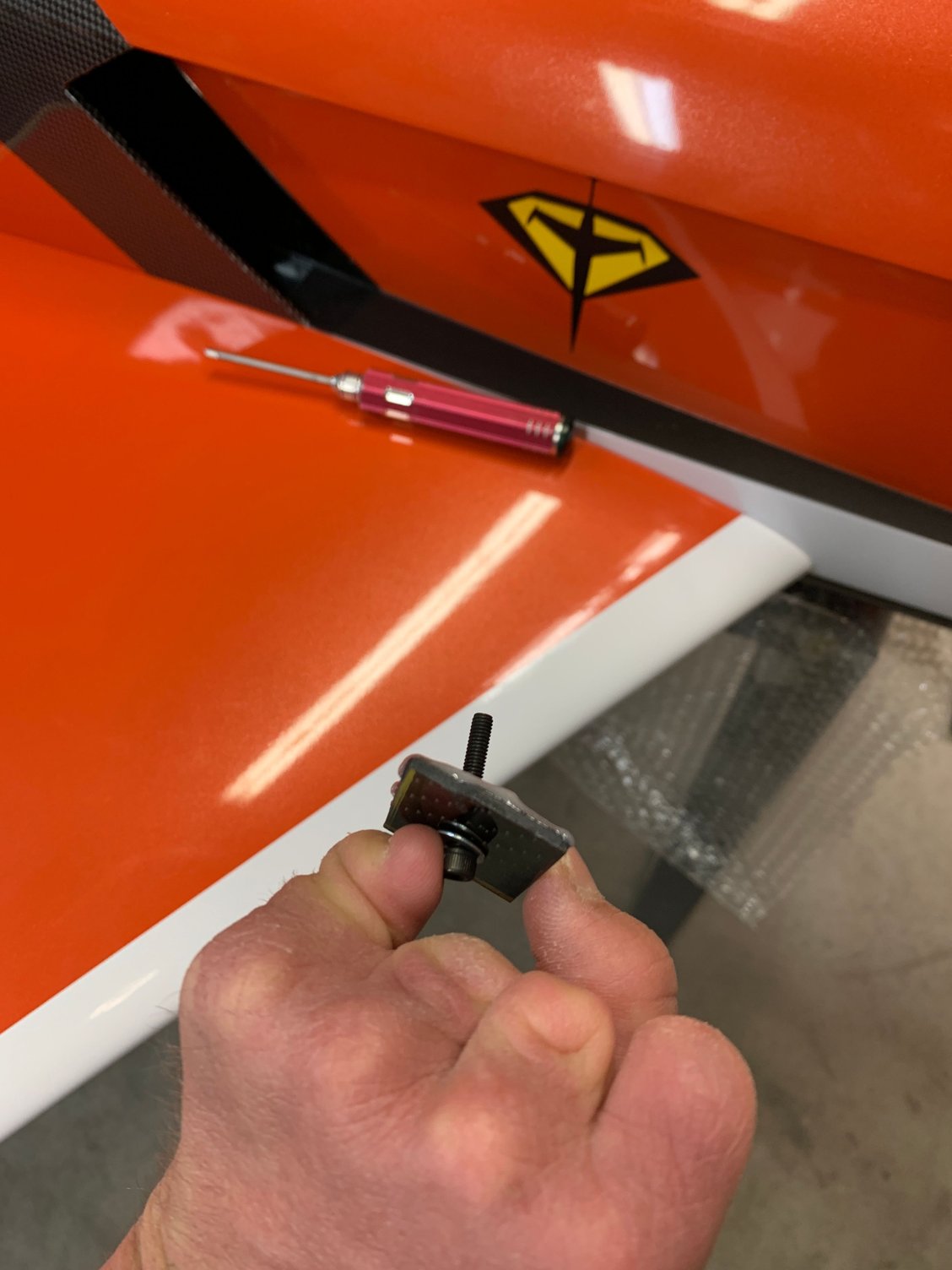

Wasn't happy with the small amount of play at the rear part of the wing. So I added a fixing bolt. Access though the gear opening.
Carbon plate installed on wing side.
Blind nut and 1/4 inch ply installed on interior side of fuse.
Old 12-07-2020, 10:47 AM

Posts: 595
Received 40 Likes on 39 Posts
Good call on the wing bolt, I used this same method on my Rebel and also go through the wheel-well, it is quick, easy, and effective.
Get yourself one of these? I carry one for my Rebel and my Shockwave (they are different size bolts) in my field-box and it makes the job painless.

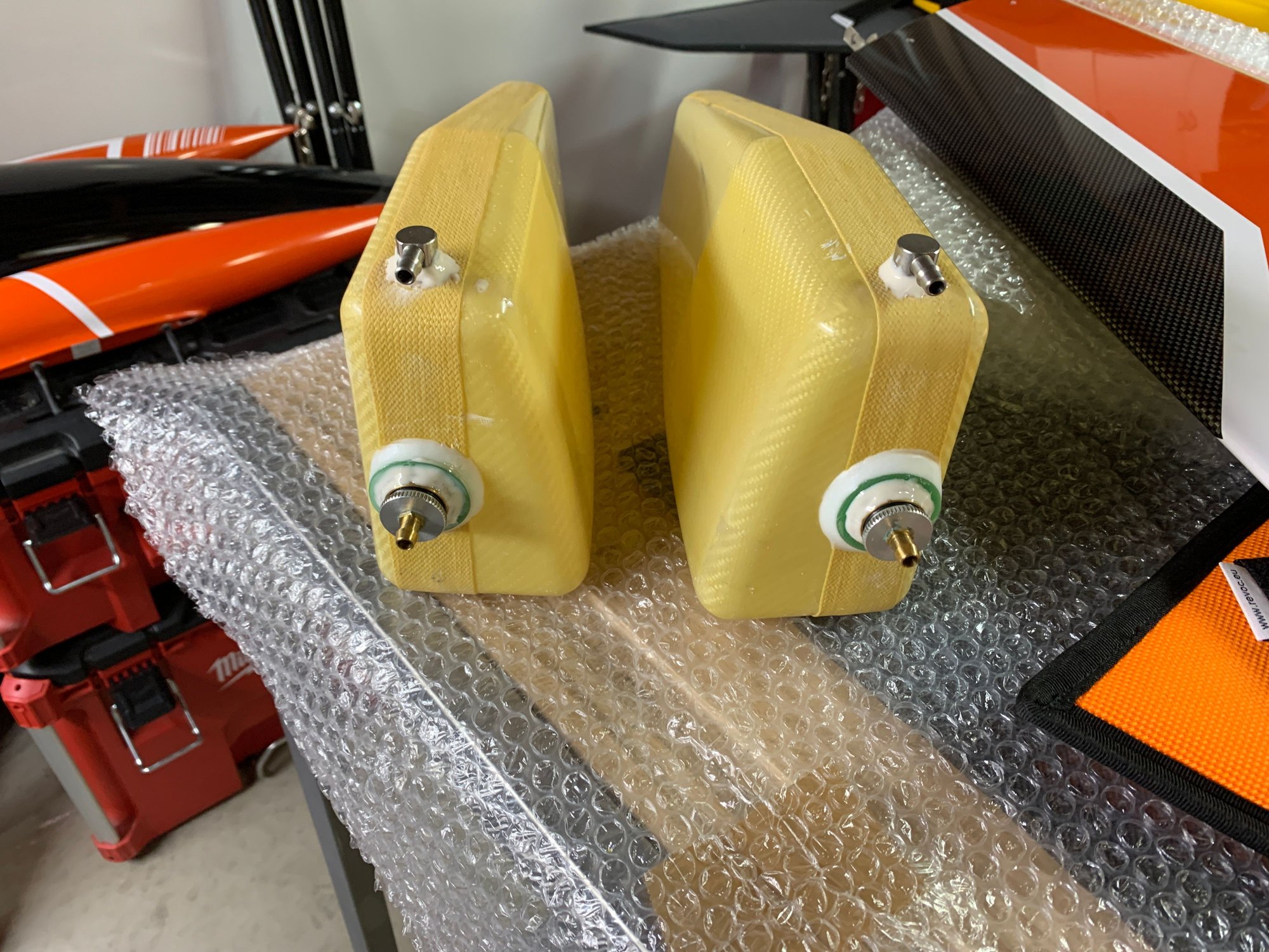

Stock Hardware. Changed to High Flow setup. Because these tanks are run in Parallel the stock hardware should be fine but I planned on changing it from the start.
Stock sintered clunk. Did some testing on this unit and it doesn't really help with pulling liquid if only partially submerged.
Instead of stock clunks, using CARF (Tillison) Felt clunks. Drilled out to a larger size. Stock on bottom and drilled on top. Also using larger mid tubes on the clunk lines.
Finished clunks. In a parallel setup they need to be identical to try to pull fuel equally.
Old 12-10-2020, 07:57 AM
  #73
Canadian Man
Canadian Man's Avatar
Join Date: Aug 2008
Location: Calgary, AB, CANADA
Posts: 547
Received 60 Likes on 49 Posts
Prior to clunk installation, cleaned each tank out with 500ml of rubbing alcohol.
Leak testing tanks. You can pressurize with air from your mouth and submerge in water or just pressurize and leave overnight. If they still hill in the morning they are good to go.
Finished fuel cells
