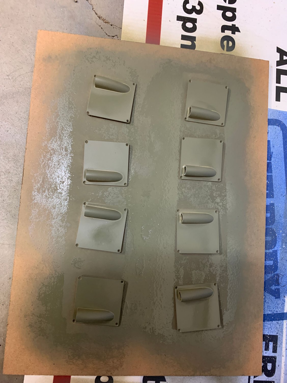

Posts: 570
Received 66 Likes on 53 Posts
Aluminum Servo mounts painted.
- Step 1, Clean.
- Step 2, 1 coat etching primer.
- Step 3, 2nd coat etching primer.
- Step 4, 1 coat paint.
- Step 5, 2nd Coat paint.
- Step 6, 1 coat clear coat.
- Step 7, 2nd coat of clear.
